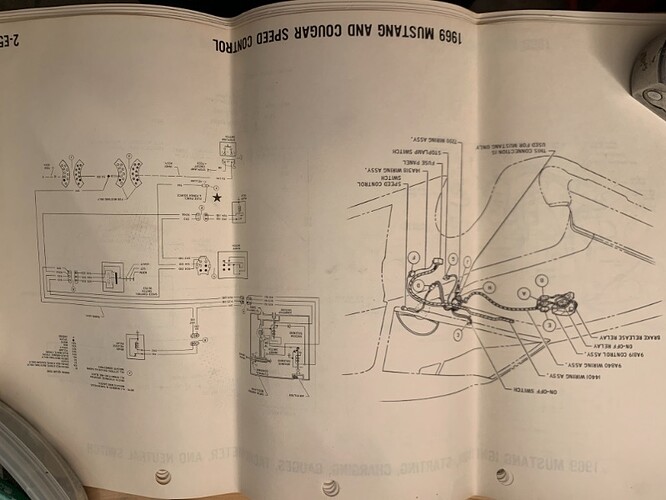

I am new here and trying to figure out my 1969 Cougar speed control. I am working on figuring out what I am looking at and trouble shooting the system. I know it is complete and has not been messed with since my father was the original owner. Here are the pages from my shop manual that I am studying. I am going to get started in the morning. I read the posts on other threads. I did not realize I am 1/253 1969 cougar speed controls. Wish me luck and I can use all the help you guys can supply.

Thank you for the assistance. I just saw that 253 number but basically a rare option that year. I have the complete shop manuals and wiring diagrams. Thanks to my dad the original owner. I followed the shop manual as posted. Looks like I need a new turn signal switch for sure. Says I need a new speed control switch too. It is not holding per the manual??? not sure about the switch? Not sure what is suppose to do? I am trying to figure it out. All help is welcome.
The turn signal switch ( itself ) has nothing to do with the actual speed control in a Mustang or Cougar. The smaller wiring harness for the turn signal stalk ( accel. / resume function with the black button on the end ) joins the main harness under the dash and follows the same route down the column, as does the turn signal switch wiring. That is the only thing they 'share. ’
You can have a fully functional cruise system with a faulty turn signal switch and vice-versa - they operate independently ( except for their physical link ).

I really appreciate all the support on here. Sorry I was not clear in my first post. I was referring to the black button at the end of the turn signal which is the accelerate/resume switch in a perfect circle speed control system. It tests bad. According to shop manual that I provided, the second issue I have is with the speed control switch above the stereo. I have power at the switch but it does not remain in the out(on) position. Like the manual states. Sounds like it is bad. Before I purchase a switch from WCCC I would like to know a if it should physically remain out under power? Is there another way to verify the switch? I will provide a copy of the wiring diagram for the system tomorrow to complete this post. I pulled up a free copy of the suggested bendix manual. Looks like the only shared items are the accelerate/resume switch on the turn signal. Mine is bad. I will test the accelerator pedal bellows and start to ring out the wiring point to point tomorrow. If I could confirm the speed control switch really remains out under power from someone that has a working system that would very helpful.

Here is the electrical drawing for the speed control. I have 5 volumes of the shops manuals if anyone has a tough question and I can look it up for you and post it.
I would like to know a if it should physically remain out under power? Yes the Cougar and Mustang Speed Control switch, when pulled forward to energize the system, should remain in the ‘out’ position - this was the only way to provide a visual cue to the systems ‘on’ status, unlike the Lincoln Mark III ( also Perfect Circle, which had a red illuminated ‘jewel’ next to the on-off switch ) to show you that the Mark III system was ‘armed’.
I pulled up a free copy of the suggested bendix manual. Looks like the only shared items are the accelerate/resume switch on the turn signal. Again, in the Bendix speed control system, all functions were controlled via thumb activated spring loaded, ‘single-pole, double-throw’ style switches on the steering wheel pad. In the Cougar and the Mustang ( Dana Perfect Circle ) those functions were split - the on-off was a dash mounted switch ( the one you are having difficulties with ) and the accelerate-resume-coast feature located at the end of the turn signal stalk ( D1VY-13305-A )
