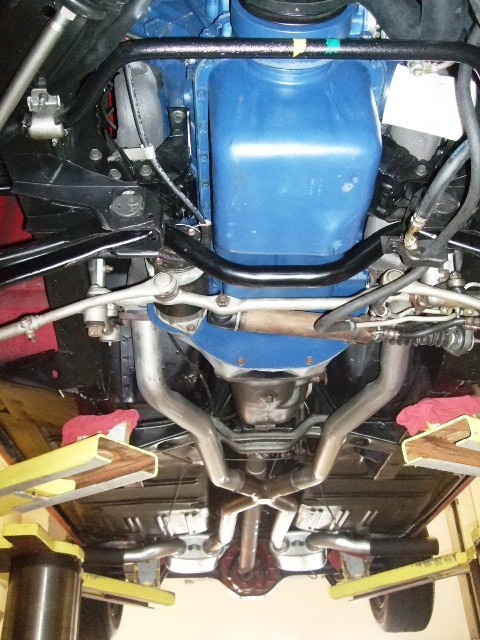

My X pipe system on the Mustang. Boss 302 = higher rpm, so the X pipe is better suited for this motor.
