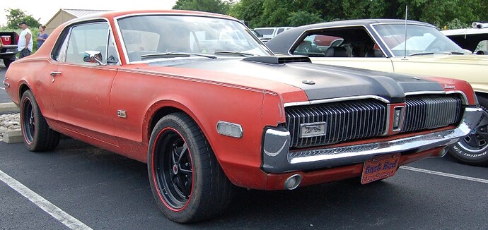

CATS club member Mat Shuman put a shaker on his 68 Cougar. He’s not on this forum. if your on Facebook you can look him up at 'Snot Rod".

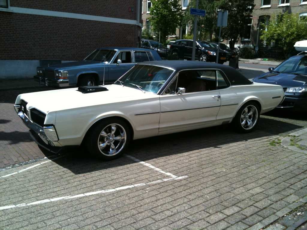

Here is a thread showing a shaker hood scoop on a ‘67 XR7:

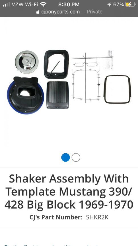

But I’m leaning towards ordering the Scott drake setup from CJ’s it’s got a template and trim ring. It’s fiberglass though… I curious how the template measures up to a cougar hood…

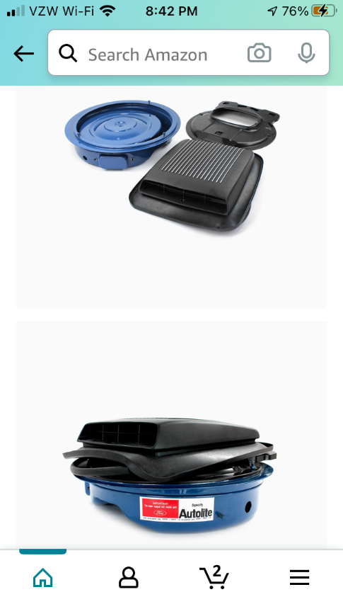

Also There is a aluminum / steel setupfrom pce on Amazon. I don’t know pce.

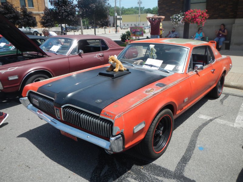

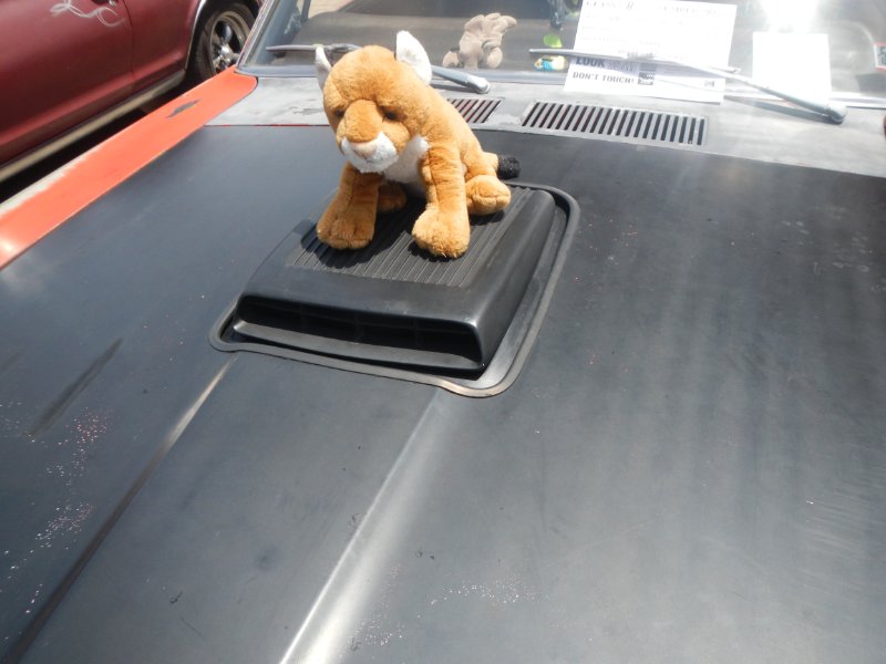

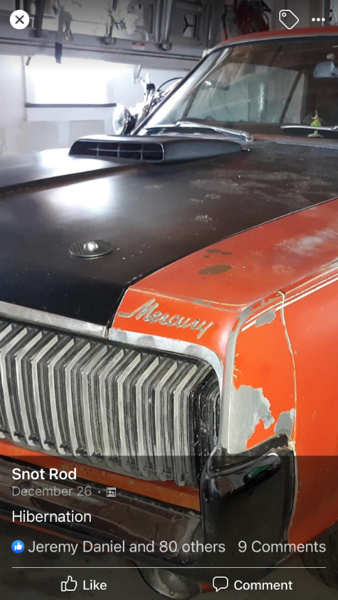

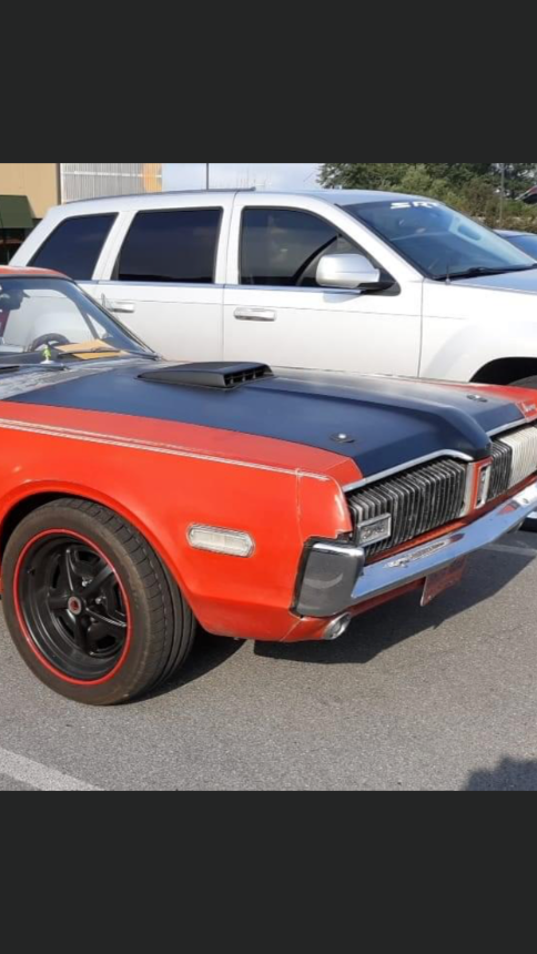

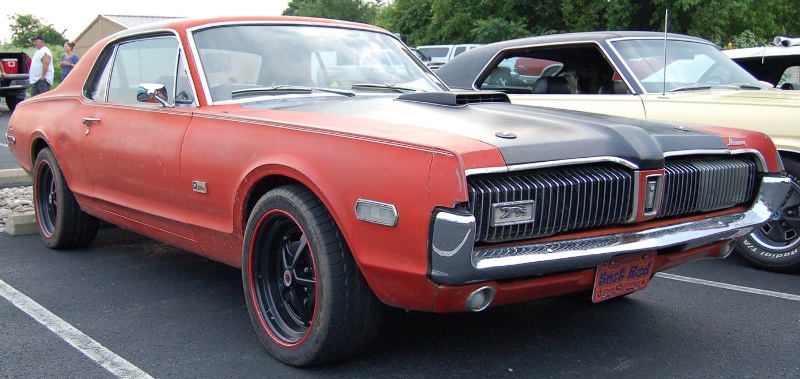

Here are some pictures of Snot Rod. Pretty sure he has a 302 in his Cougar.

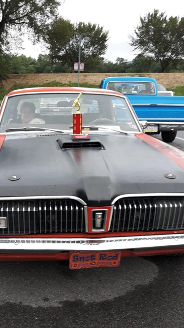

Here’s a pic I took of “Snot Rod” at Carlisle in 2019.

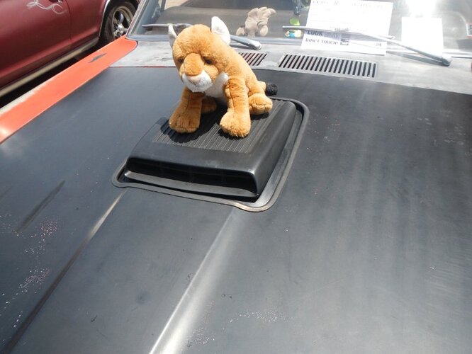

Here are a couple I took at Auburn

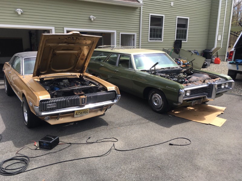

Maybe I’ll get crazy and put a hole in for a hood tack on the 68 pontiac wagon next…:grin:
