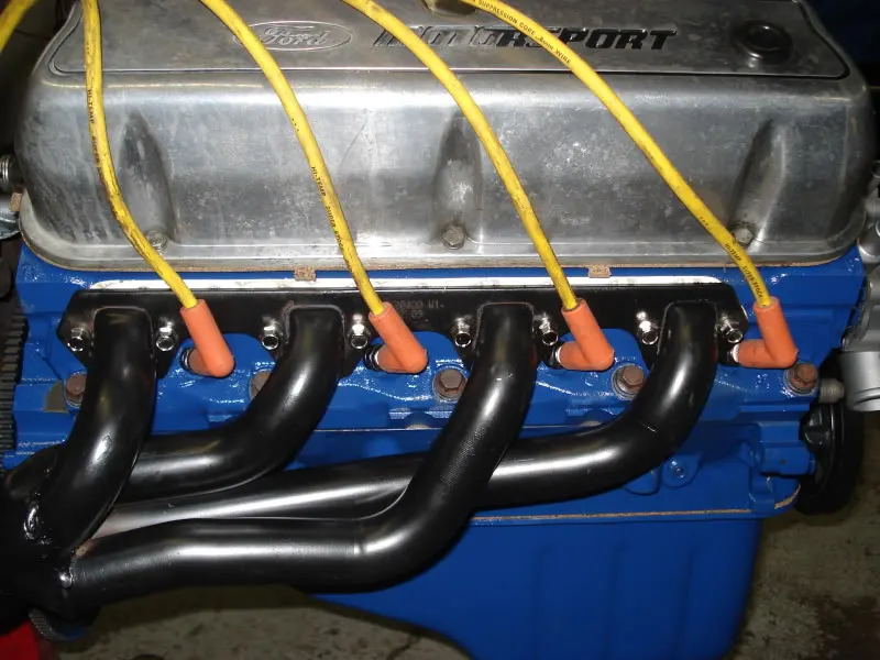

Say, has anyone used the Hedman 88400 or its snootier coated pals?
https://www.stangnet.com/mustang-forums/attachments/dsc02062-jpg.237454/
I’m doing a mostly period build on the '68 302. Want to avoid long tube headers, and hold down costs (hence, repro 289 cast hi-po headers are 2nd, not 1st choice).

I put D669Y Doug’s Headers Tri Y’s on the 69 351W in my 68- they fit well and perform good. Don’t bottom out. Installed with Header Buddies and have been leak free. Saved some bucks on the headers as they were listed as an “open box” item. Install was done with engine in car- just had to lift drivers side to slip header in. I think mid length are maybe an easier install than shorties.
I used the snootier 88408 (I believe, or maybe the 88404, whichever has the thicker flange at the heads and the better coating) on my 68 XR7. I have a 302 with a C-4, A/C, power steering, and power discs. They fit extremely well. I had to remove 2 spark plugs on the drivers side to get them installed. Passenger side slipped right in. I probably could have done it without removing the plugs, but I didn’t feel like fighting it. They went in from underneath and took all of 2 hours to do the complete install. You will have to get a custom H pipe for them since the stock exhaust doesn’t line up with the collectors.

People might jump all over me for saying this, but i bought the el’cheapo Hedmann long tube headers, and the P/S drop bracket and installed them in about 4 hours. I have zero fitment or quality issues with these. I bought them with the crap paint on them, for like 200$ from summit racing. They work fine, sound good, I did however have to spend some time sanding and coating them myself. If you pony up a bit more you can get them ceramic coated too. I have heard horror story after horror story about header fitment on these cars, but I can assure you on my 67 A code 289 i had only one issue. The headers were very close to a tab hanging off the bell housing that was not needed on this model (C4 trans) I trimmed this slightly and other than that had no issues at all. For the money i would go with the longtubes, the Shorty’s are marginally better than a stock set of manifolds. OH and i should add, many people worry about the power steering hoses. I simply tweaked the routing (used a pipe bender on the steel sections of P/S line) and made sure they were tied together and tied to the chassis, away from the header. I went the extra mile and heat taped (that expensive silver crap at the parts store “performance” shelf) the soft sections of hose and i have had no issues in a few thousand miles.
A Lazarus thread! I wanted to report on my cheapo headers (Hedman 88400, steel with black temporary paint) that I bead-blasted, degreased, then BRUSH painted with two coats of a dull silver high temp paint from KBS Coatings. As of 2023-24, they look great, with no warping or paint problems. So it can be done.
Note they do not fit a stock H-pipe…my shop grafted them on.
