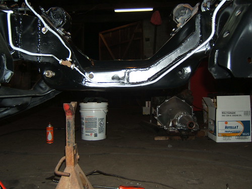

almost ready to set the engine in…

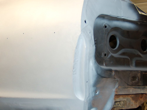

It turns out this car got shoved pretty hard! The Bumper was embedded into the end of the quarter, hard enough that it broke the welds at the bottom of the tail light panel, and pushed the panel forward about 1/2 inch.(No bolts on the outside tail light studs) :sick: remedy: Panel has to move back to remove the crease. The tool I decided to do this with?? A Truck Tire Bead Breaker. …:WARNING!:. If you decide to use one to do this, hit it ONCE, and look at what moved, or this will happen! :doh:
Anyway, after learning how much massage to put to it, 5 or 6 whacks along the edges of the light panel, and a whack on the crease inside the quarter with a Dead-Blow Hammer, produced this:
As you can see, there was filler from a previous crease repair, so,… Remove Filler, a little bit of light massaging with a 3 Lb. Hammer head as a dolly, a 4 oz Ball-pien, a little black rattle can, and partial assembly to show how close I got it and voila! No more bottom of the Quarter Panel!!! :unamused: But at least the crease is Gone! :thumbup:
I will weld the Rear panel seam when I replace the lower Quarter, & Trunk floor extension, as well as work the imperfections out of where the crease was.

Here’s some better pics of what I did yesterday. Took 4 Hrs, including taking it apart the second time.
The other side needs it too, just not as bad :eh:
