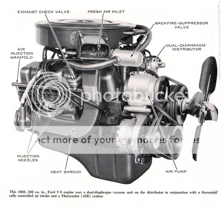

Does anyone have a proper picture of an unmolested thermactor 1968 302, from the driver’s side??? I have searched the Google over, and came up with no more than two pictures of the RH passenger side, and one of them is a Ford “drawing” and didn’t quite make it into production as implemented.
I’m trying to figure out what the little bracket looks like that extends the plug wire separator out a bit, used on the LH side (driver side), to keep the wires off of the hot thermactor tubes. I have a RH bracket which does match the one picture I found, but I cannot seem to find a proper picture of a LH bracket!!!
Can anyone help here? These were only used on manual trans cars, primarily CA cars…but I’m sure they ended up in other states… and many were removed and discarded… I just need to know what one looks like!

Here’s Part 8-3, Fig. 15 – 289 and 302 V-8 Engine with Thermactor Exhaust System:
