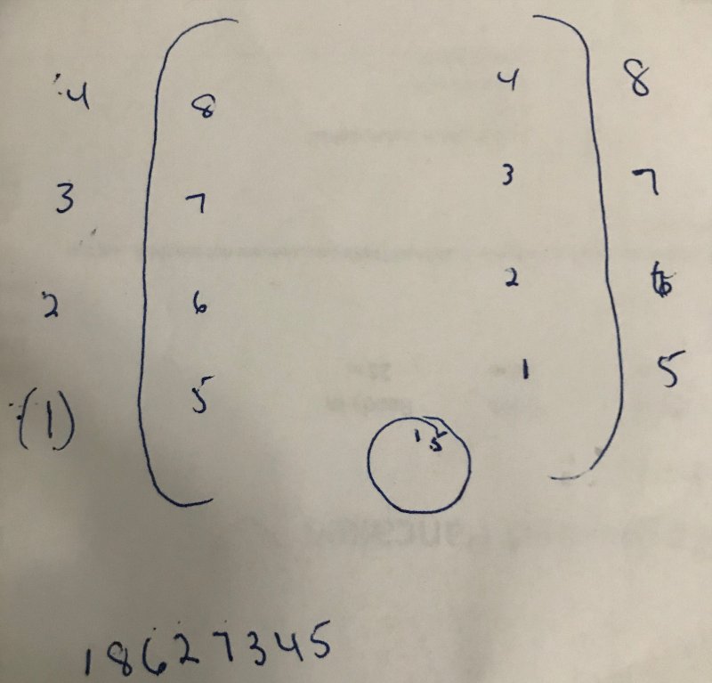

ok, so i didn’t find a vacuum leak but as i was changing plugs, points, cap and wires, i found the firing order is completely out of whack.it appears to be 54263781. i tried to change it to 15426378 and the car would not start. i do not know if anything has been done to the engine and this seems pretty unusual. the attached picture is the firing sequence based on the plug wires to the distributor. the numbers inside the engine is the current cylinder order based on the wires connected to the distributor. the numbers outside the engine are what they are supposed to be. the numbers bottom left is the firing order on the distributor based on the cylinder numbers inside the engine (18627345) or 54263781 based on the real cylinder numbers. i know this seems like it can’t be but it is what it is. the car starts and runs but a little rough when at temperature. i assume the distributor may have been changed and was not put in correctly, maybe?
I’m rusty on my 302 stuff, but … http://www.gtsparkplugs.com/firing-order-ford-260-289-302.html
Going the wrong way 'round the distributor can cause some issues (been there done that one late night). Also be sure you have #1 located properly … the ones on the outside look right, which I think is what you’re saying. Looks like going the wrong way would get you : 18736245.
Obviously a good start would be to put #1 on the compression stroke, set the balancer on 0 or so and check where the rotor is pointing.
So, I just realized the sequence I posted, 54263781 is just 1 off the actual sequence of 15426378. Previous owner must have set the distributor and timing on the wrong cylinder. I’ll reset and see what happens

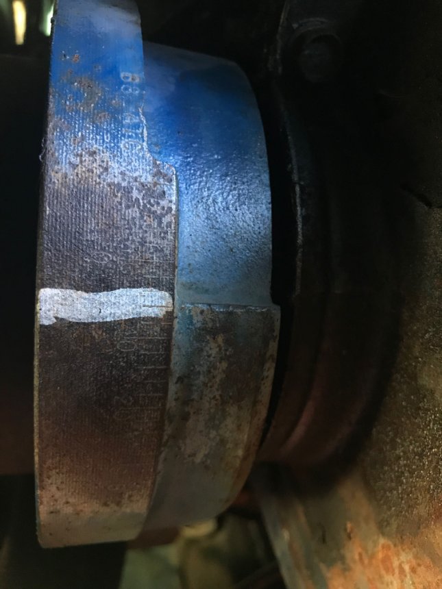

ok, i set the #1 cylinder to tdc and checked the timing mark as being 0 (picture just shows timing marks. white mark is 6 degrees) i pulled the distributor and reset it to point to the #1 plug on the cap. i plugged in all the plug wires in order 15426378 counterclockwise. now the car does not start. i’m confused.
ok, so i had #1 at tdc but not on the compression stroke. reset #1, reset distributor and now it runs. still have to put a timing gun on it but it is straight and does not have the rough and sputtering issues. thanks to everyone for the suggestions.
