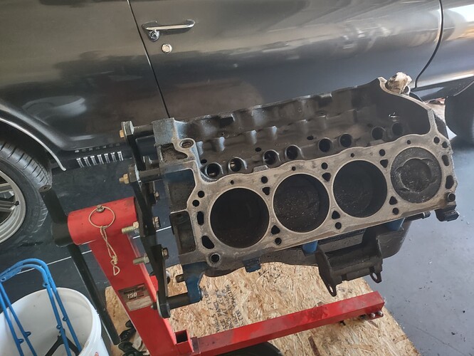

Photo of the block is prior to rebuild. The daggum rings came out in pieces and a scarred 8 cylinder. Jeechitx.

I would avoid the pursuit of 4 bolt mains. Even on the legendary Boss itself, there’s no agreement whether the extra bolt holes were a detriment to reliability instead of an improvement!
If you intend to build a high RPM screamer (9k, etc) with 500, 600, or more horsepower that you intend to abuse regularly, instead, get an aftermarket block. It is both possible and common to get an early block to handle big RPMs with enough prep and attention to detail, but it will never be as reliable or cheap, and it seems a tragedy to deprive some concours restoration.
