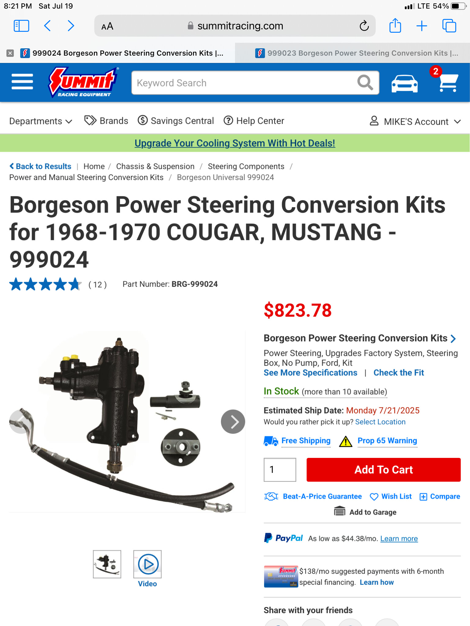

These Borgeson’s look nice, but I’ve viewed installation videos for the Borgeson, and it’s more involved than this shop I’m using can handle. I’ve got to keep this as simple as possible until I’m clear of this shop, who’s still on the hook for my steering and suspension.
I guess for now I should get a rebuilt SMB-K Steering gear box and consider the Borgeson down the road when I’m considering other resto-mod type improvements.
