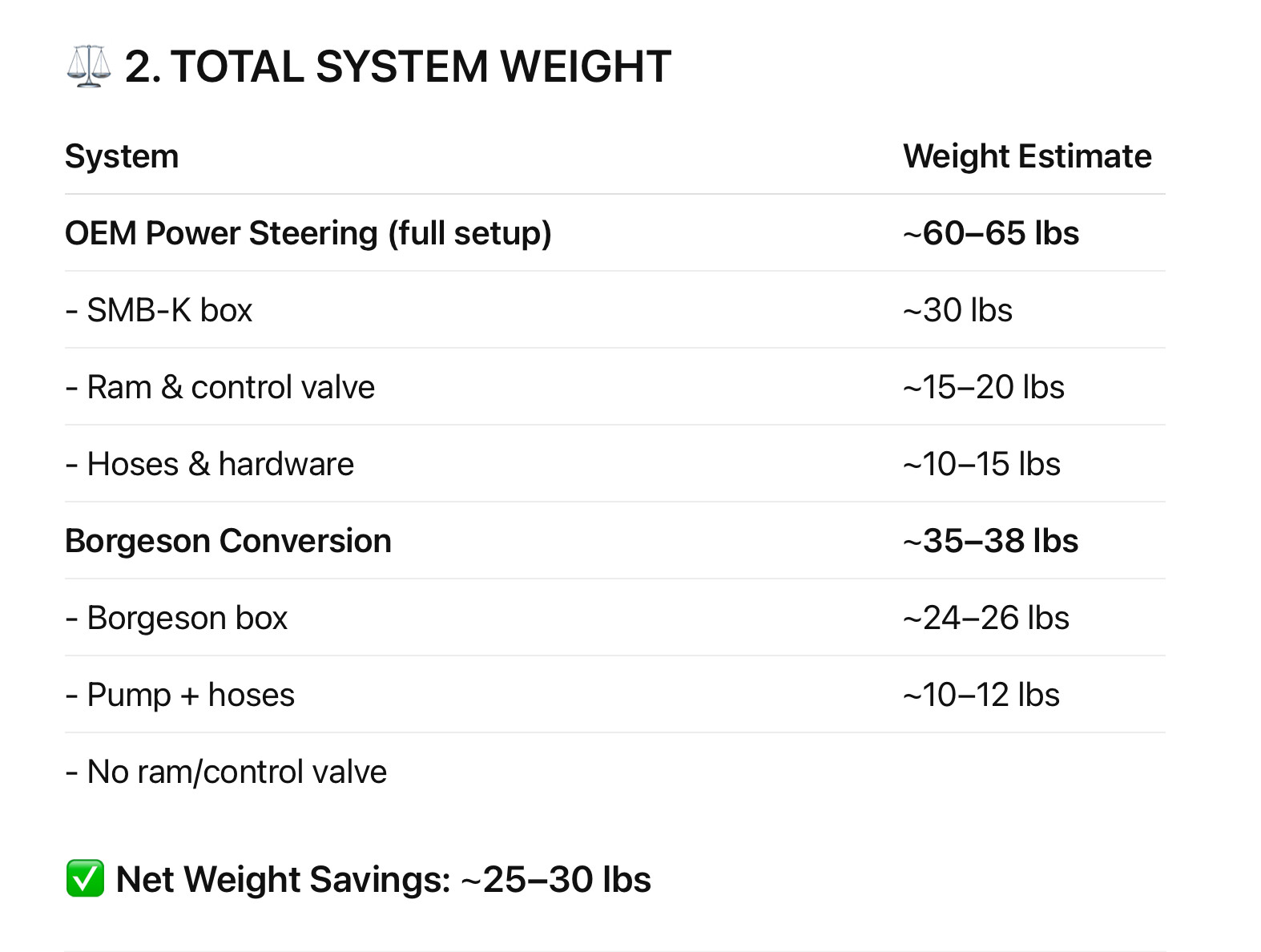

I checked with ChatGPT if the Borgeson conversions were lighter.
The steering box is around 5 lbs lighter, but the big weight savings is the 15-20 lbs from eliminating the ram & control valve, for total weight savings of 25-30 lbs.
Aside from the steering, that’s a significant weight savings benefit.
