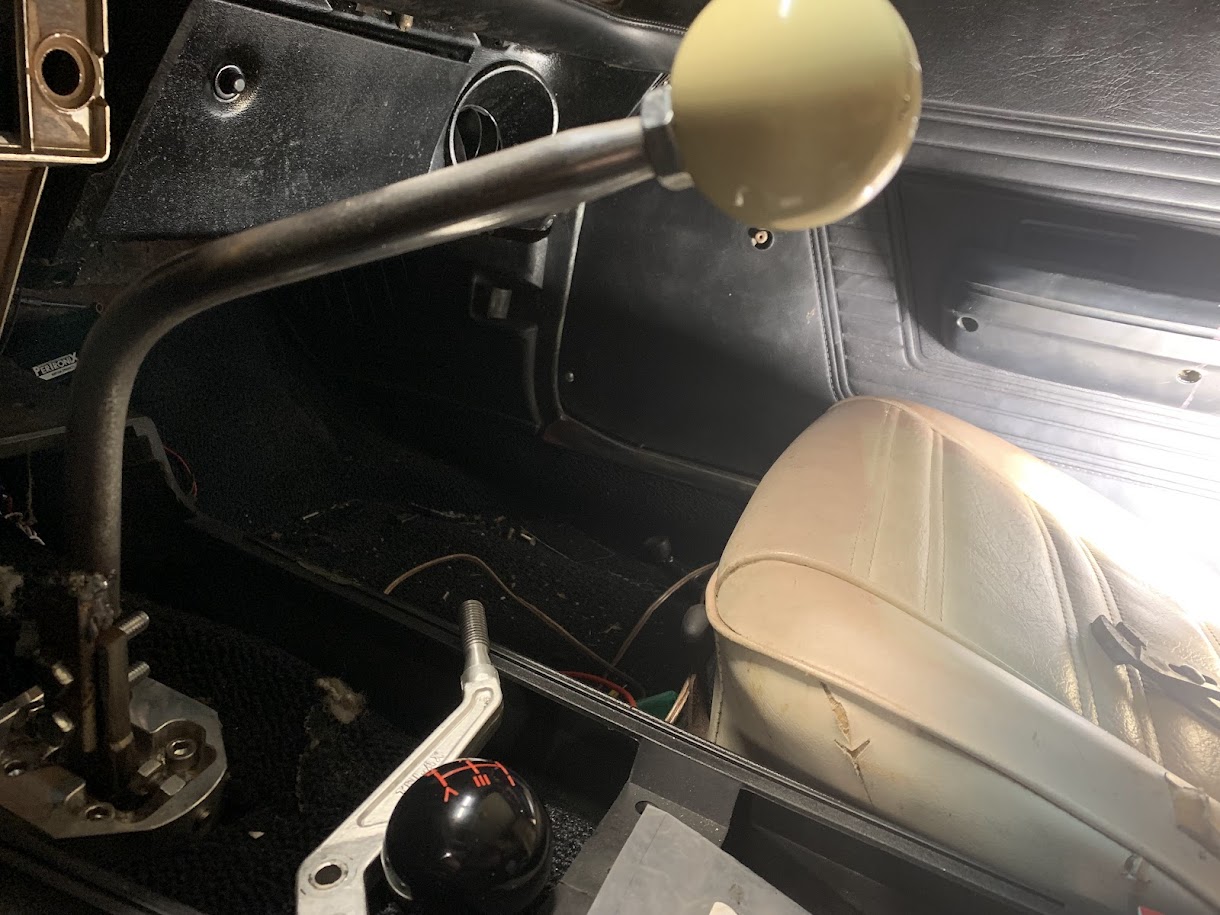

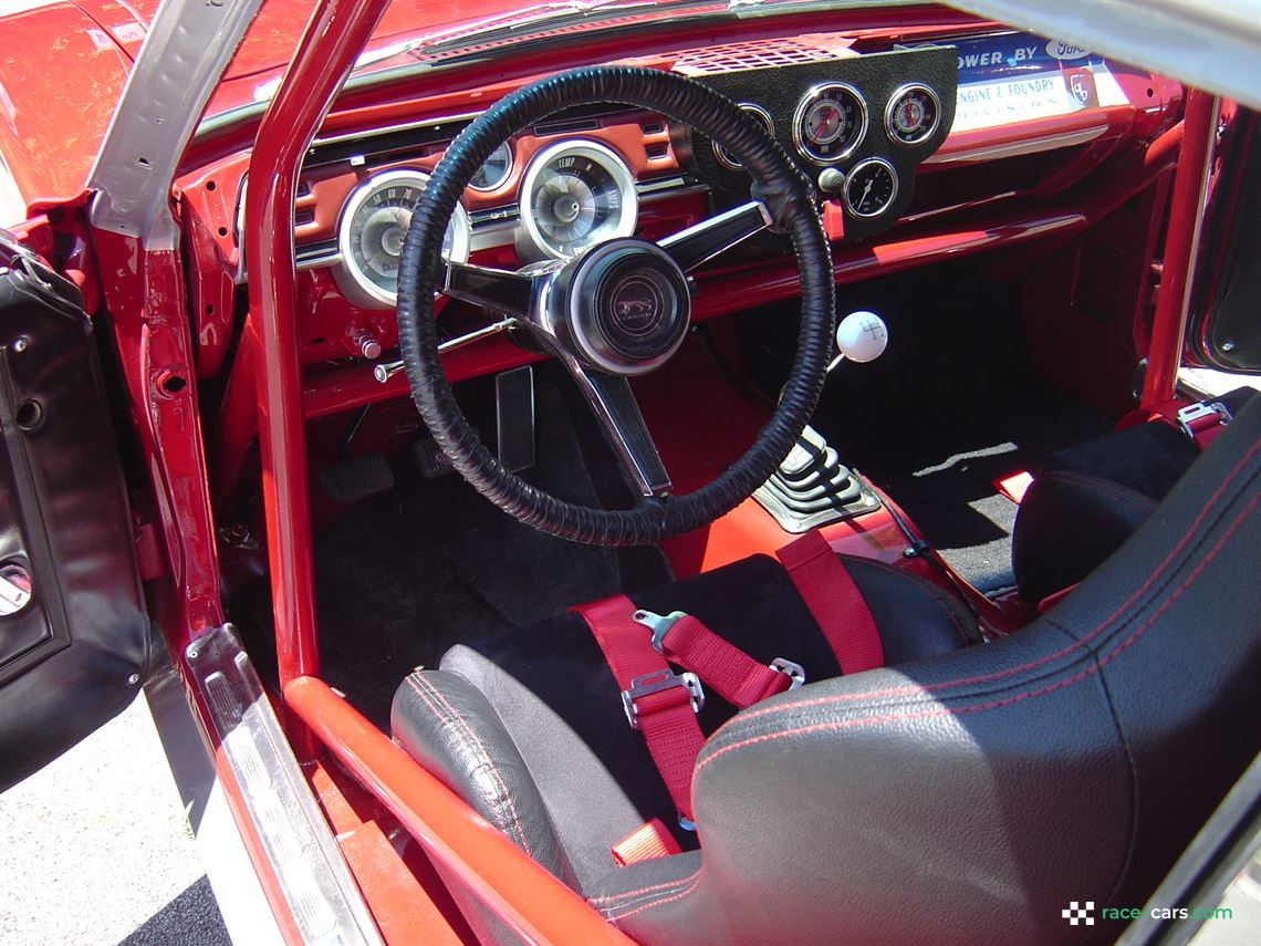

I did a T5 swap in my 70 and installed a tri-ax shifter with a pretty stubby shift lever. I wanted a shifter that both looked period and had the correct reach to the driver position since I don’t have monkey arms. I bought a stock equipment 3 speed shift lever and cut the bottom interface mechanism off, welded a tab on, drilled two holes, and voila- stock looking shifter. The chrome has a lot of wear on it since it makes a fantastic hand rest in the original high gear position and now in fourth, but it fits the original aesthetic of the car much better than the Tri-Ax shift lever or most of the forged alu levers available.
Also an added benefit is clear and unobstructed access to the hvac controls, radio, and sight line for the gauges I put in place of the ashtray. So, it allows all the same intended access as the stock setup but with a t5 down below. Since the lever is round, it also works with the reproduction shift boots. I kept the stock 3 speed knob on it for a couple of years and recently replaced it with an ivory ball better sized for my meathooks.
You can do this with any of the modern transmissions using a top-shift two bolt lever like TKO, TKX, T45, etc.

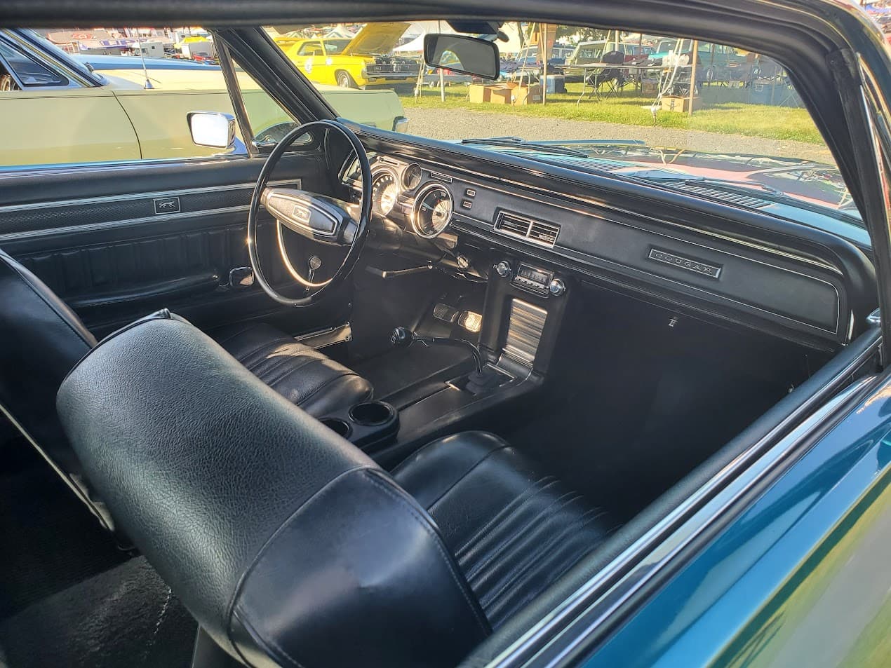

I used a chrome plated Hurst lever with stainless steel knob on my TKO600 but I have monkey arms!

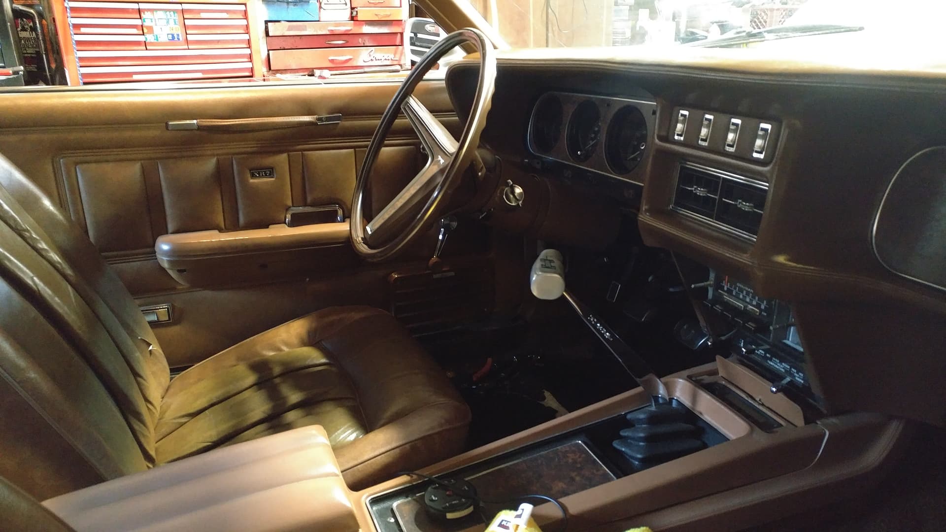

This is what I have on the T-5 in my 70 XR-7. It looks close to factory. I could spend a few hundred for a 70 T-handle with the set screw, But I like this well enough. I got the handle through Modern Driveline out of Idaho.

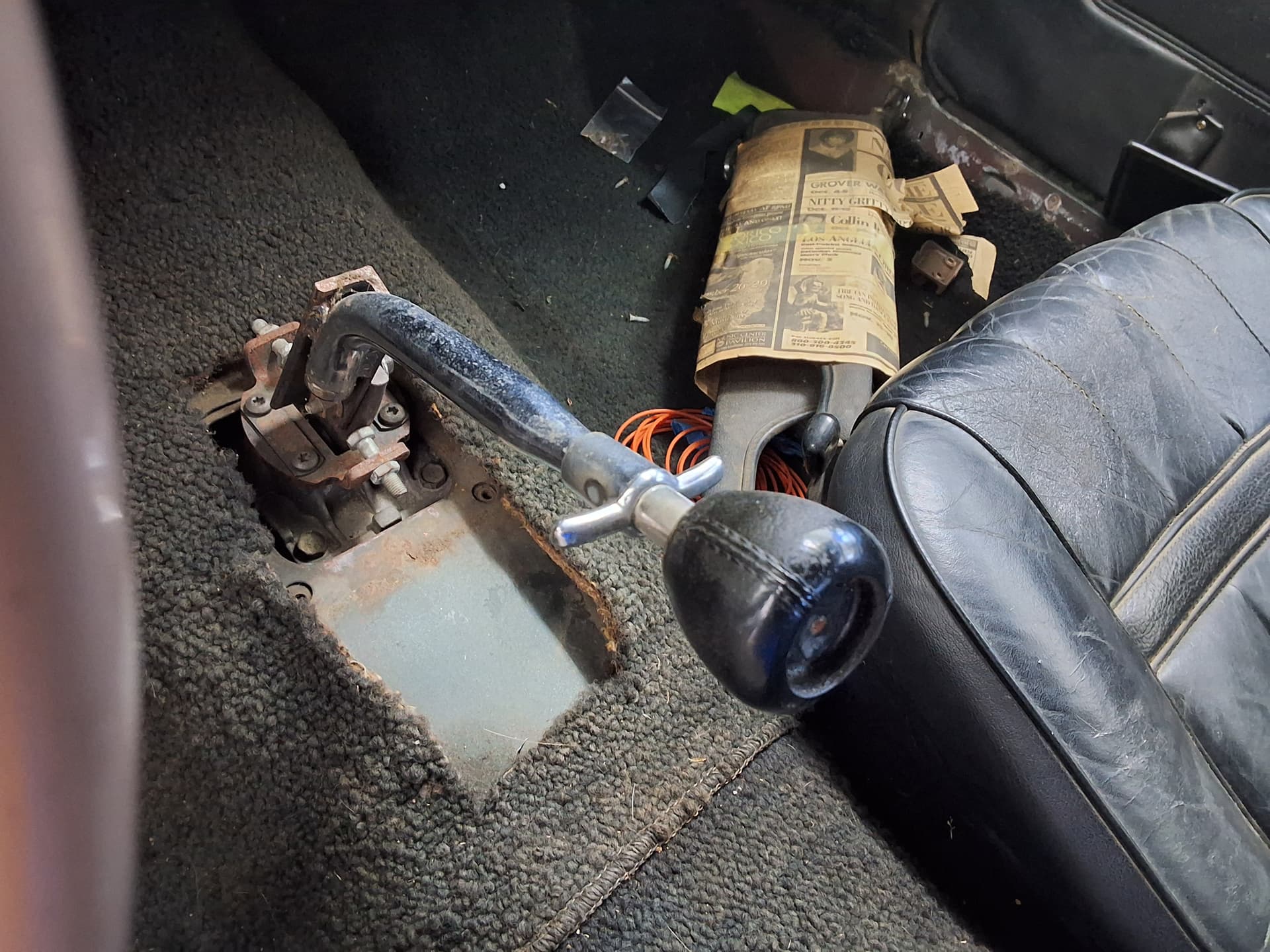

I have this one from California Pony Cars on my 68 with a T5:
Looks like they make a 69 version but the 70 4-speed would have had a Hurst lever with a T-handle from the factory. Depends on how period correct you want to look.

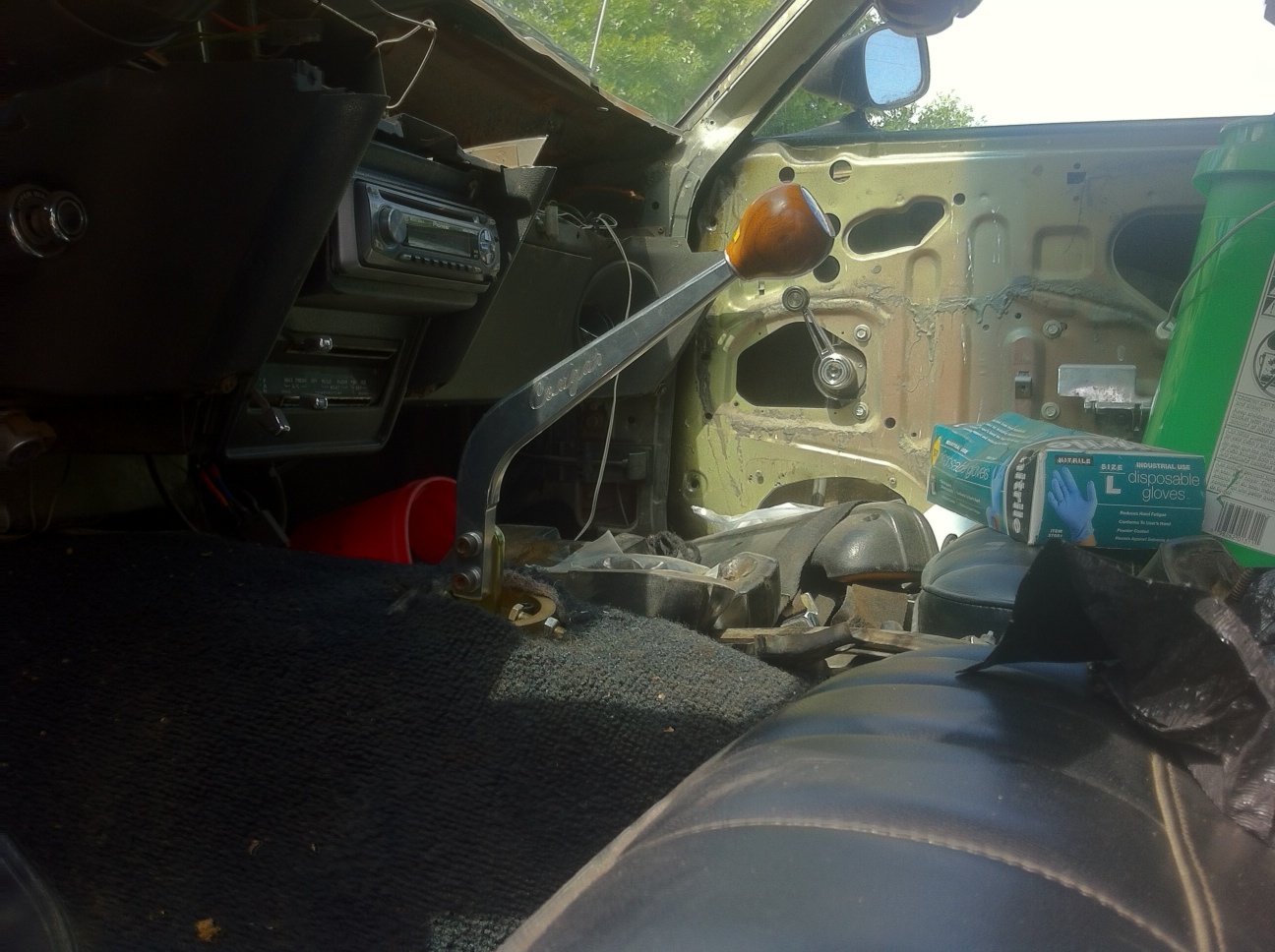

I came up with this shift lever for my T5 conversion. It was an automatic shift lever for some 1980’s GM car. 1968 XR7 with a quasi 1967ish 4 speed shifter.

The t-handle works for a lot of people. Since I did the Bud Moore rally car scheme to mine, as in “what if Cougar had participated in the very successful for Ford 1969/70 rally season?”, I stuck with the Bud Moore ball shifter aesthetic. I also like the ball better than the t-handle for whatever reason. But the t-handle is classic period performance aesthetic.
I hate to be a matchy matchy weirdo, but it’s a lot of fun to do the “barn find rally car” thing. The kids really enjoy it.
