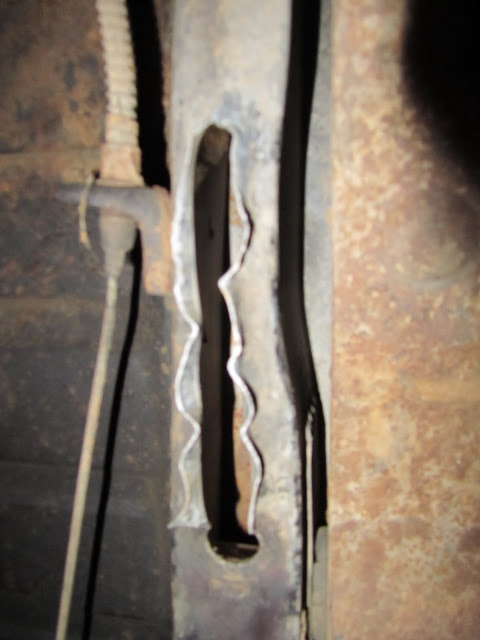

The transporter who hauled my car from my parents house to my house thought the drain holes in the rear frame rails would be a great place to attach the tie downs.
I hammered tear closed and welded it up. Thankfully, the Maier sub frame connectors attached to the frame rail on both sides of the repair.

Ouch! those rear frame rails look painful. I use the factory tie downs when I have to trailer a Cougar. They were supposed to be removed by the selling dealer, but most were left in place. If yours are gone, you can pick up a set for cheap since they were so common.
My factory tie downs are still there in place. I don’t know what that guy was thinking.

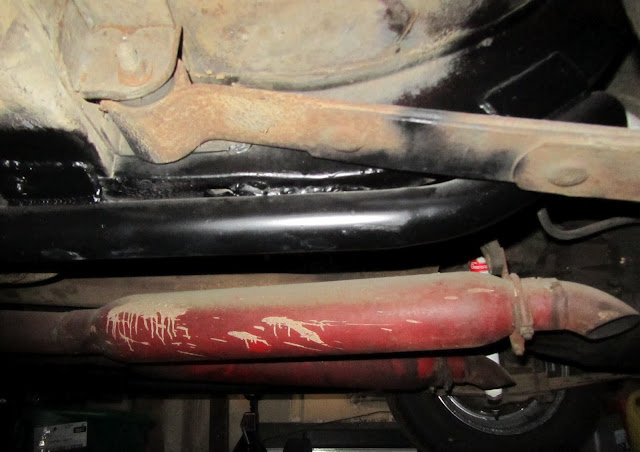

Wow been a while since i seen some glass packs. Cherry bombs? Do people still use them today with so many kinds of mufflers available today?
The glasspacks are from Thrush. I installed them in 1998. My Dad and I just welded up two 4’ lengths of 2 1/2" straight pipe with no H-pipe. As you can imagine, they were loud. They got me a lot of the wrong kind of attention. I’d have to say the people who hated them the most were the guys working the drive through windows. In my defense, I was only 18.
I’m going to quiet my Cougar down a bit by installing a pair of Magnaflow mufflers and a no-muffler kit from Pypes (and maybe some cut outs). From the tests I have seen, they seem to be the best compromise between noise and flow.

BTW, the brown spots on the glasspacks (and the rocker panels) came from driving through a puddle of house paint. I didn’t know they made high temperature house paint. ![]()
I’m sure United wouldn’t mind if one of my carry-ons was a Mustang II front suspension kit.
Yep, those are Cherry Bombs… made by Thrush.
Cheap tightwads use them still…ask me how I know…LOL. Put Magnaflow packs on mine, since the price of two of them was less than one “normal” muffler…
When they wear out, I’ll spring for something different. At the time, I was just trying to stop the bleeding! ![]()
