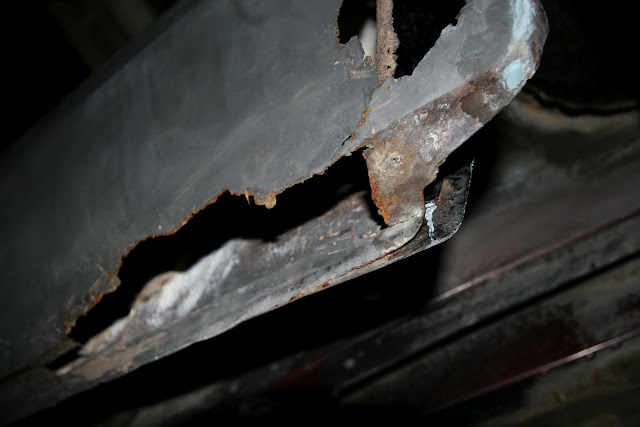

And now for the rust…
When I picked up the car, that side of the trunk was filled with pine needles, leaves and other junk. The hole was only about the size of a dime before I started poking and grinding.
Here’s the patch panel I plan on using. The contour isn’t perfect, but this C code isn’t going to spend too much time parked at the fairgrounds.
I still need to get a trunk drop off and a wheel well patch.
