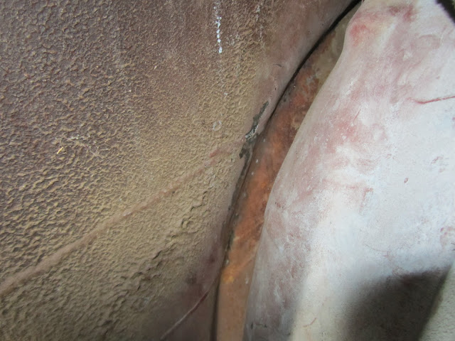

Thanks, Todd. It’s pretty hard to get behind it, but I’m going to try to find something to use as a dolly to get that edge a little sharper.
I want a friggin’ dent puller now. :dammit:
Adam, work the back edge from inside. Do ya have a large screw driver or cold chisel? Pull the tire and work that dent with a hammer and cold chisel or =. Go slow and work from the deepest part of the dent out.
You can borrow my stud welder any time. Just drop on by.
I can’t access the wheel arch from the wheel well. I can only get to it from the inside.
Ahhhh… my apologies Adam! I thought you were talking about the inside of the wheel well lip. I thought maybe the lip was crushed up/in. You know, kinda like Elvis. Didnt realize exactly where you were working. Any vocational schools near by? Anyone with a body pick? Any chance you could MAKE a body pick?
http://www.tptools.com/pl/Images,MT-PICKS_L,170,1825_Martin-Auto-Body-Picks.html
You could probably make something similar to that with a meat hook.
