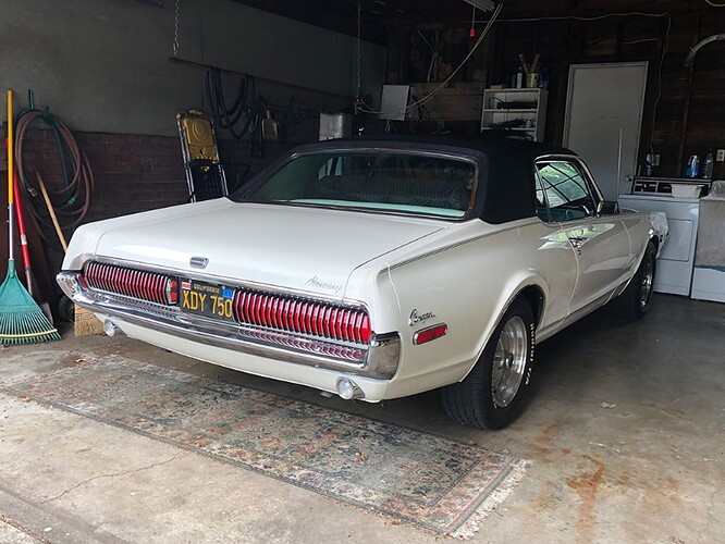

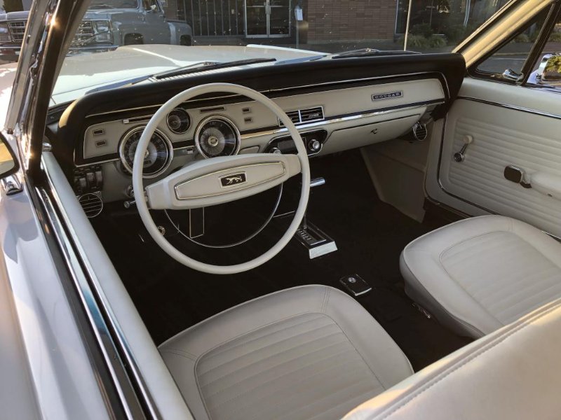

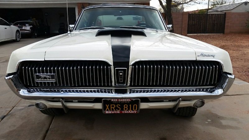

Yup, good call on the new wheels.
Nice photos. Does this car have rear side marker lights and quarter panel script/emblems?
Yeah, I just took them off temporarily because the paint is getting worked over this week. Final wet sand / polish type of thing.
Glad you stuck with those wheels, I really like them and gives that personal touch on your car. If I planned to run a smaller wheel those would be on my list. You can always keep those stock ones on the shelf just Incase you ever wanted to go back.
Dig those photos, beautiful area country for sure, far different then we are used to here in the desert.
Lookin’ good Andrew, I know it’s been a long road for you & the car. I hope you can fully enjoy it now (they are never truly “done”).
Long road indeed! The road continues…

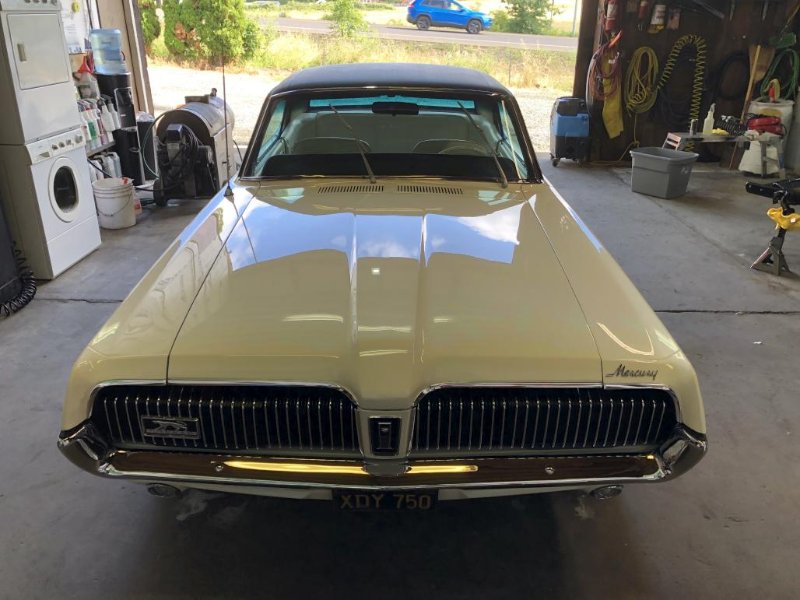

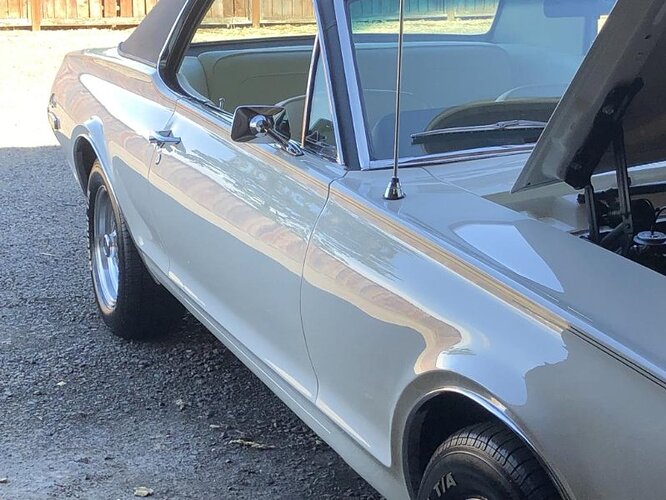

So as I mentioned before, I took the car to a pro detailer who went over much of the paint with some 3000 grit and buffed it out. It came out very nice. Kinda hard to appreciate in pics but here ya go anyway.

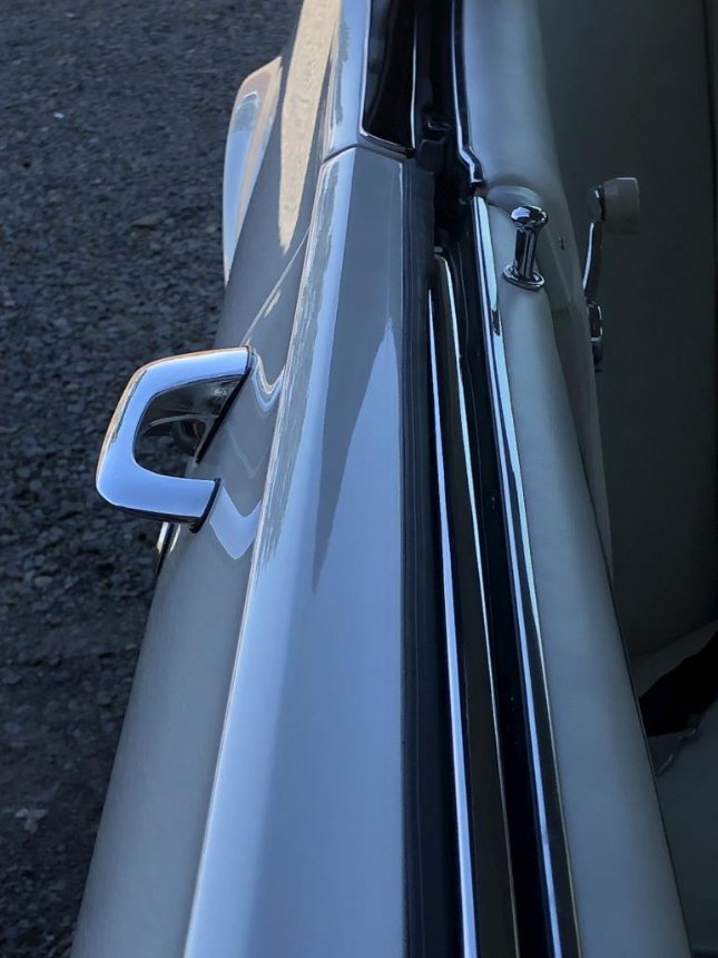

One of the worst problem areas that I highlighted before was the top of the doors. These areas are much much better now. It was hard to get a pic but this kinda shows how smooth these areas are now.

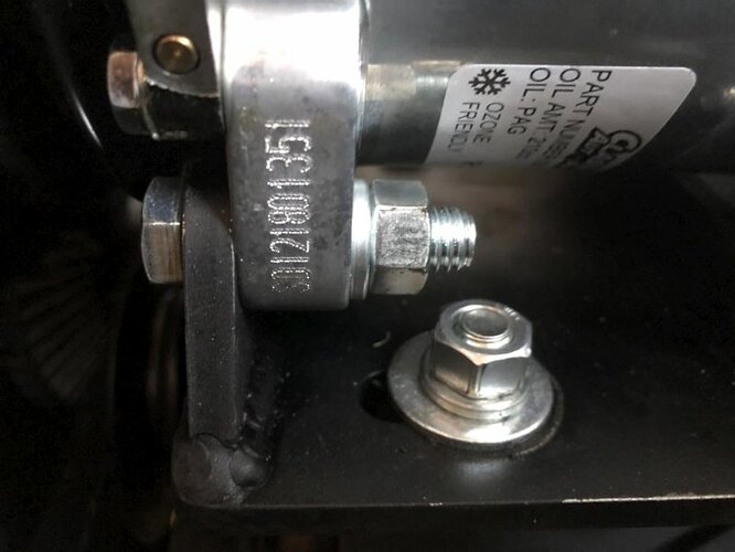

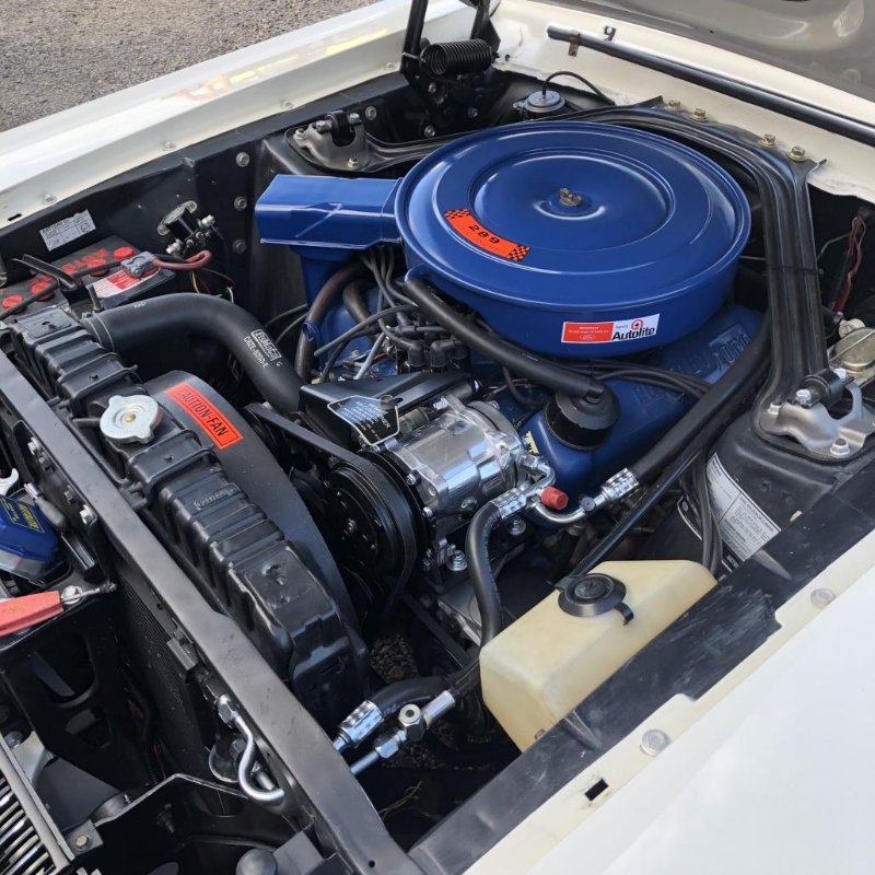

My next project I wanted to tackle was the A/C. I had the under dash stuff in place (original evaporator) and I had a new condeser and drier in place, so I just needed to figure out the compressor and hoses. I got to looking at my original Tecumseh compressor and it looked ok, seemed to spin fine, but given its age I really had no idea what kind of condition it was in internally. My original hoses were all looking pretty crackly and dry rotted. So… given that the cost to replace the factory hoses and service the old compressor would be similar or higher, I decided to go for the modern upgrade to r134 and the more efficient Sanden compressor. I got this kit from Original Air Group (which is a division of Classic Auto Air). As much as I like originality, I wanted the A/C to be functional, serviceable, and efficient, and this seems to be the best way to achieve that. It’s all reversible too.
Installing the kit wasn’t bad, but it wasn’t all rosy either. For one thing, a lot of the nuts and bolts almost conflict with each other, and it’s hard to get tools in there to tighten them.

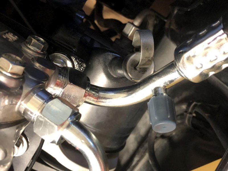

For another, the discharge hose they supplied is too long. I ended up having to zip tie it to the sight glass hose (sold separately) in order to get it to route reasonably.

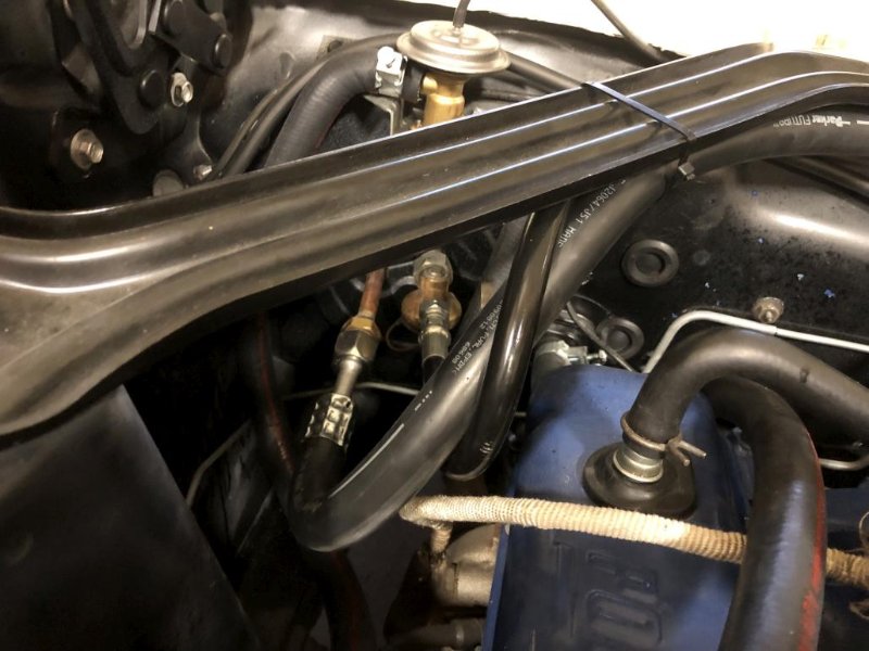

For another, the suction hose gets in the way of the power steering pump dipstick / filler tube. I had to angle this hose up enough to just barely allow the dipstick to be removed.
Here’s how it turned out on the other end, this’ll work fine.
At the end of the day, it doesn’t look too bad. And I had to put on the compressor tag just for giggles, even though it doesn’t apply anymore.
I didn’t use their drier since I had a new one already, which has been sealed from the element all this time. It turns out they sent me the wrong drier anyway. But as a final touch, I slapped on this decal to make it look original-ish.
After everything was hooked up, I went to get the system evacuated and charged. I gotta say… it sure is nice having cold A/C in an old classic car! Driving it home after picking it up, it was still very warm out, and it felt so luxurious to have the windows up, and cold air blowing out of the vents. I’m also impressed with my factory blower fan, it’s strong and quiet.
So, overall I’m happy with the functionality of the kit. The fitment issues are a little annoying but everything works as it should. More to come!

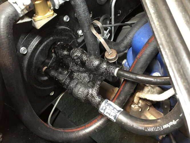

BTW - I did put the proper cork tape over the evaporator lines.

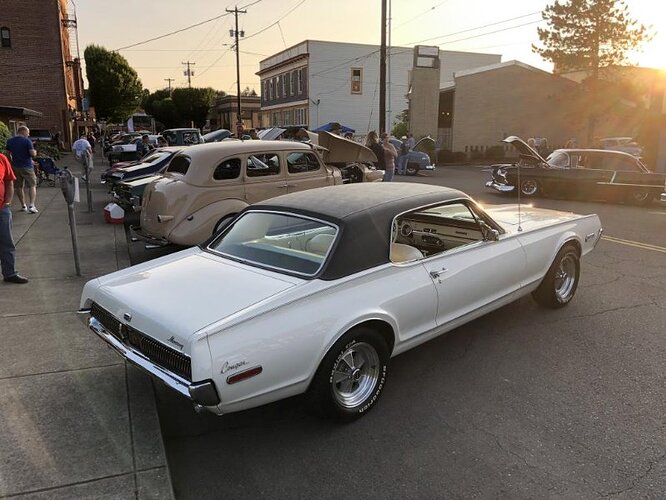

On a more fun note, I participated in my first car show of sorts since doing the resto. First Friday in Silverton, OR,
I even ran into a couple of familiar faces…

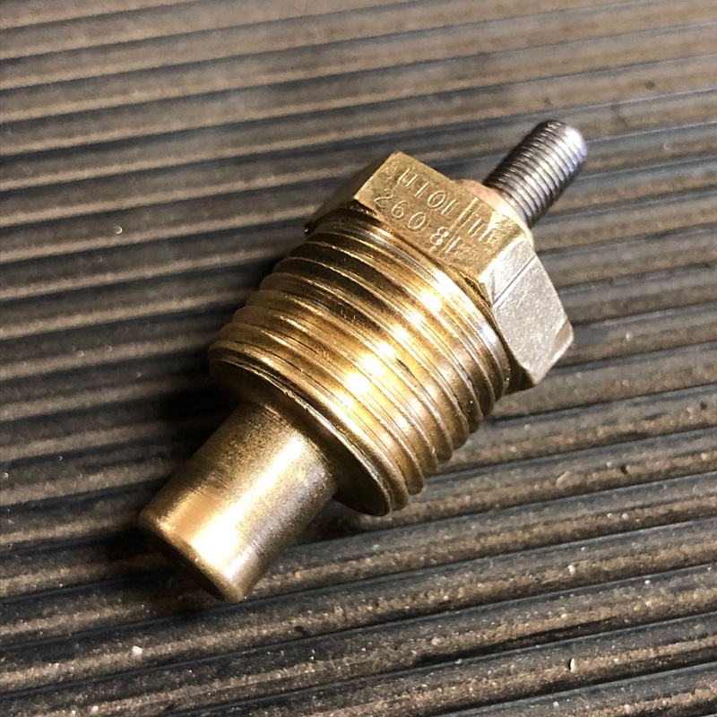

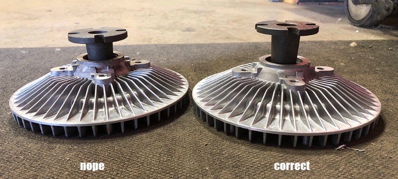

The cooling issue was a combination of things. For one, I was informed by members here that the aftermarket temperature sending units don’t read accurately, so it was reading hotter than it should have (verified with a laser thermometer). So I scrounged around in the WCCC junkyard and found an original Autolite sender. Now the gauge reads much more accurately.

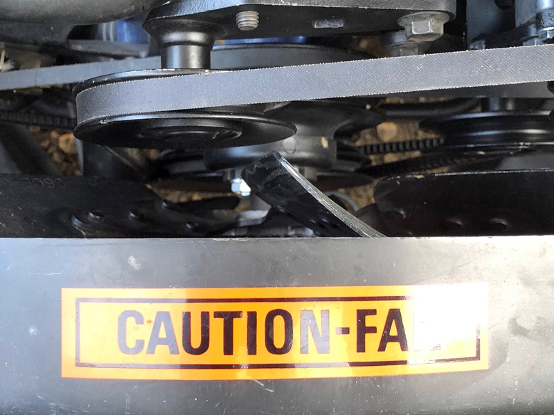

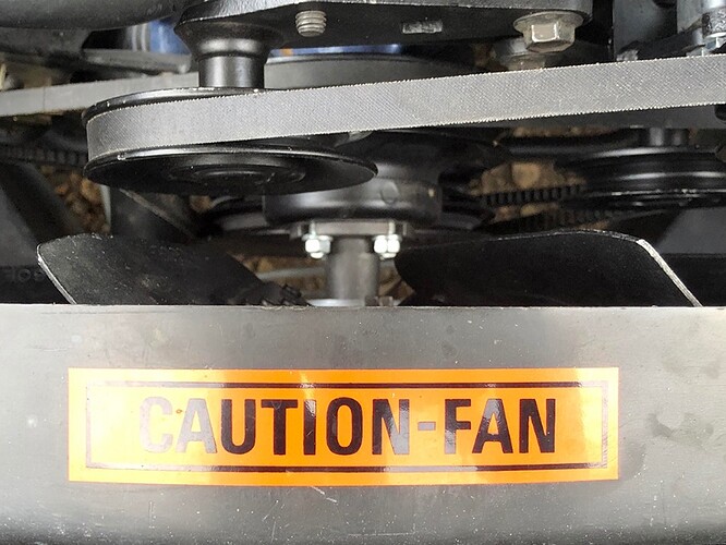

Secondly, I had the wrong fan clutch. For some reason, WCCC was carrying the wrong one at the time. This has since been remedied (link to fan clutch). As shown in the pic below, the one I had was too short and didn’t place the fan far enough into the shroud.
Here are before and after pictures. It’s a little hard to tell the difference because the fan is in a different position, but you can kinda get an idea.

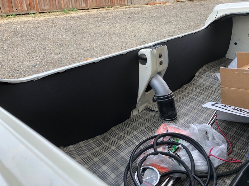

Finally, one of the last loose ends was to install the taillight protectors in the trunk. The repros are a good snug fit. I didn’t end up using screws to affix them, they fit firmly enough in place on their own.
