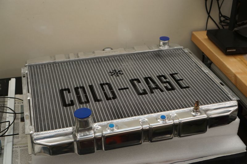

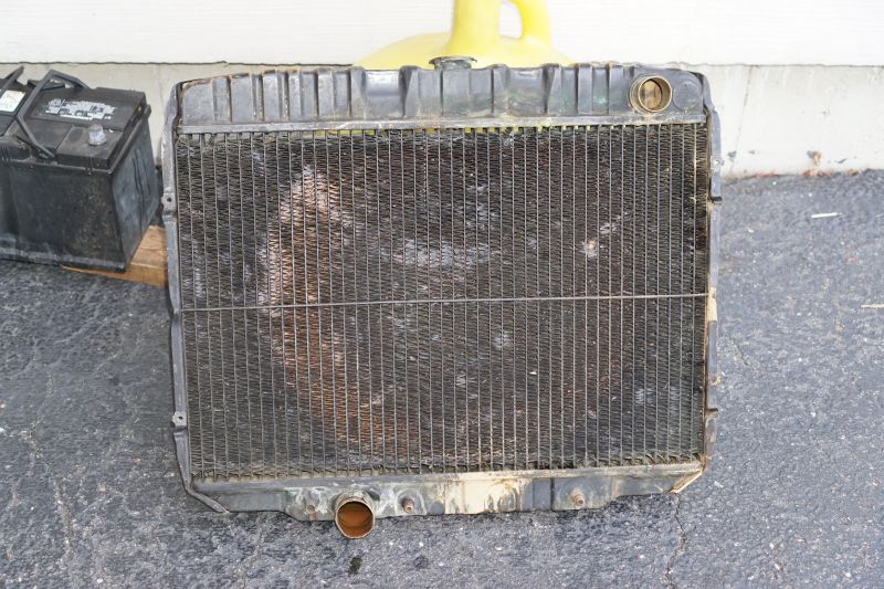

Just got through installing the 24" Big Block Cold Case Radiator. Overall it should be a great improvement to my ride. I didn’t have an overheating issue currently but the 55 year old 24" brass one has finally screwed the pooch.

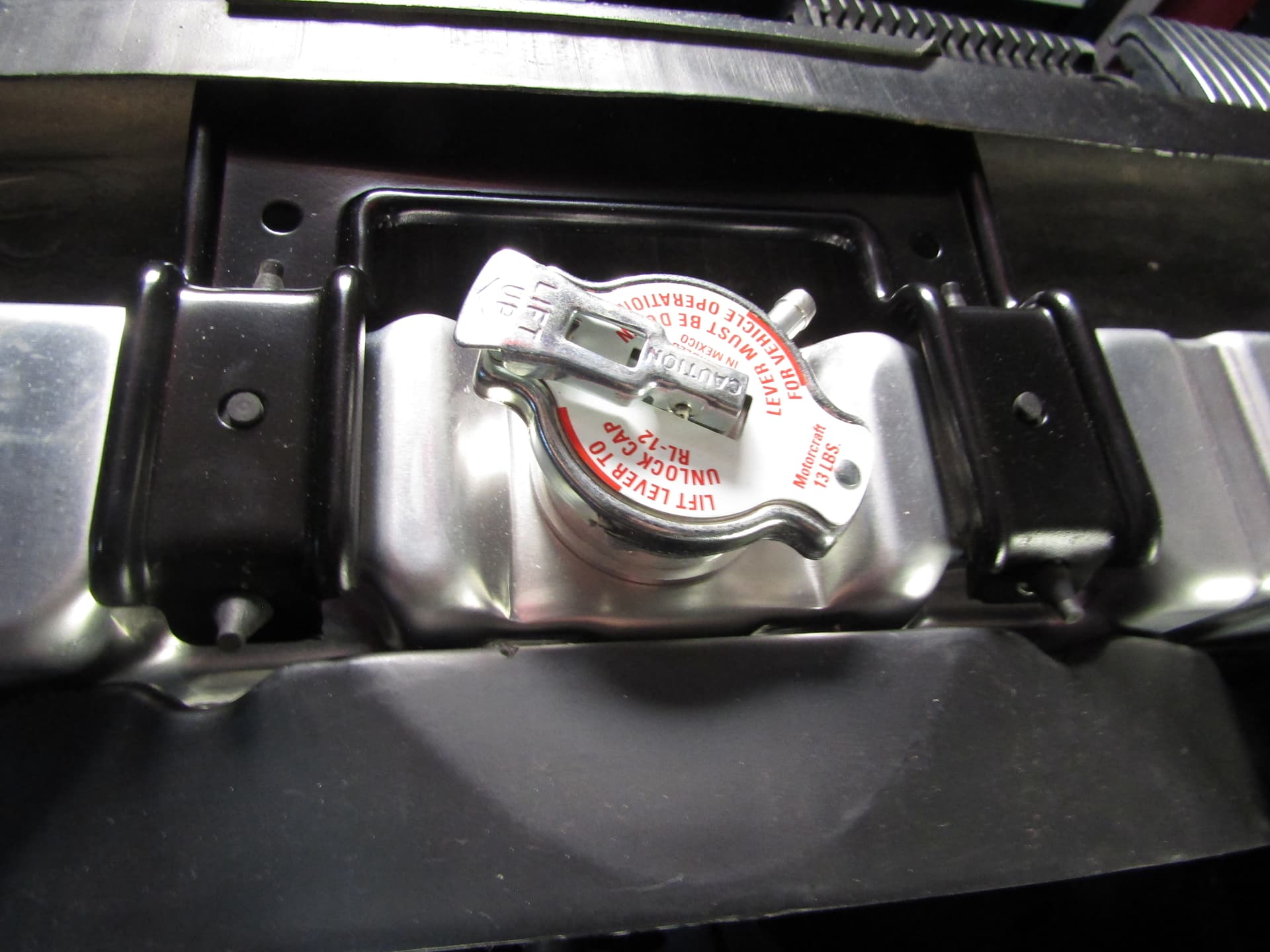

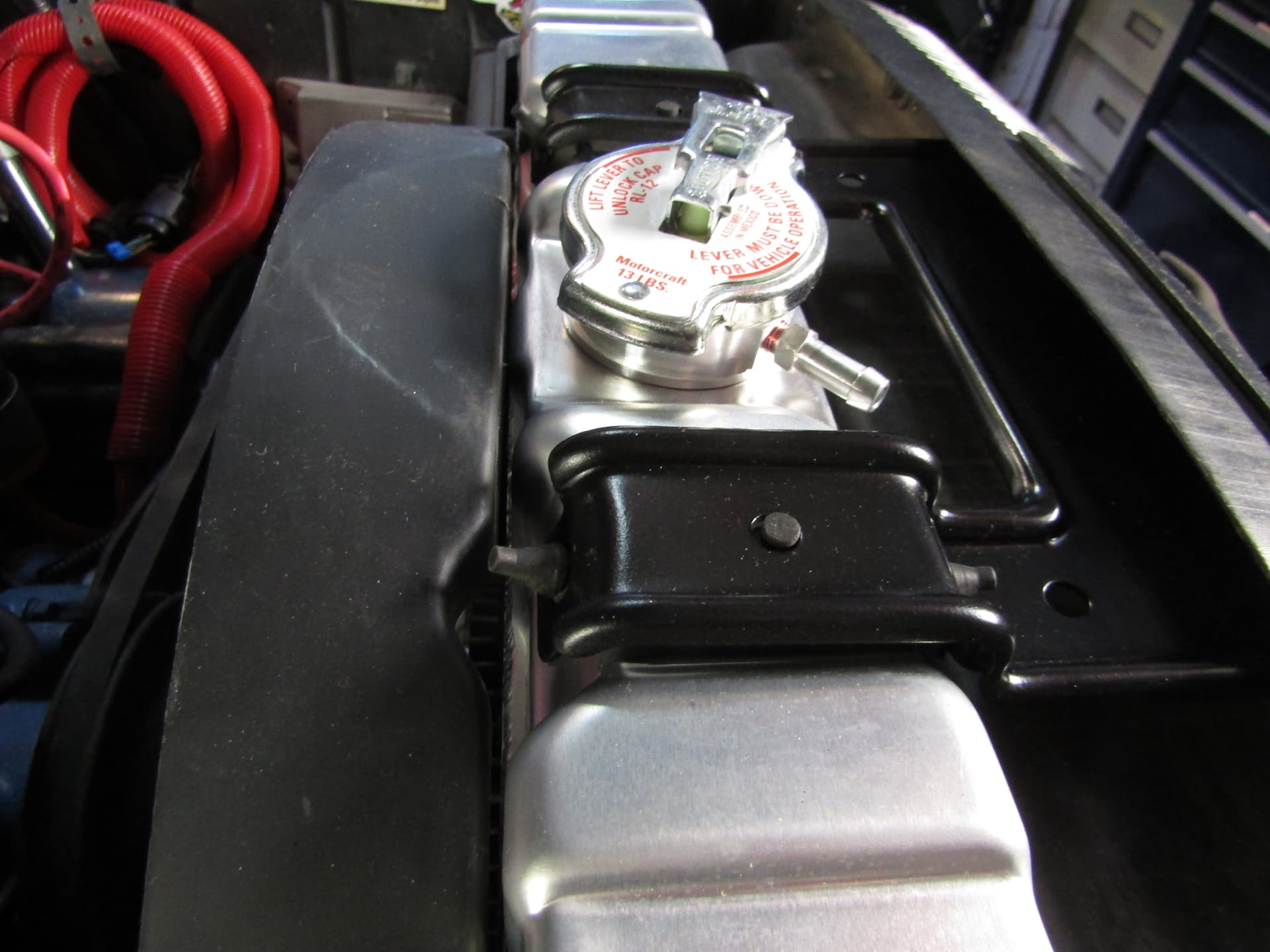

I am having an issue in that the upper mounting bracket won’t fit over the new radiator that is thicker at the hold down points. My original upper bracket may fit if I deleted the rubber. I don’t want to do that and have metal rubbing on metal.
The Cold Case website and tech support list the below brackets and recommend I get one. Is there any chance that these have a wider hold down section compared to my original? It just doesn’t make sense that they would be different but “made to OEM Specs”.
