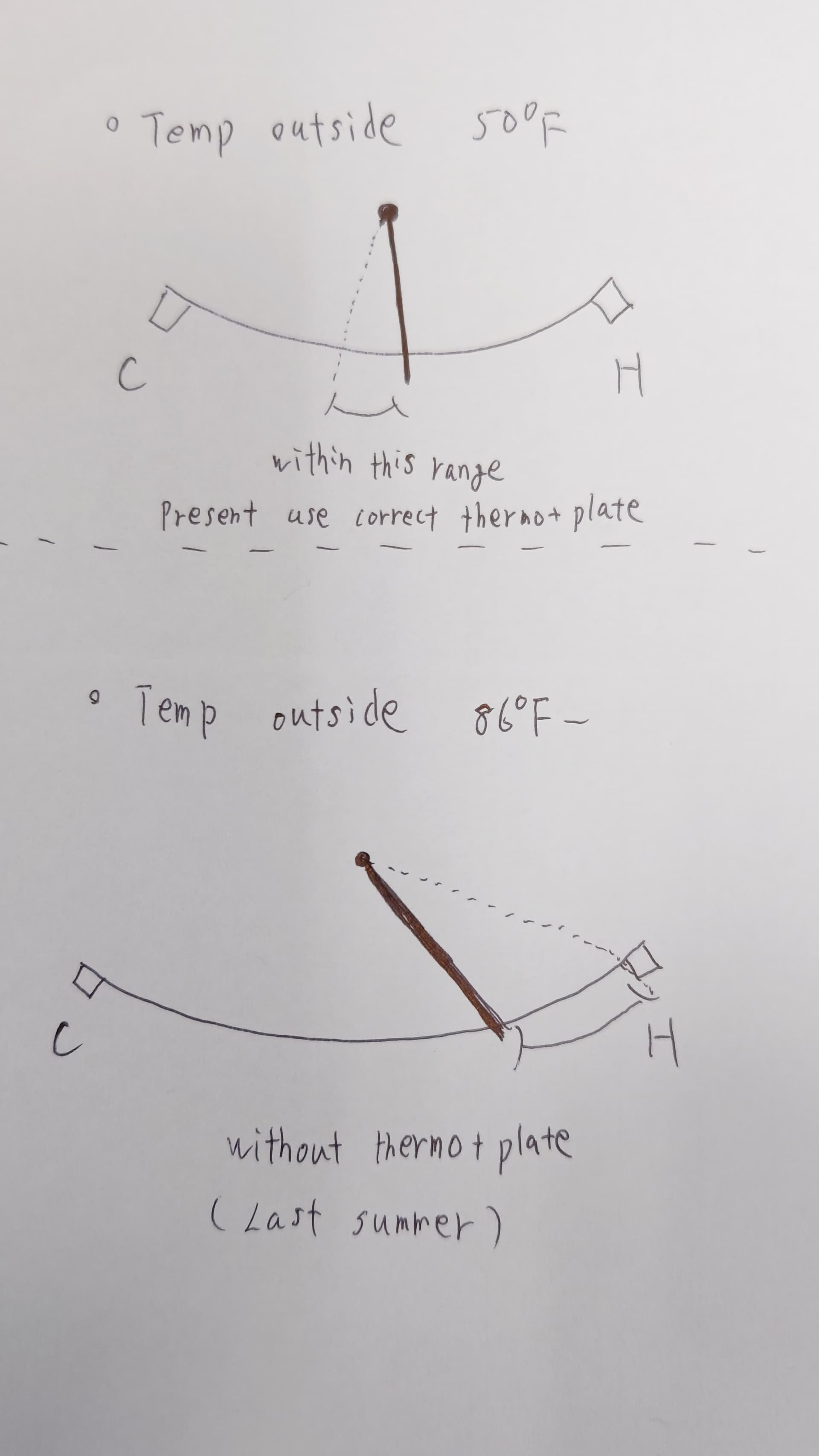

I appreciate your constant advice.I’ve written about the current state after the work and the state last summer before the work.The difference I noticed after the recent work was that the warm-up time has shortened.
Thank you for your advice as always.I’m considering installing a new water temperature sensor and gauge to confirm the appropriate water temperature.What do you think about the position of the gauge needle I drew in the diagram?
That’s the purpose of the thermostat - faster engine warm up to desired operating temp. Now use your infrared thermometer to measure the engine temp at the temp sensor. That’s the best place to start in figuring out if you really have a temp problem or if it’s just the gauge or sensor. On a winter day, it shouldn’t be running much hotter than the thermostat rating - normally about 195 deg F which should read less than 1/2 on the gauge. On a hot summer day, 210 deg F coolant temp should read just above 1/2 on the gauge.
Many /. most of the thermisters sold nowdays to replace the temperature sending unit are the wrong value. I would measure the actual temperature at the sending unit using my Snap On infrared gun. Likely it is too hot but you never know until you do.

The gauge moves below half while driving, and when stationary for a long time, it shows slightly above half.
Please wait another six months for verification in summer temperatures.

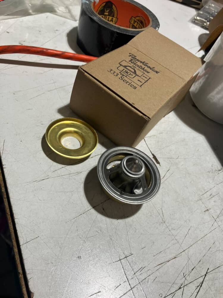

I removed the plate and installed a compatible one.
The two new parts prepared before installation are shown in the photo below.
I see!
So by measuring the temperature and taking several readings of the water temperature gauge needle’s position inside the meter, you can determine what condition it’s in.
Thank you.
Those are the correct parts, and your temp readings sound about right! Summer will be a better test, and I am ready for it to get here soon with outside temp here of 0 deg F.
