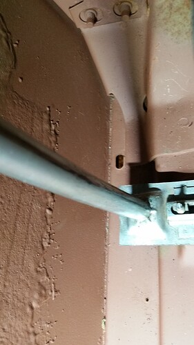

Actually I just watched that vid the other day, but I didn’t notice anything in it about weatherstripping; just mechanism. Thanks! I’ll watch it again.
So I finished, and although I have thoughts of replacing the guide inserts, I believe I have to take the whole window out to do it, I decided to “save for later” and button the door up. Now I’m finished and realize - I forgot to put the new watershields on. Unbelievable.
