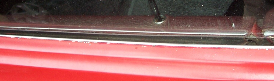

What it was:

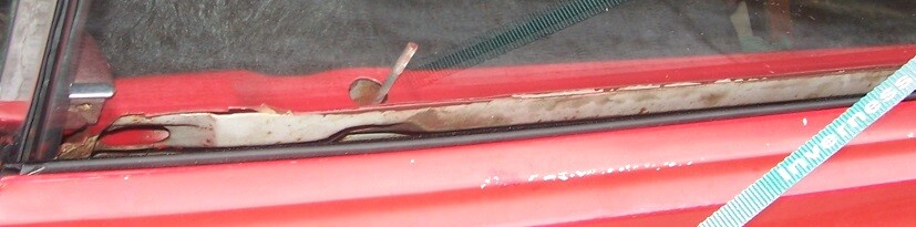

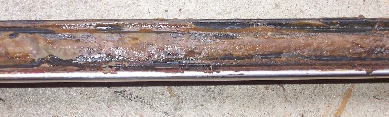

Old trim piece:
Glue side:

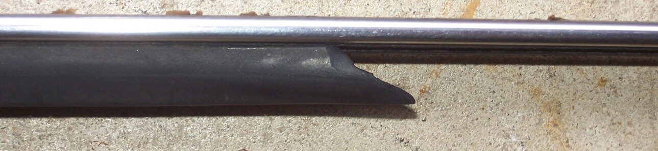

end profile:

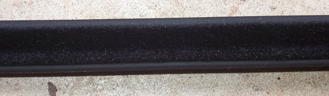

window side (felt):

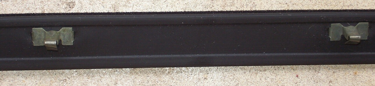

door side (clip):

They goofed! Not correct for your Cat. 69/70 will have no chrome attached to w/x. The piece you show snaps into outer door (outside glass). No trim UNLESS your Cat is an XR-7. Then the trim covers the top of the door (approx 1"+) outside.
The inside pieces that attach to the panels (4) via staples have shiny piece mfg into the w/x rubber & felt. Not the outside w/s that have the goofy clips that are near impossible to remove w/ out distorting them…
Interesting, mine certainly don’t have an XR7 style 1" overlap, just a light lip. What makes this weather tight between the door panel and the trim? Should they be glued and clipped? I did already clip mine on, so the counsel that they don’t remove well is disturbing. I’m in communication with Repops as well, and they appear confused. Thanks for weighing in Bill.
The chrome 1" door-top trim on the XR7 is separate from the weatherstrip. The chrome trim has a lip that extends down and accepts the weatherstrip, and the weatherstrip is felt-only with no chrome on it. It looks like you have the XR7 weatherstrips to me.
I believe the correct weatherstrip for your standard Cougar should have the narrow chrome edge along the top, and clip directly to the door. In either case, the clips hold the weatherstrip in place without glue.

Oh wait - I was wrong. You do need to reuse the chrome just like on the XR7. Your chrome is just a lot narrower than the XR7. Maybe lacquer thinner will remove all that glue.

Well the guy from Repops was supposed to get back to me today after talking to “tech” (who wasn’t there yesterday), but I haven’t heard from him. I’m guessing it’s a shrug off. Notwithstanding I dreamt a vision last night for how to take my trim piece back off without destroying it (rained all day today so didn’t happen); anxious to see if my dreams work any better than reality. I also took the chrome trim piece and worked on taking the adhesive off where it joins the body, and discovered #'s. 1051292 USA - but I can’t find anything that correlates with that. I also tried heatgun and solvent to release the rubber weatherstripping from the window side but it is crimped into the chrome piece. I’m guessing what I got is what I get, but I still have to get the upside down piece back off before I proceed.
