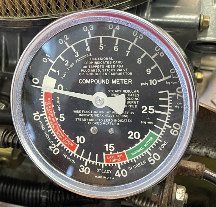

Yesterday, with compound meter/vacuum gauge hooked up to manifold port & new temp gauge connected to intake, started the car and immediately observed not good sound as well as bad readings on the gauge: pressure/vacuum= 10/4 well the sound was obvious that the base timing was way retarded because i was moving the dist around to get the giant dual advance removed & new single unit installed. so as soon as i turned it and brought the timing up, she smoothed out and was idling nicely BUT… the pressure/vacuum only moved to 30/13 never higher. meanwhile the car was warming up 140 the moved to 180 area where my electric fans kick in & again with the burp funnel in place (no closed radiator cap ATT) i didn’t have change to connect timing light as this all took place quickly within few minutes, any adjust to dist. had zero positive effect on the compound meter, so i shut the car off to reevaluate and bam… a volcanic gusher of boil-over coolant erupting up out of the burp funnel all over the place.

for the readings i used this gauge shown (pic not on my motor) and the initial retarded timing read was about 13/5 and after turned up to baseline timing never could surpass 30/13, no where near green zone which last month before all this, it was in the green soon as the motor was started.
no. sorry bad wording i just meant the lower reading numbers on my compound test gauge. but you can see just how low the vacuum numbers have gone since all this started last month.
What is that gauge connected to? Intake manifold vacuum port?
Yes it was tested with exact same results on both, intake manifold port and Edelbrock 600 rt-side full manifold v-port.
Ok, I get it now. The 30/50 readings you mention are in cm vs. 13/20 in inches. But both are readings of manifold vacuum. Yeah, 13 inches is low.

Disconnect and plug the vacuum hose to the distributor. Set you base timing at idle to 10 degrees BTDC. Adjust the idle speed to about 750 RPM. Measure vacuum. In the US we use inches of Mercury (Hg). That is the smaller number. We want to see a reading in the green zone. It sounds like your timing is way out of spec.
