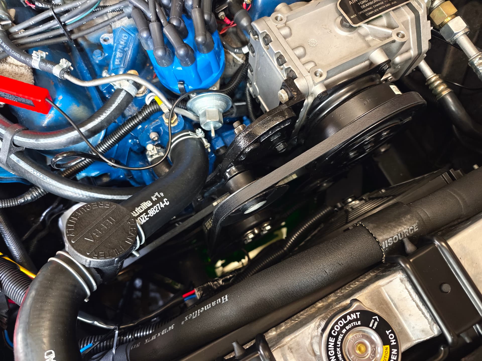

i noticed the temp dial nearing way up on ‘H’ and when i shut the car off i could hear the boiling under the hood and eventually once the cap released, the overflow can started spitting out coolant on the ground. when i opened the hood, the hoses were obviously under extreme bloated pressure as well.
You did the following work:
along with the restored heater box, ran my new hoses & clamps, refilled the coolant & setup my tall burp-funnel I also had installed a new 2" temp gauge in place of my broken center clock

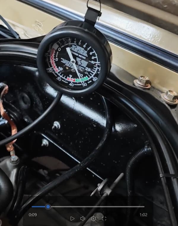

so as soon as i turned it and brought the timing up, she smoothed out and was idling nicely BUT… the pressure/vacuum only moved to 30/13 never higher.

the pressure & vacuum readings are terrible now, highest achieved 30 pressure & 13 vacuum vs 50/20
We got a little lost trying to understand “pressure” But 13" of Hg vacuum is not good.

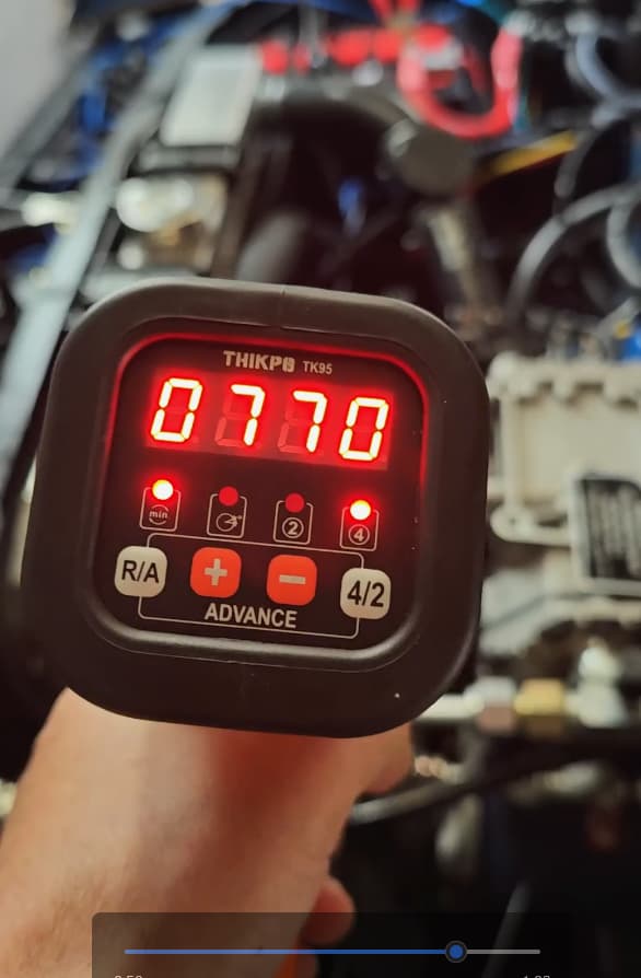

i got the timing to about 7 BTDC, but the Edelbrock idle screw wouldnt adjust any further back, and i was still around 1200 RPMs post kick-down idle speed so 10 timing would have been way higher idle. Likely need to now adjust the idle mixture screws with the vac gauge to go lower, but i couldn’t let the car run any longer w/o the fans stable.
Now you are making some progress. We need to find out why the idle speed is so high. (I am hoping that when you say idle screw you are referring to the one on the side of the carb that sets the opening of the throttle.) Since the Edelbrock is not designed for Ford accelerator linkage you see a lot of different ways it is connected. If the throttle linkage is holding the throttle open you are going to need to fix that. For the purpose of getting things dialed in it is easiest to just disconnect the throttle rod so it can’t effect the carb. It the idle speed screw is all the way out then you probably have a major vacuum leak. If you have been adjusting the idle mixture screws on the front of the carb you need to return them to the factory spec. What model carb do you have?

Last time I got the base timing up @ 7 but, even after kickdown the RPMs would not go below 1100-1200 @ that 7 and the idle set screw was already backed all the way out, so no more room there. I checked everywhere and no sign of any leak. Then disconnected the throttle linkage but it made no difference. Next I readjusted the 2 idle mixture screws with the vacuum gauge, no blockage there because they both did cause the car to almost die out as they should and when finished setting them the car was idling even smoother but idle speed still 11-1200. I mentioned last night i would, so I checked the fast-idle cam and that seems to be what caused the ↑ idle RPMs. I lubed it & moved it around for a bit (didnt adjust the screw) and when i restarted the car and hit throttle on/off, it moved where it should be after warmup and now the car was near dying out barely running, so by turning in the idle speed set screw it came right up into range 750-850 and with timing still not retarded to lower the RPM. So that’s one thing off the plate.

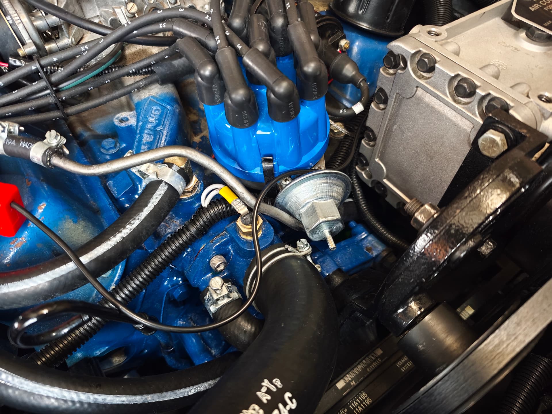

Now on the base timing, you’ll see in the pic & video i reached a physical limit for turning the distributor clockwise for now, as the hard fuel line stopped it out @ 7BTDC. So 1st I’d like to ask you guys (and please remember this is my 1st FoMoCo car ever & certainly 1st '68 Cougar :slight_smile: ) this car was originally F code 302 2V so the hard fuel line is original to that config, does your fuel line come in under advance-canister (as shown on mine) or is it routed above? I’ve no idea if these guys bent it or whatever. I saw some 4V’s but it was a diff hard line and way out of the way over rt side of the motor, no issue with timing adjustment. Common sense tells me it shouldn’t be where it is rn but i left it so far as i received the car.
I plan to address it next time around and can either just cut it back by the A/C stuff as i have a bunch of very high quality and +safe GATES Barricade fuel injection hose & clamps from another car that i restored. Or last option, i’d have to pull the distributor and do TDC and drop it in a different position. I’ll see but i think if i can route it above out of the way, i’ll have enough room to reach 10 on timing without TDC & re-orienting the dist. so i will likely try that 1st.

Attaching some pics so you all can see the fuel line / canister location, RPM & vacuum updates.
the motor is really getting smoother/better each time out there and further improved even higher steady vacuum plus now proper range achieved for RPMs. (are we not allowed to use videos here?)

they bent the fuel line to reach the inlet location on the Edelbrock. Bend it so it no longer interferes with the movement of the distributor.
OK sounds good, will do that or if line gets compromised from all the bending, I’ll cut it off further back and use my Gates Barricade fuel-injection hose run up to the new metal filter & fuel inlet✅
Nice progress! What are you wanting to accomplish by running it with radiator cap off? You need the 13 psi pressure that the radiator cap maintains to raise the boiling point of the coolant. Without that, it will boil coolant out at normal operating temp.
Just make sure you have coolant in the recovery tank, and it will draw that in to replace any air bubbles as it cools off. And watch the temp gauge for signs of overheating.
Hey there, yeah thanks it was a +good day. On the cooling system, with all the fluid loss & refills, wanted to run it just for literally a few minutes again with my tall burp funnel installed in the cap opening to pull any new air out, they really work great and have been indispensable on many of my cars, especially the C4 Vette which has issues with trapped air, but then, that radiator rides almost touching the ground way down there😄
As far as the coolant recovery goes, they installed an aluminum cylinder bottle which has a sealed top, no regular access. you have to unscrew 3 small screws and break the seal loose to pry the lid off & then reseal anytime you want to look. so big pita & to me a stupid design. Later after this stuff is resolved, I plan to get a generic standard type molded tank and will hide it up under the right fender if i can. if not, i’ll find similar bottle but with a normal screw-cap, but i’d like a higher capacity tank if i can.
On the radiator cap, do you suggest a 13 or 15 for my car setup, as I have both to choose from here, and both are brand new.
To fix your distributor hitting the fuel line issue: Remove the distributor and drop it back in one wire’s worth of rotation CCW. Then remove one spark plug wire at a time, moving it one position CW. That will put things in approximately the same position for firing sequence, but you’ll need to fine tune your advance. You should now be able to adjust your distributor more than previously.
Sounds like a good plan. 13 psi is correct for your car. Good luck!
Ah yes, another good old-school method that works, but didn’t cross my mind yesterday. Actually in you bringing this up, it made me think even if just temporary to get the car back on the road for testing, all i need do for now is to leave the distributor where it’s at, then move all the wires over 1 position CW. at that point, verify and timing should be right about where I want it. this should do it for now correct? and thanks for checking in here👍
