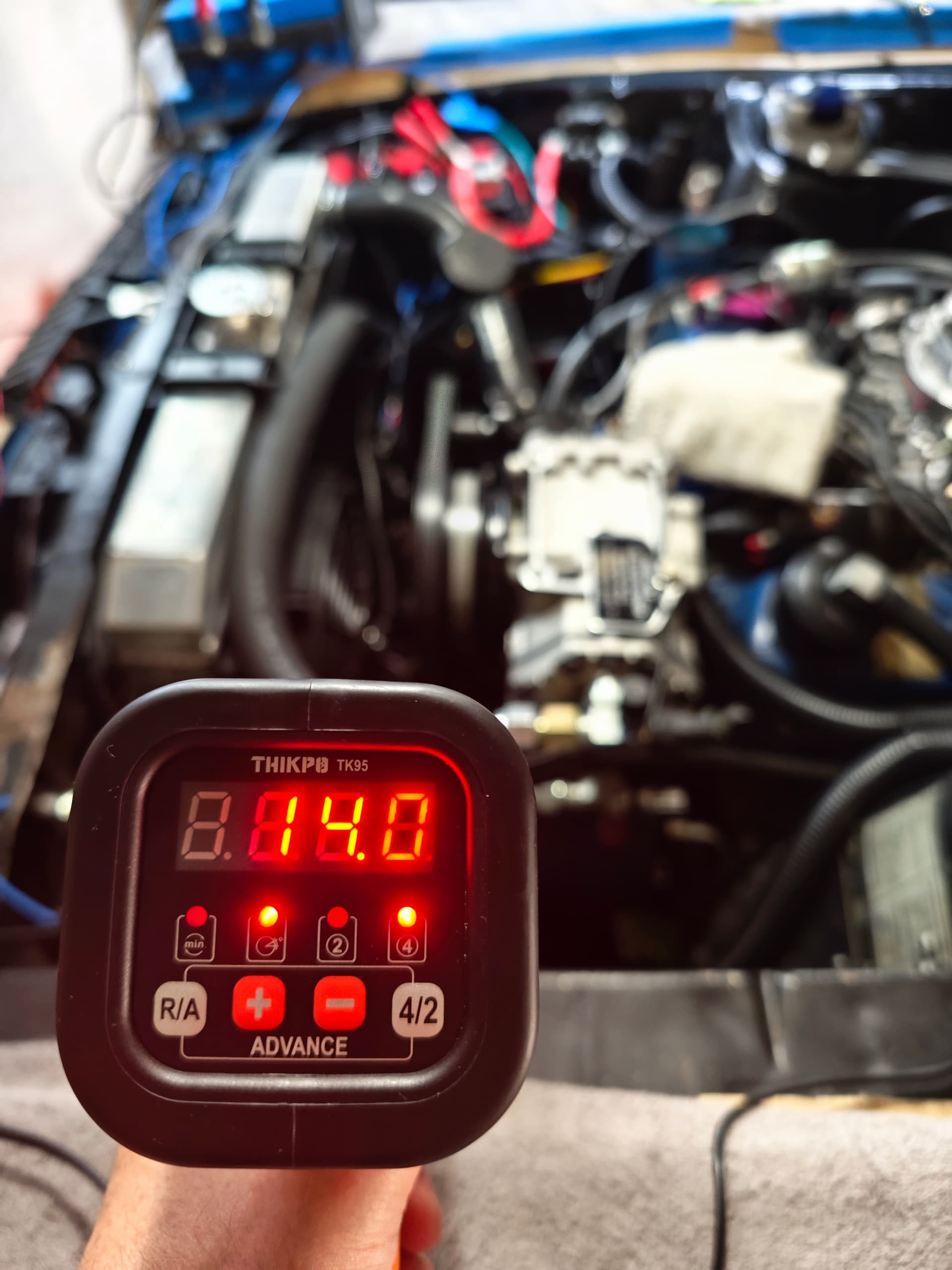

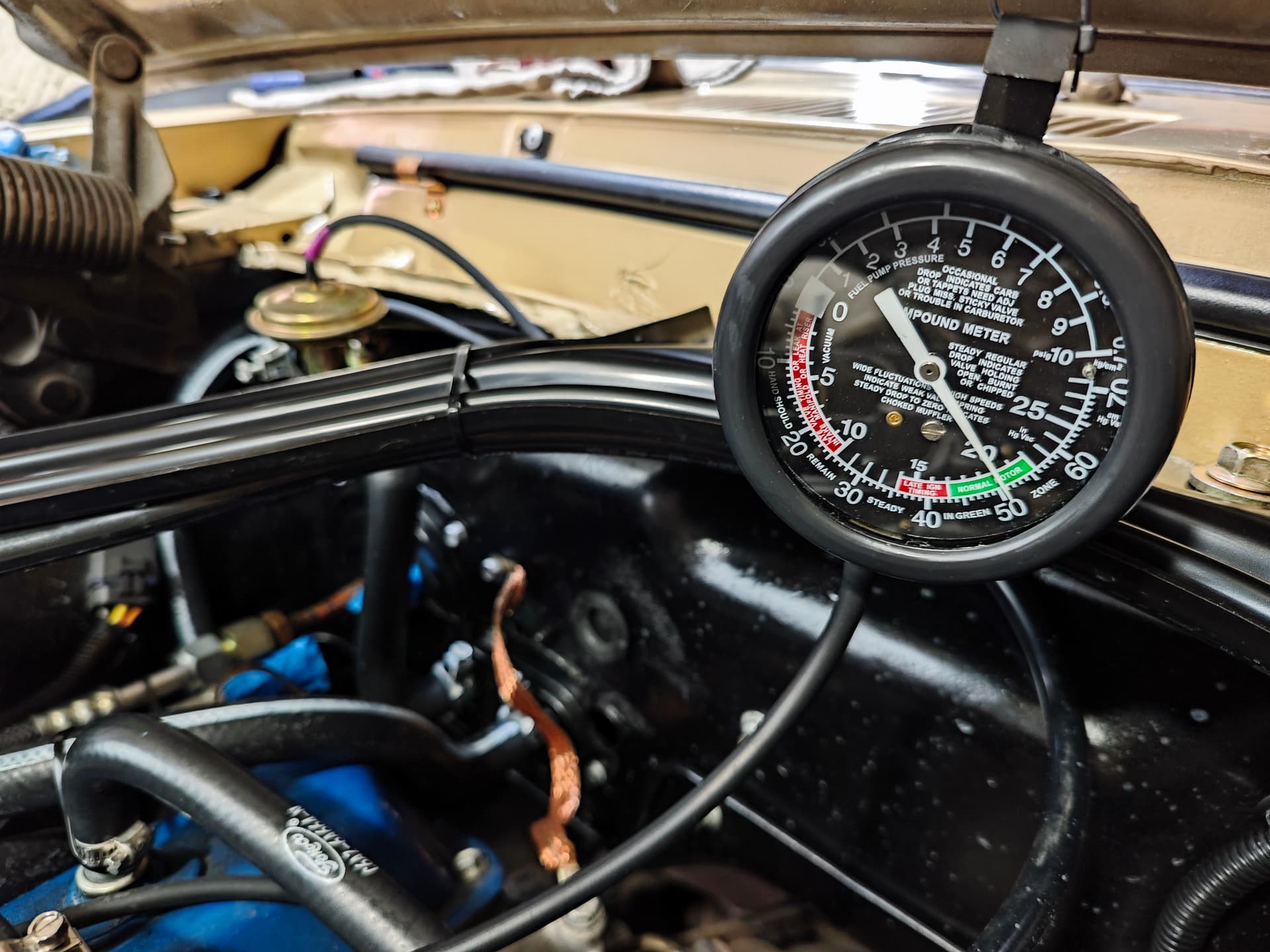

Start the car and now with fuel line moved and room to turn distributor, address the timing again. I took it up from 7 to 13.8-14 about where vacuum peaked and now is all way up to 20 from last Sunday @ 3 or 4! turned down the idle rpms back down to about 760. At this point, purring away steady, smooth and very cool running. Never ran close to this good since i got the car.

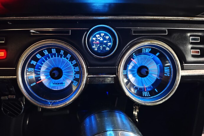

Continued to let the car idle, turned heat on full high and monitor temps, so one thing happened I think my fan temp coolant switch went bad now as the fans kicked on at 140 instead of 185. I will order a new one for install this week. After about 20m idling, the motor wouldn’t even go above 165 degrees, the cooling system & fans are functioning so well! Quite opposite of last month where it instantly overheat and boil-over on shutdown. im not used to any of this good stuff with this car (still completely replacing the poor electrical wiring job on the e-fan system this coming week) So since temp was so low, it wouldn’t even open my t-stat, i pulled the fans fuse and let it heat up. idled another 13min and in a hot brick garage with no fans, it never went above 190-200, thermostat opened and i check temps all over, has a nice variance of like 30 degrees, ± 10 between upper & lower hoses. the heat inside the car was so hot that i couldn’t even touch the metal ducts or a/c heat control switch assembly, they were all like a hot pan on a stove. so my hard work to restore the heater, A/C box and heater core has also paid off as well. very satisfying. So she ran over 35min sitting there idling, zero issues, smoothest i’ve seen this car run yet. yanked the throttle a few times and there was no more bog either (i’ll see if under load). Turned off, heat soak stayed with it out there, and nothing. no boiling, no sounds, no leaks, or puke-spitting coolant on the ground, no bloated hoses, nothing bad. like a normal car again.
Will still need to real-time adjust the new vacuum canister and also check total timing, both not touched yet, but should be a minor thing. I put a couple pics below including the new temp gauge inside the clock’s opening. (and yes, i need Bill’s dash panels asap, mine are broken & in horrible condition. they’re wrecking a beautiful interior) and i think im switching to a green backlighting too.

Way to stick with it - great progress! With timing advanced that far, I bet you get real snappy acceleration! But don’t be alarmed if the engine sounds like it’s full of rocks when you accelerate. You’ll likely have to dial it back closer to 10 degrees BTDC to prevent pre-ignition pinging.
Thanks. yeah, actually before closing up yesterday i took it down to about 12 so we’ll see how she runs. I’m looking forward to driving the car today.

Hey Craig, to help keep the thread history & resolution accurate, I started with 14 in the garage, but ended up @ just under 11 BTDC base timing on the road test, vacuum advance connected to ported side and running just a quality regular gas.
