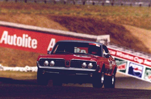

One of the strangest things Ford did was the close ratio 4 speed, my opinion is that it doesn’t work great in anything, and especially a Drag Pack CJ. 1st gear is too tall at 2.32 and if you gear it for 1st, 4th is screaming
A close ratio 4-speed is best on a road race track - down shifting doesn’t cause the car to get upset from the RPM change!
It also helps to keep the engine in the optimum RPM range.
I took the close ratio toploader out of my '70 351C cvt and put it in my '67 TA race car. It was a vast improvement over the stock wide-ratio.
The '67 runs 4.11/4.30/4.56/4.71 depending on the track.
