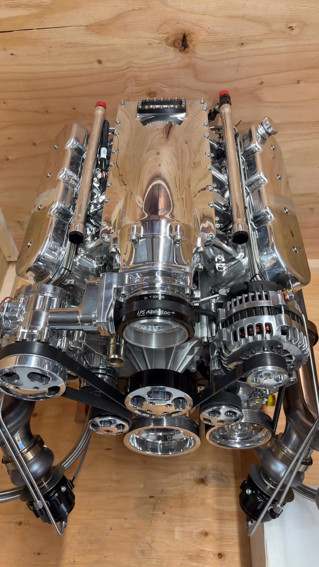

Well, it LOOKS like a drip of Mercury.
It does! Not something you could call practical, but WOW!
1,700 HP and “daily driver” in the same sentence ? A little oxymoronic, if you ask me.
Looks like the motor won’t fit anything without serious modifications. Unless you are made of money I can see you spending a lot.
I was hoping I could find room for my AC compressor….

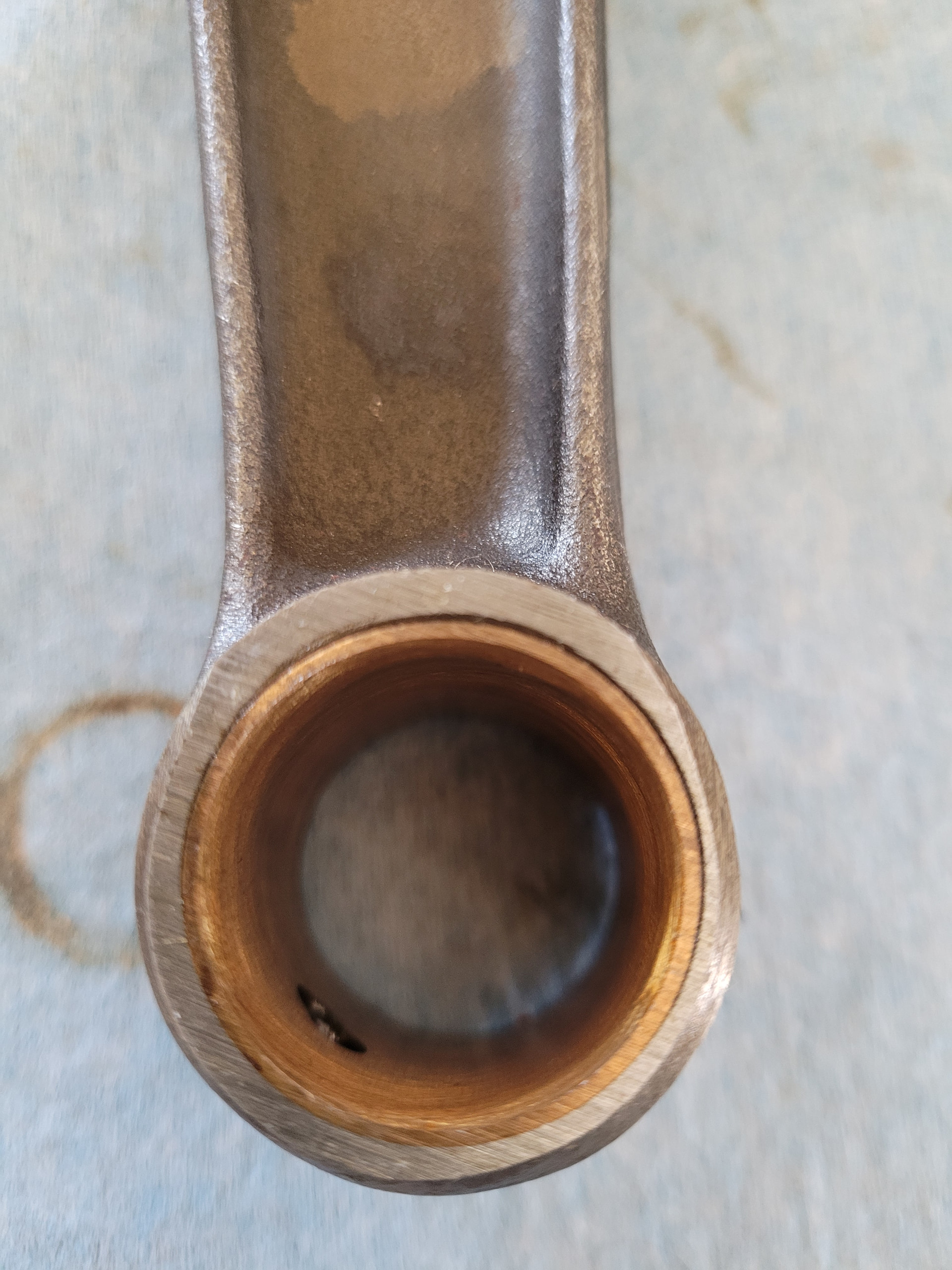

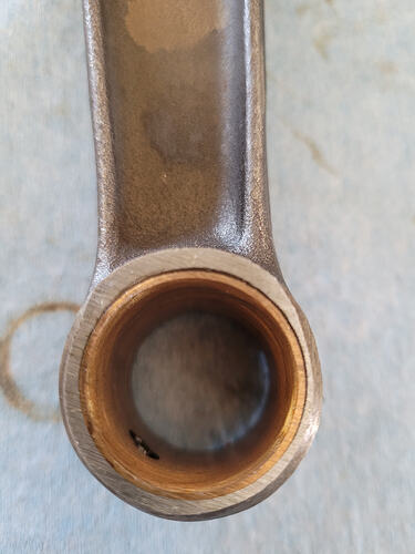

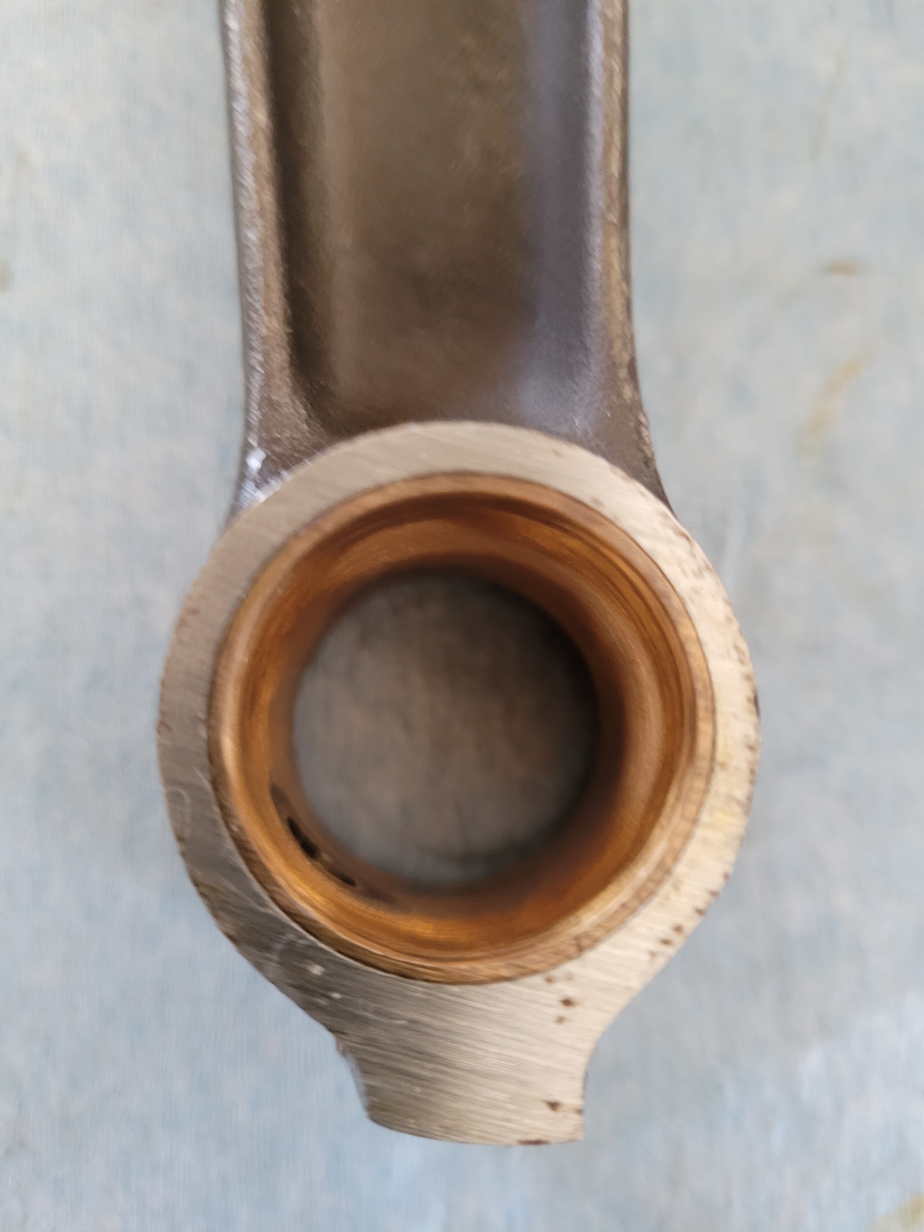

If you go down the rebuilt route, take head. When I bought my current project, the 390 engine had already been machined and the pistons were fitted to the rods by the machine shop.
I disassembled for inspection because they felt a bit tight. Good thing because they had ground away the rod small end that would likely have cause failure soon after starting.
Good Rod
Bad Rod
You should consider assembling yourself where you can inspect and verify all.

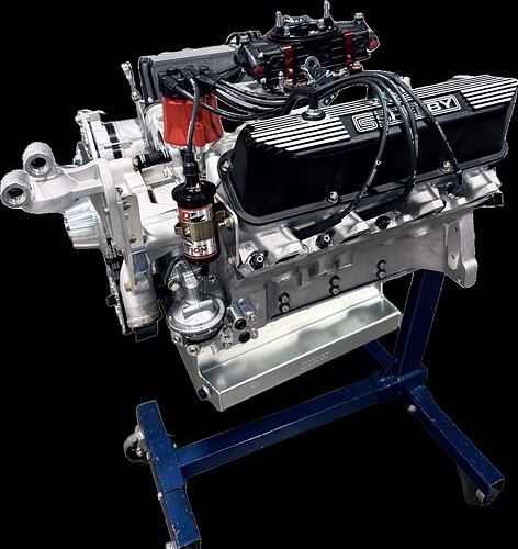

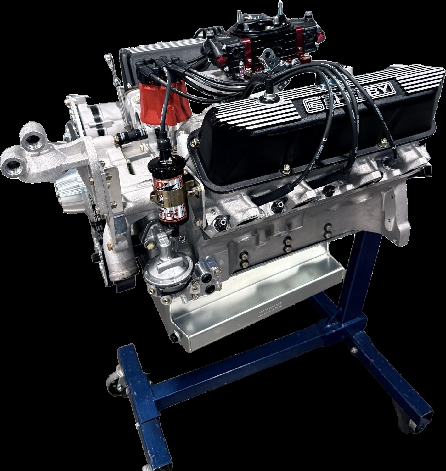

This would make a good engine swap.
No Reserve: Carroll Shelby Engine Company 427 FE 468ci V8 Crate Engine for sale on BaT Auctions - sold for $28,000 on February 16, 2026 (Lot #230,182) | Bring a Trailer
Definitely more afFORDable; but I had to walk away because he wouldn’t give up the engine stand.
The engine stand is the only thing that’s steel.
