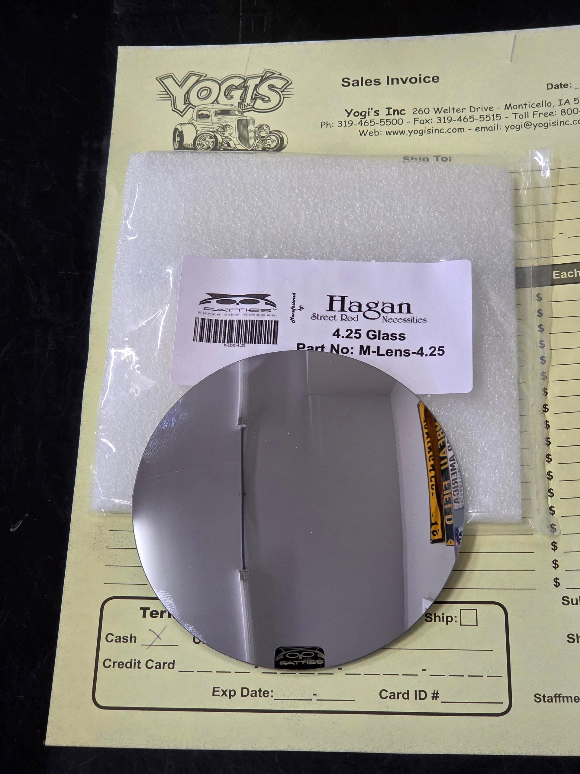

I finally found a 4.25" convex mirror that fits properly into the mirror housing to replace the existing flat mirror.
Hagan Street Rod Necessities
Fatties-Round Mirror Replacement Glass 4-1/4"
Product Code:  M-LENS-4.25"

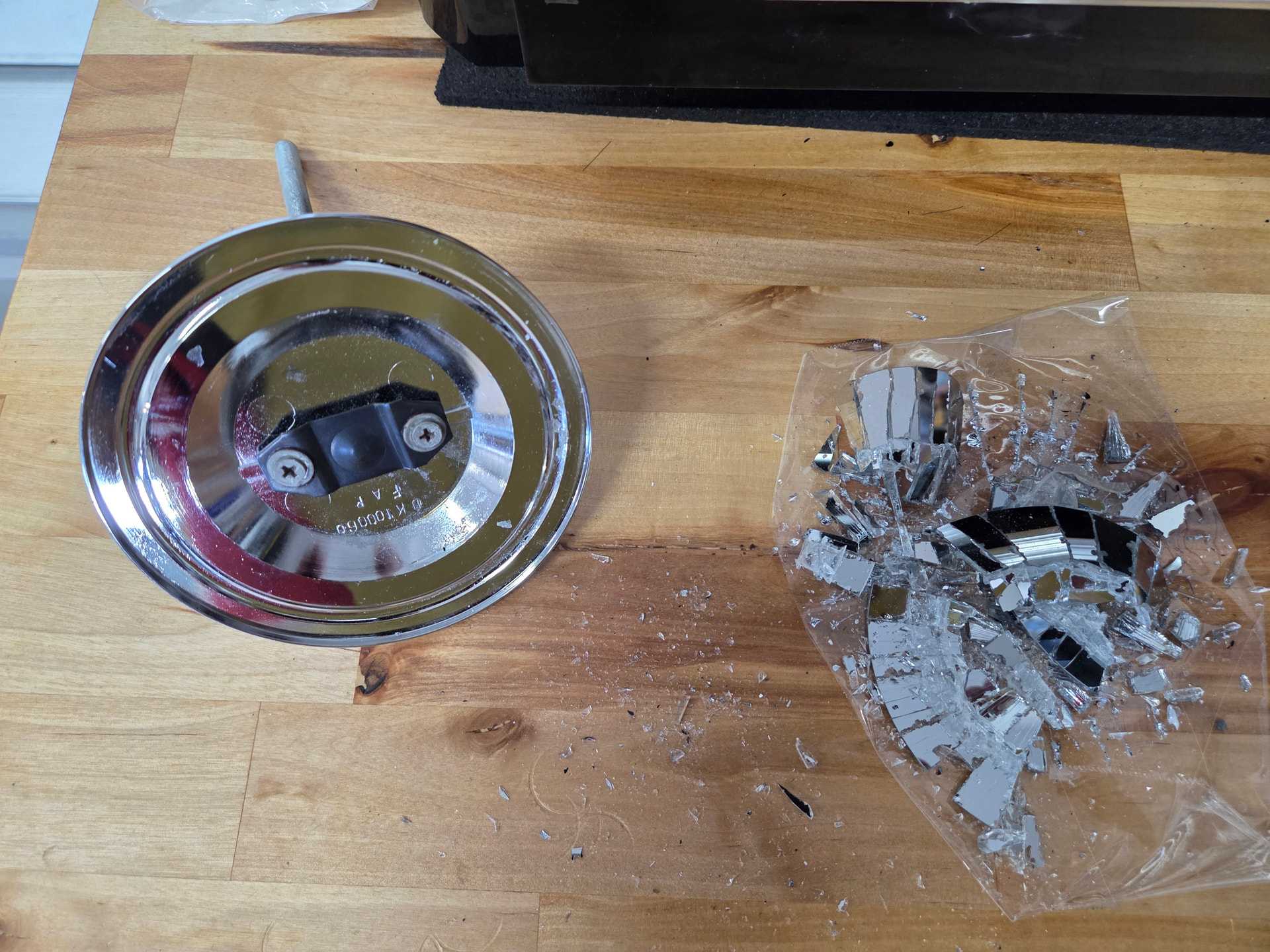

Removing the old mirror was simple in applying shipping tape over the mirror, hitting in the middle to fracture the mirror, and then use a plastic scraper to remove the remaining glued fragments.

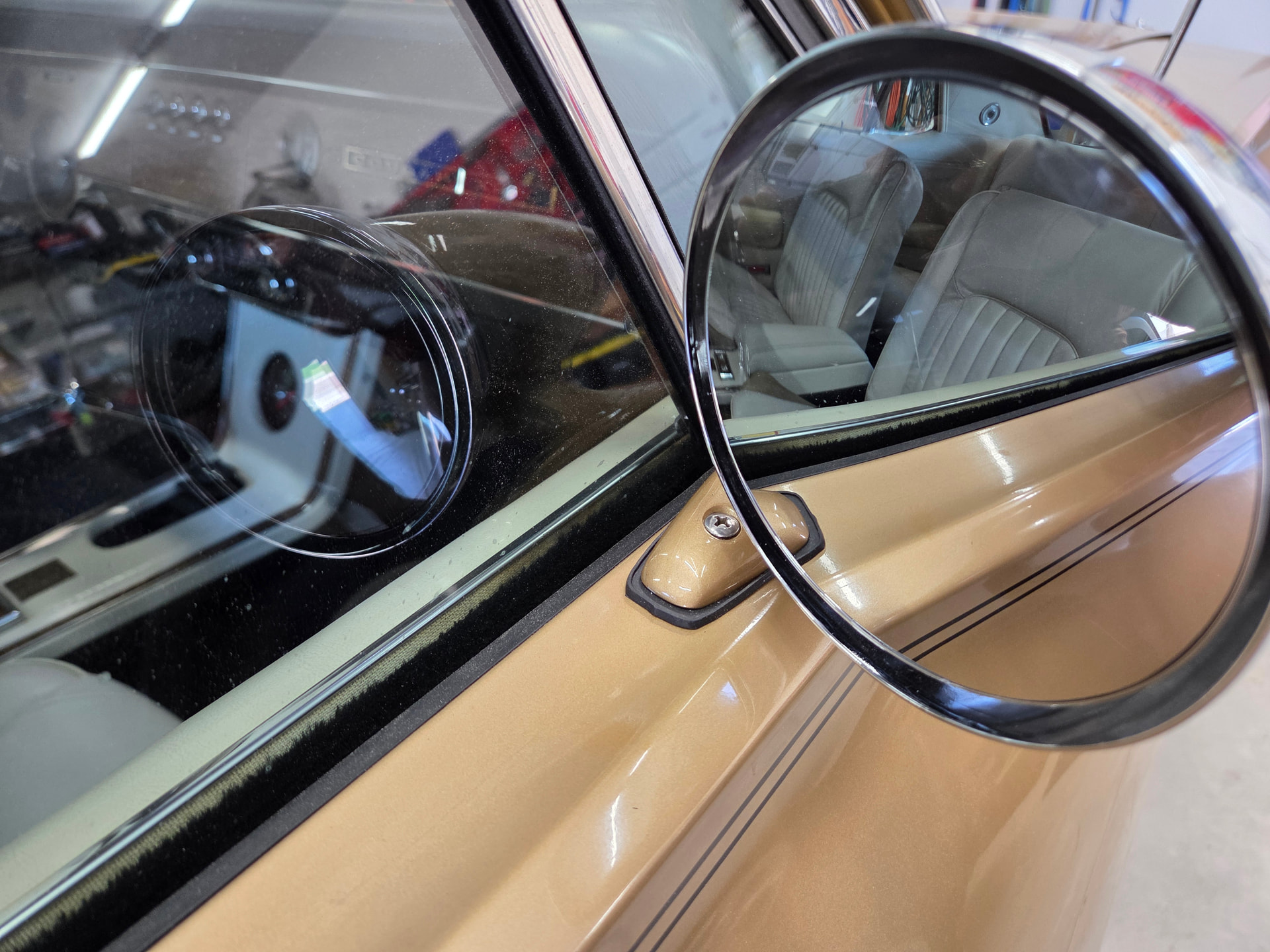

Although not perfect, this mirror provides a wider view than the original flat mirror.
