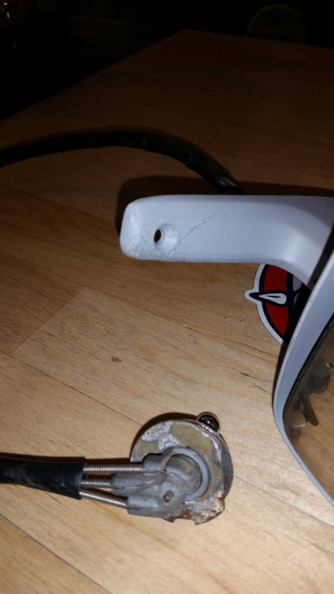

I was doing some surfing and came across your post, rather than opening a new one with the same subject, I hope I could get some advise. I’m kind of in the same spot on these. As you can see, one of the bases has a hairline crack. I know this is pot metal but is there some way there could be a spot weld on the back side to strengthen the crack and filler, sand, re-prime and paint the outside. I really don’t want to replace it.
Thanks in advance fella’s!
Todd
Todd I’m sorry I missed your post or I would have replies sooner. If it were my mirror I would not spot weld it out of fear of ruining your mirror. I’d probably use JB Weld-Metal:
It’s sandable and it’s strength should be more than enough for your repair. I hope this information helps.

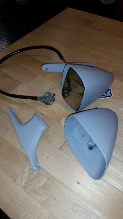

Here is the XR7G mirror and the base adapter with a fresh coat of black paint.
Looking good Steven.
