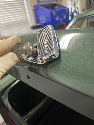

The trunk lock installation can be a bit of a challenge and has been for me for years until I figured out the proper way.
The lock cylinder needs to be removed from the housing first. This can be accomplished by inserting the key and turning it to the 1:30/2:00 position. At this point there is a pin on the top of the cylinder to the inside of the housing that can be depressed which will release the cylinder.
Now this allows for the installation of the outer housing, then the latch, then the lock cylinder.
The sleeves that go onto the outer housing are installed using a pencil magnet through the access hole on the inside.
My lock rod had a small retainer cap on the end which I reinstalled as well.

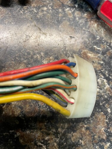

Since I put the column together the hazard flashers have worked however the turn signals have not. I started by verifying all fuses were good then tested the power connections at the switch connector, all good. Time to pull the steering wheel to test continuity. Once the switch was out I realized I had no power at the switch for the turn signals however the wire tested out good with an ohmmeter. As most of you know the connector has to come off of the switch when removing to paint the column. I originally took pictures of the connector prior to disassembly to hopefully ensure the wires went back in the correct location.
On closer inspection of the photo I realized I had crossed the two blue wires. I swapped them and magically the turn signals started operating.
Camera on a phone are probably one of the best tools to assist in documenting things on teardown I just have to take better quality photos as you can barely see the yellow tracer on the blue wire.
