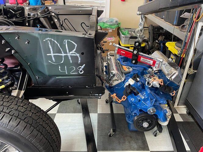

Big day today, the engine is going in later this morning. When I purchased the car few of the original engine components still existed and all of the carburetor, accessories and smog were gone. Fortunately the VIN stamped heads were there and in great condition. I was able to locate a std. bore date correct block and intake. HP engines in Norwood, NC performed the build which was relatively stock with a few upgrades to the pistons and valvetrain. I thought I would let these two spend the night together before the big day.
How exciting!
  • Phillip
Spent the morning getting everything prepped for the install based on the suggestions that Royce provided. Passenger side manifold is off driver side is on and the smog tubes are installed.
It slid right in! Thanks for all the advice from Royce! It’s been over 20 years since this car last ran, that’s about to change soon.

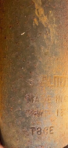

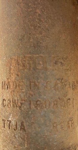

Preaction I finally found the photos of the shocks. I apologize for the delay but yes they are C8’s.
Makes sense - same ones I restored for my red 1968 1/2 R code.
No worries Kerry although the demand isnt high those are very hard parts to locate as they are unique to a 68 competition suspension equipped car. Not many cars from the 60’s have the assembly line shocks today.

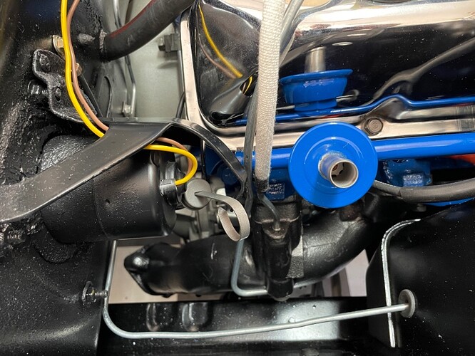

Progress over the last two weeks has been a little slow as work has been busy. I spent last weekend taking care of a few small items in the engine compartment; carburetor, choke tubes, fuel line etc. Now that the engine was in I installed the sway bar to finish up the front suspension. Royce had indicated that it was just in the way prior to the engine installation and for as difficult as the end links were to attach with the engine in, it would have been a bigger task with the engine out.

I think your parking brake handle is installed backwards? Should point left from the shaft.
I like your “day 2” upgrades.
Here is a photo I grabbed off the internet of what was purported as an original Shelby Cougar steering wheel.
Thought I’d post here (if you haven’t seen it already), as a reference for you.
Brake handle looks right to me. Nice work!
Okay, well this one points to the right
and this one (from the GTE you just finished) points to the left.
Just trying to be helpful. This is an amazing car and obviously a fantastic restoration. I am very jealous.
