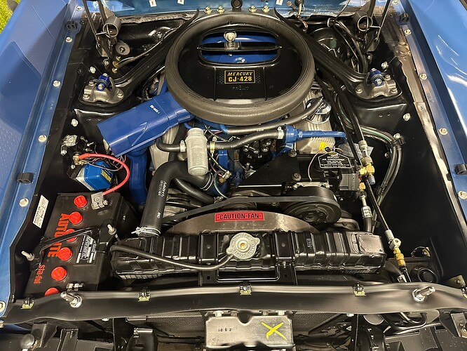

Still working on the rocker panel issue, but at least the engine compartment is done!
Looking good Joe - what all did you do?
Done:
Broken and wrong cheap spoiler removed.
Wrong aftermarket hood pins removed and replaced with correct set
Rubber hood seal installed with clips- factory variation
Hidden rear seat belts removed from under rear seat and broken belt repaired with correct OEM parts.
New engine wire harness installed
Correct vacuum advance replaced after removal of incorrect dual pt/vacuum advance (would have been correct for 4-speed)
New correct oil sender gasket installed
Oil change, coolant change done
Date code correct carb found, restored and installed- over $1000
Date code correct radiator found, restored and installed- over $2000
PVC system renewed with new hoses and valve
Complete tune up done, with new spark plugs and wires, new coil, new points
New heater and radiator hoses installed
Correct #7 and #9 emission clamps and correct hoses installed
Shifter rebuilt and new seals installed, broken shifter handle replaced.
Glove box, ash tray and license plate bumpers installed
New gas tank and seal installed- orig date code perfectly functioning sender noted
Gas door refurbished with new emblem and plastic surround
New gas lines and correct clamps at fuel sender (new sock) and at driver’s rocker
New gas tank installed with original jute and spare tire board kept.
Correct wiper blade inserts installed
Rear window switches in wrong, causing rear windows to not work- door taken apart, switch fixed with J hooks, board backing repaired.
New felt on passenger rear window installed
Broken aluminum trim to XR7 convertible trim repaired and reinstalled
New wheels and tires, with new centers
Correct jack and tire wrench missing-located and added
Correct decals and paint daubs applied throughout the car.
Correct Carb and engine tag missing-installed
Strut rod bushings installed incorrectly and fixed
Worn Idler arm replaced.
Brake hardware missing slides- repaired
8K Rocketman aftermarket tach removed and NOS date code 9B 6K tach installed, wiring repaired back to factory
Replaced wiring to courtesy switches. Cleaned and refurbished original dash. Reconnected ducting under dash.
Replaced non-functioning temperature sender after testing gauge and gauge was working.
Date code correct rare Carter X 4441S fuel pump installed.
Total spend on parts alone: Over 10K.
Nice work! Sounds like a new car. Was the 4 speed distributor an original 68/69 piece? Selling it? My SCJ needs one.
Sounds like it must now be pretty nice!
It was an automatic with a 4-speed vacuum advance. I still have the vacuum advance.
Honestly looks like a different car.
