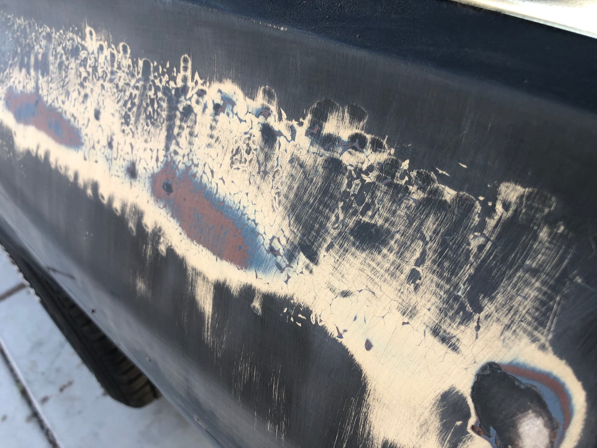

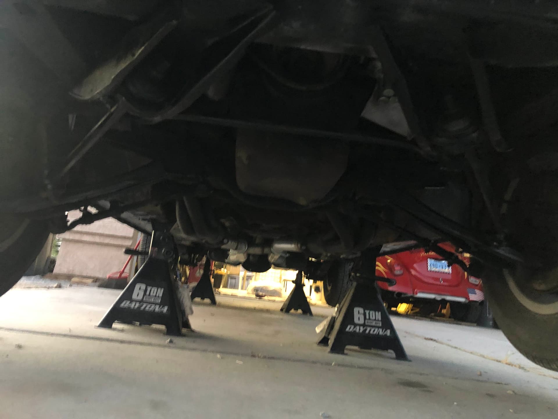

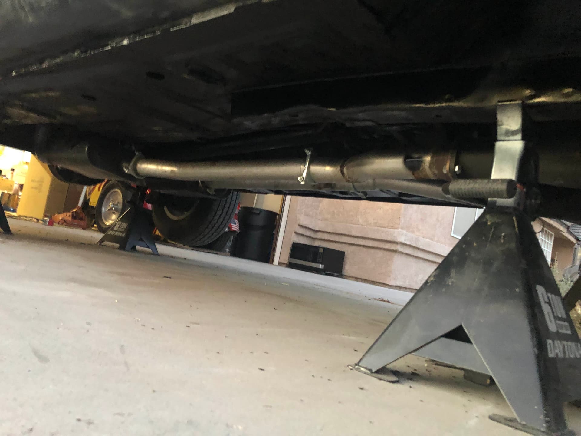

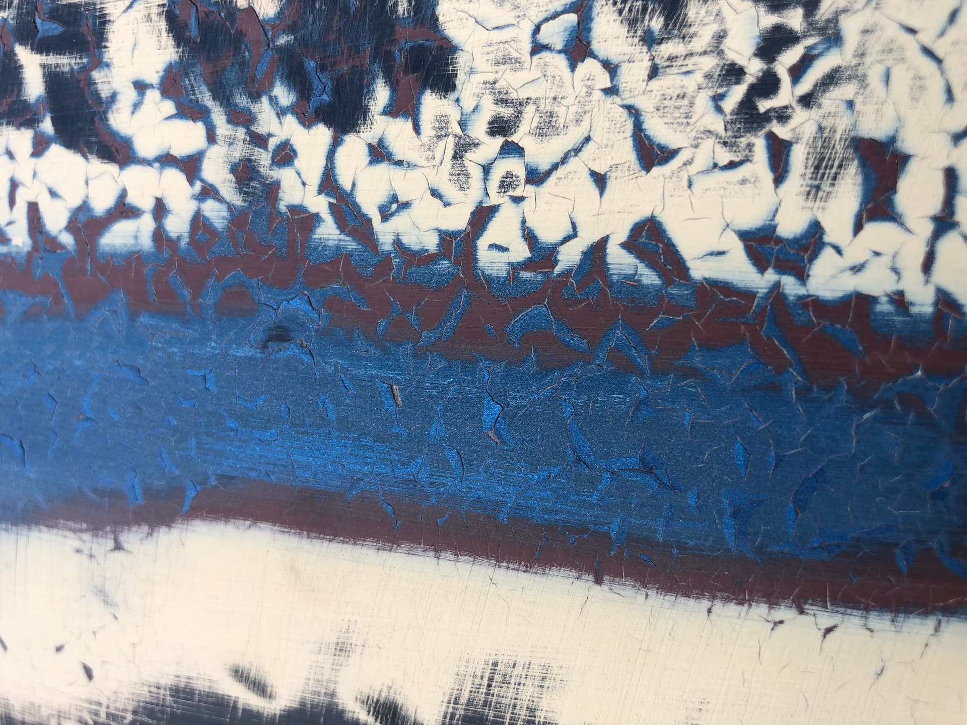

Beginning to tear into the paint, the other cougar was easy mode compared to this cat! :scream_cat:

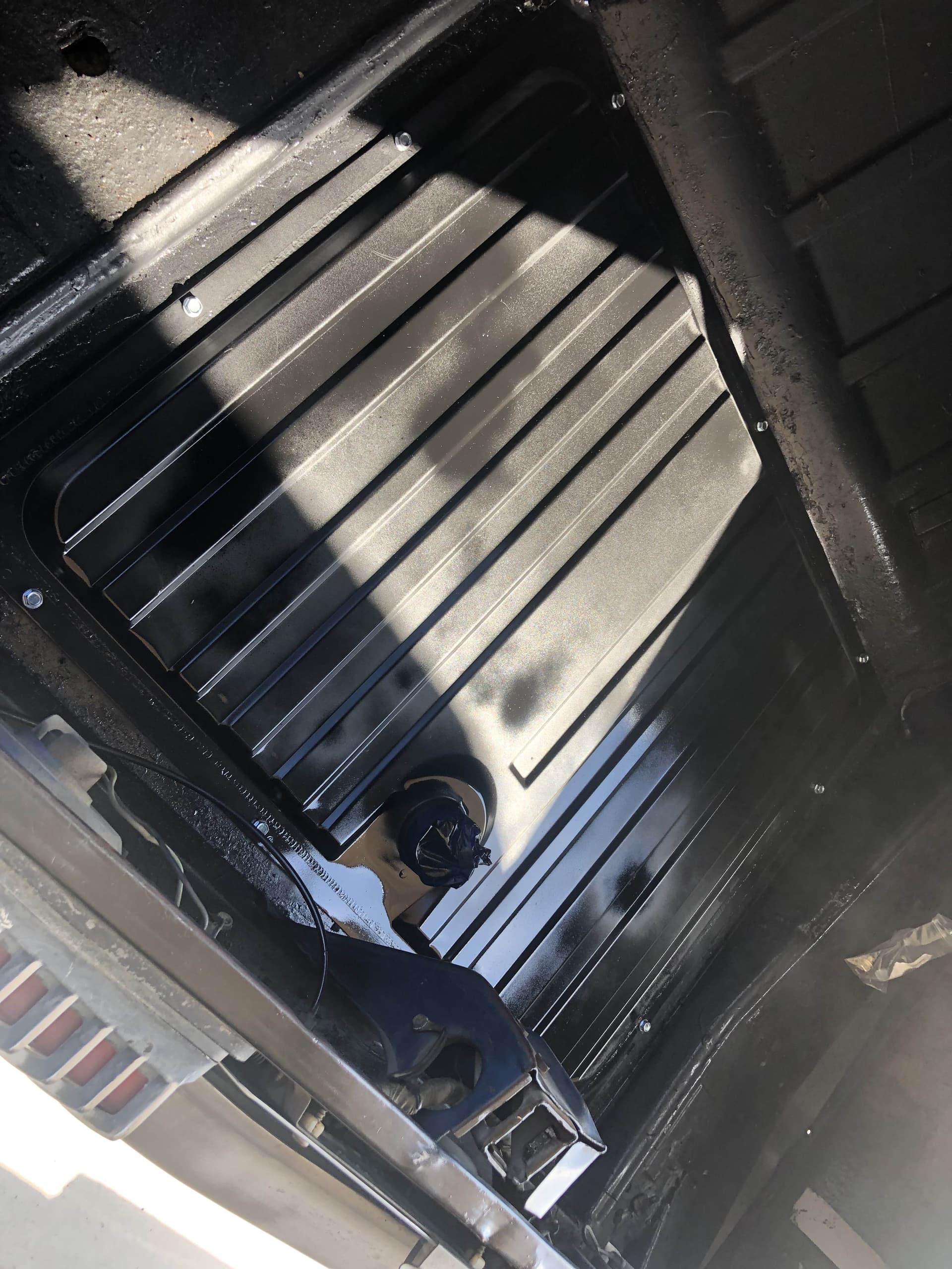

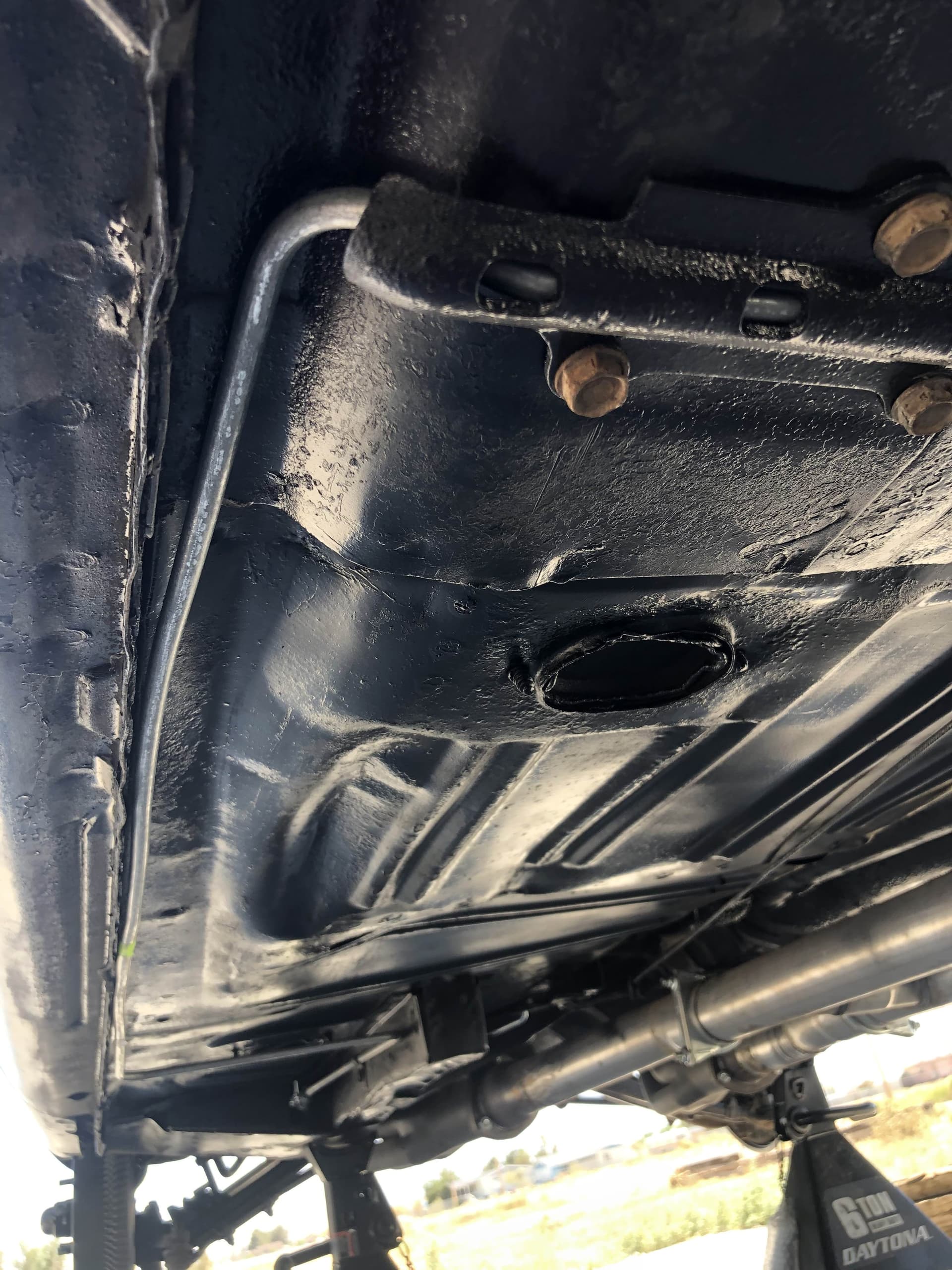

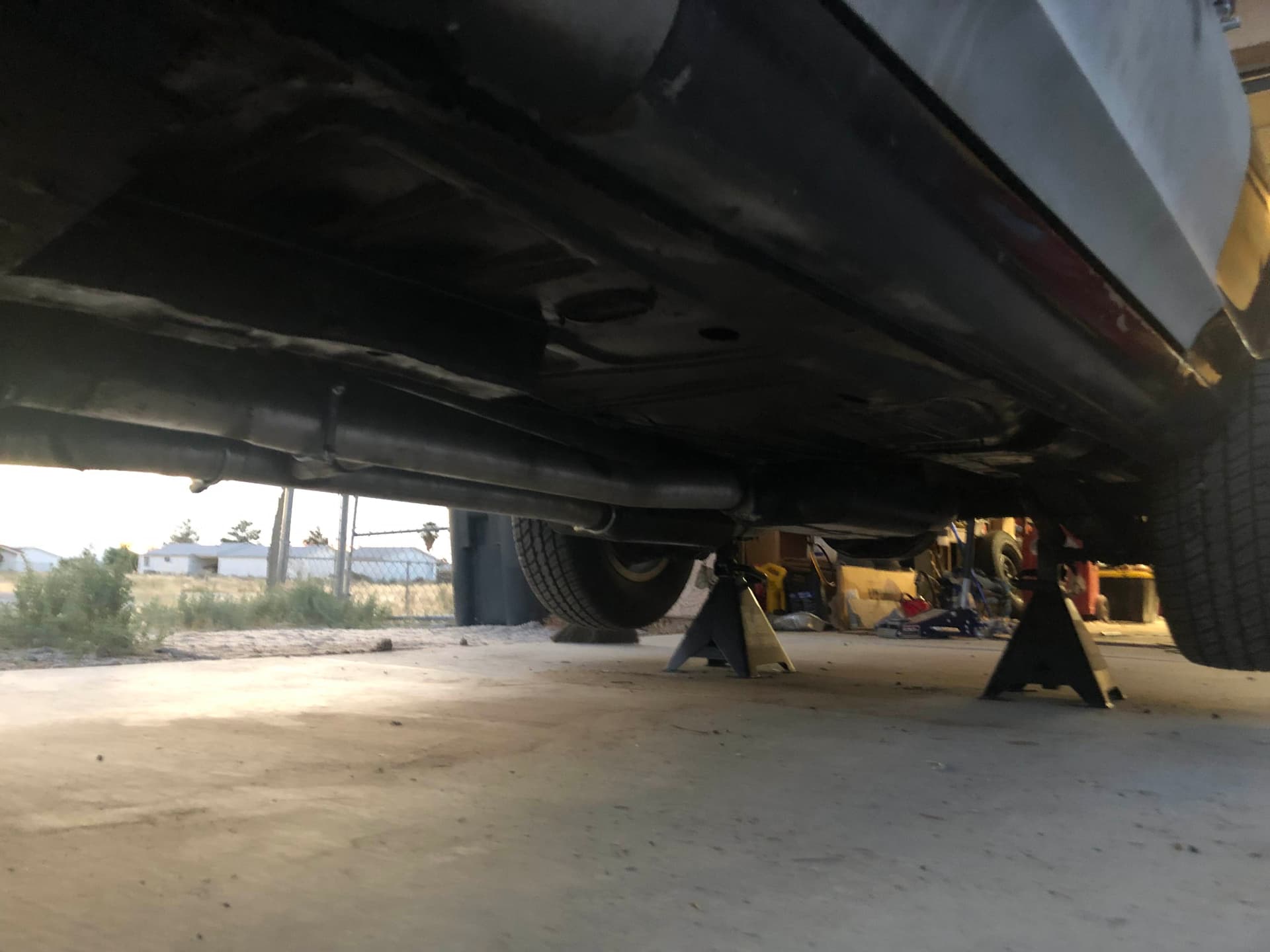

I don’t like the heat at all, but I scraped and painted the entire bottom of the car!

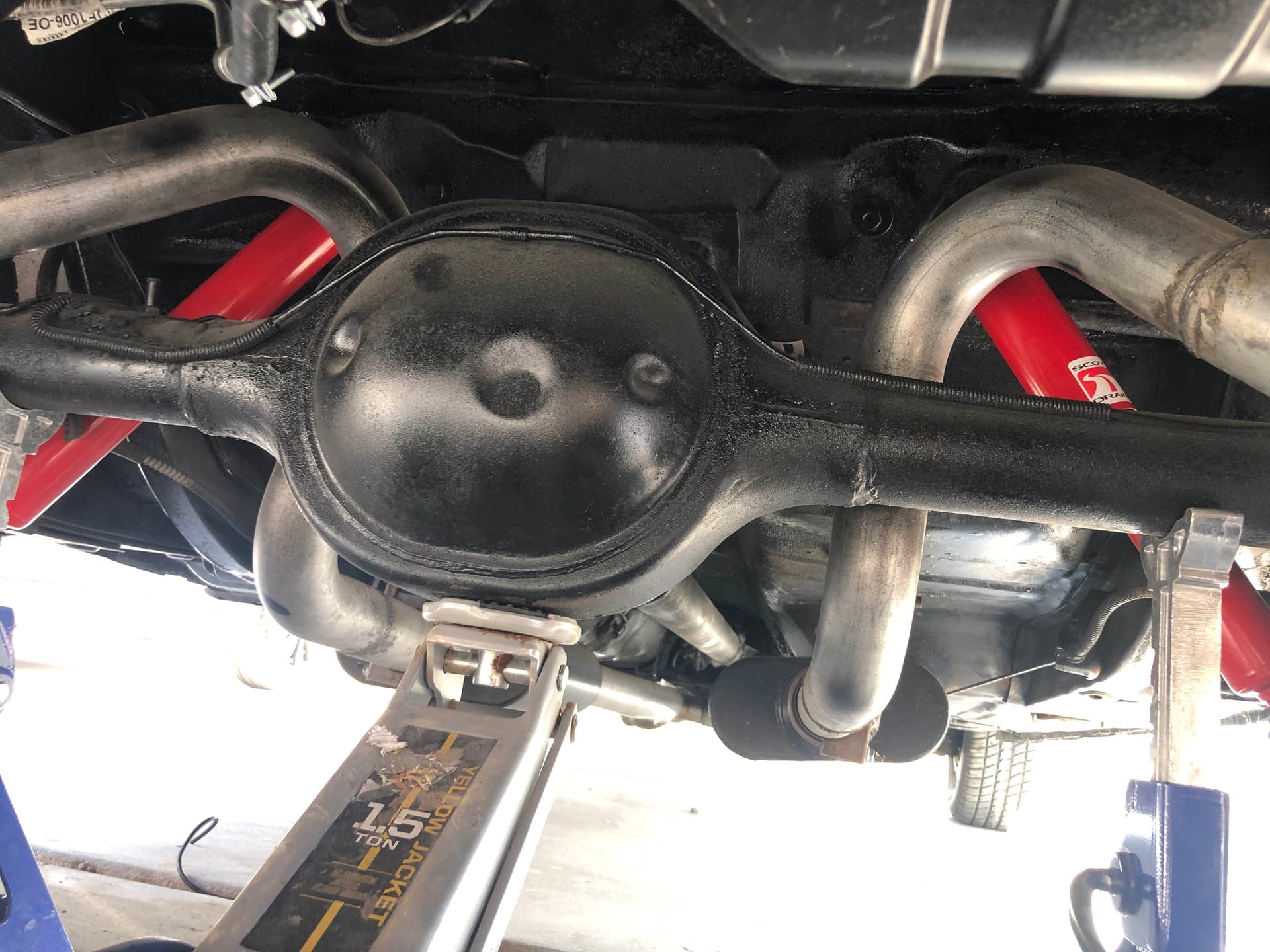

Not sure if you got an answer to this, but the yellow marks are assembly marks. If I remember correctly, my original 2.79:1 had them still on a few locations. I bought a new 3.80:1 traction lock and after a year of running still has the yellow marks from setting lash (on the teeth). You can tell your gear ratio by marking a location on your driveshaft u-joint and turning the tire one revolution and counting the revolutions of the drive shaft. For the above, one revolution equaled 2.79 turns. That should match your door data tag for gear ratio, or on your Marti report if you got one.

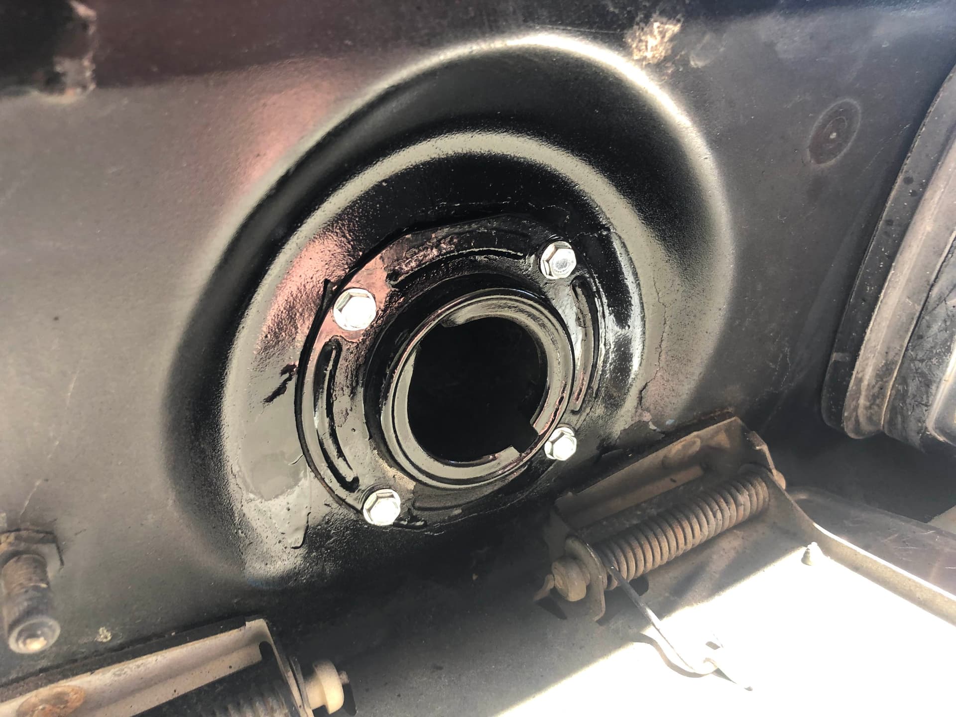

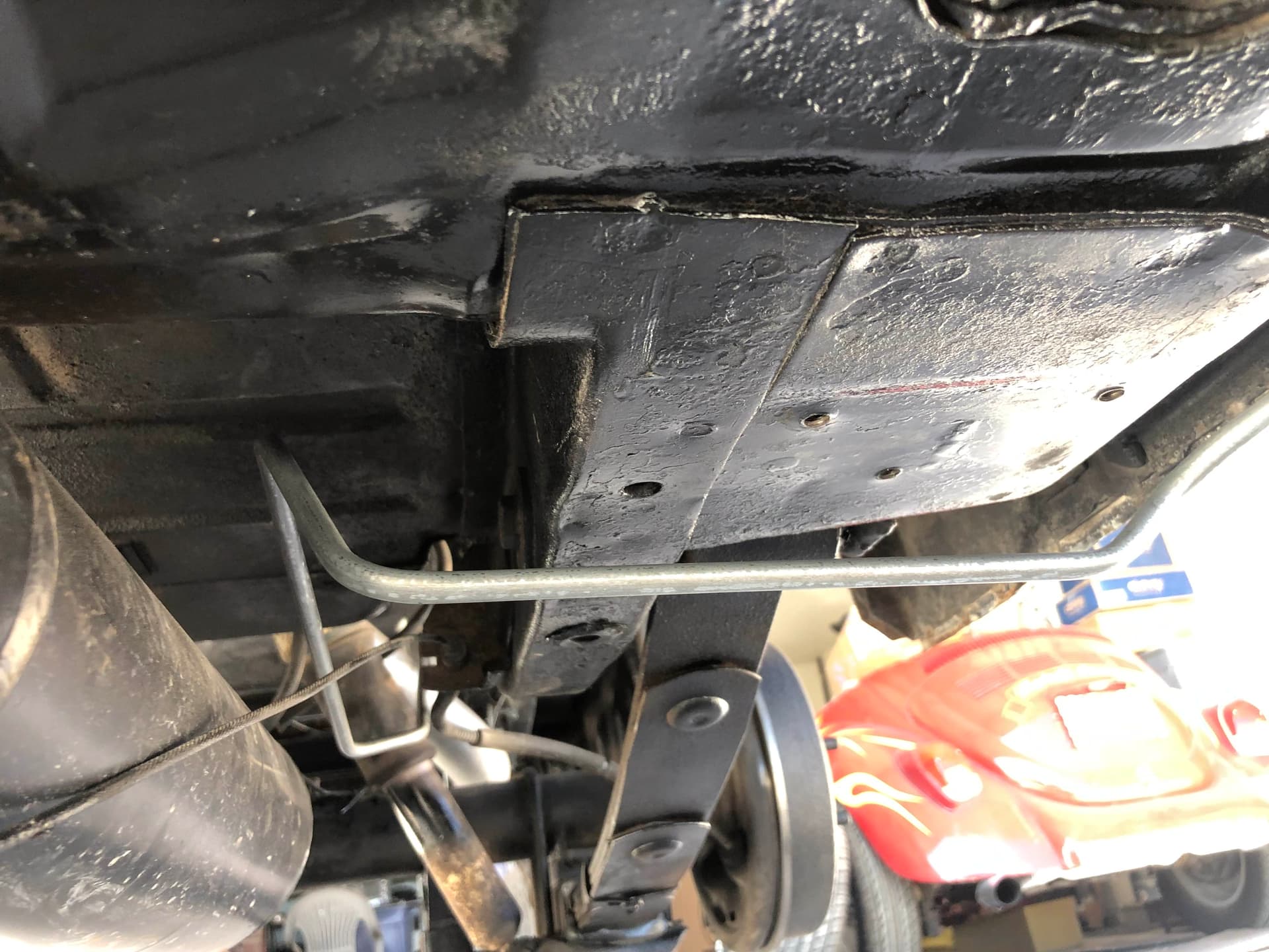

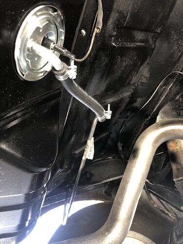

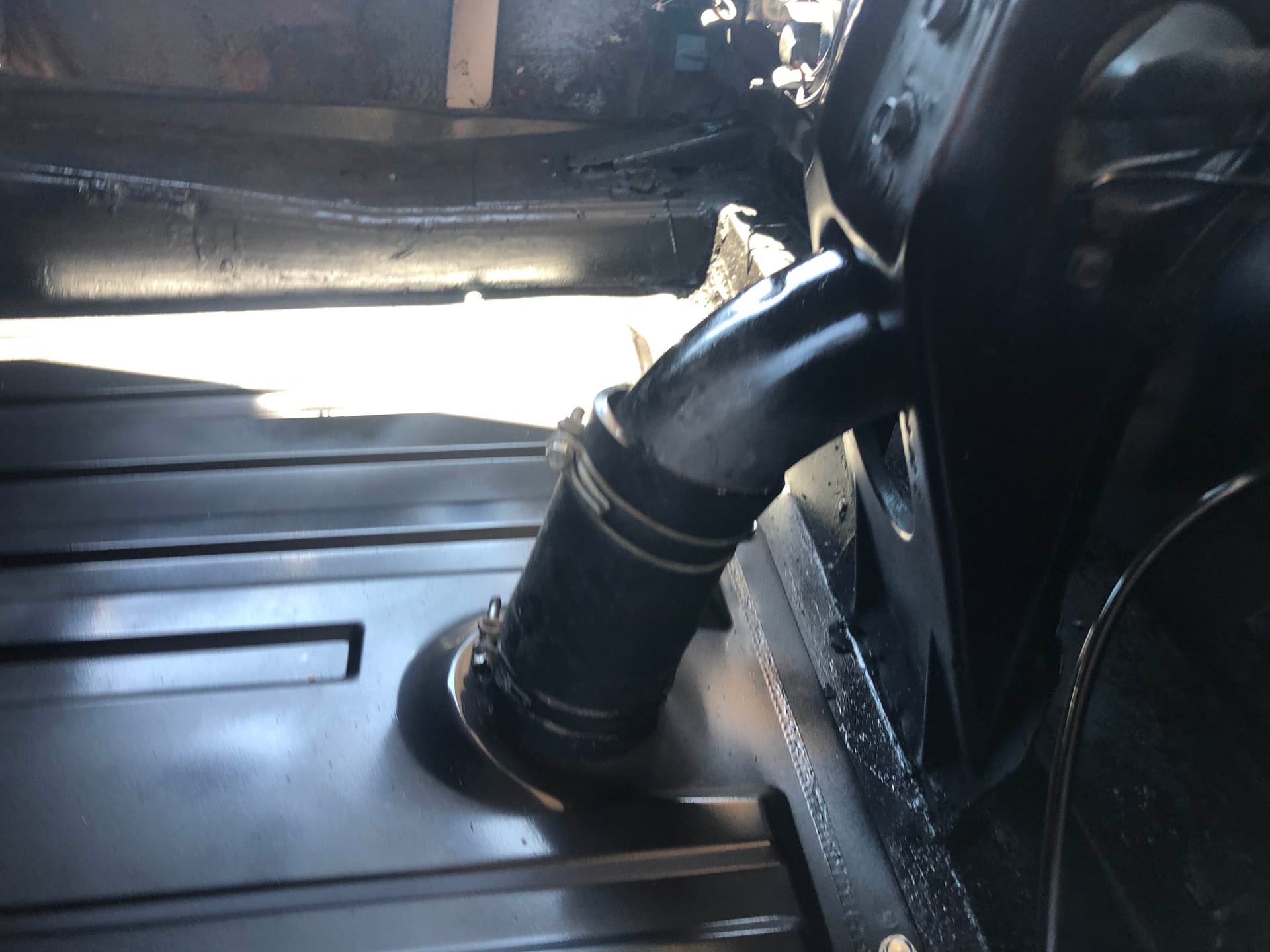

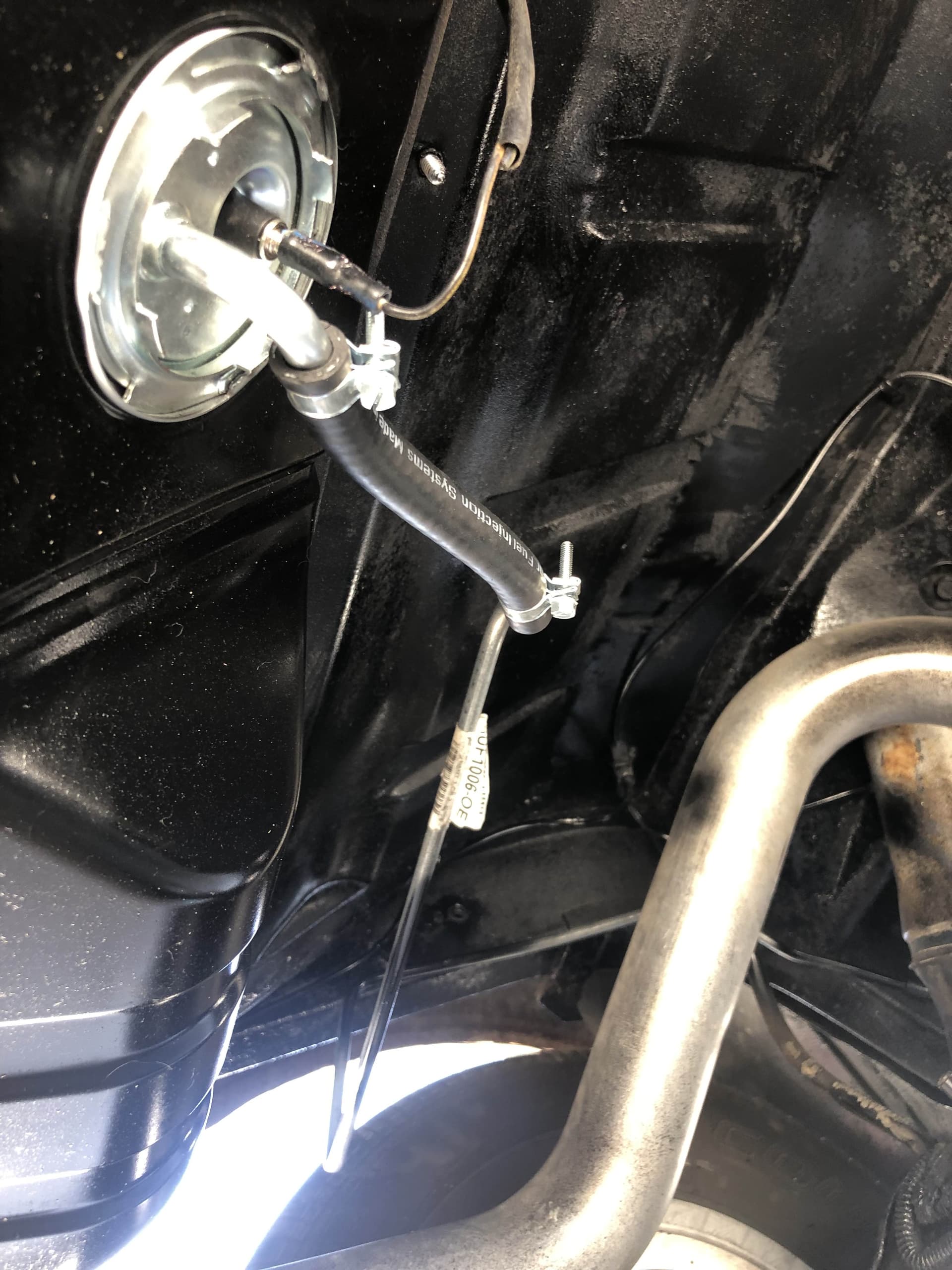

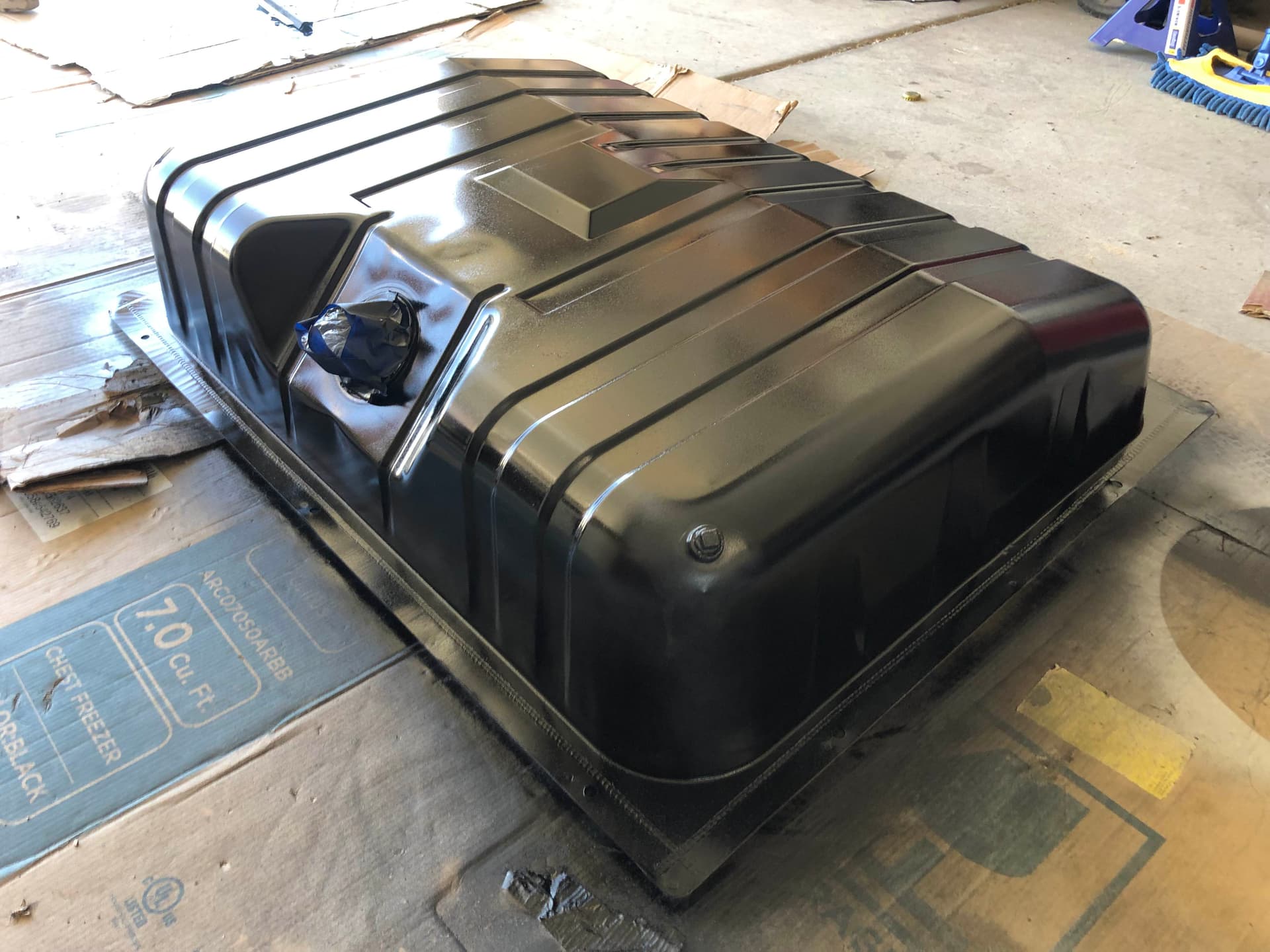

New tank and Fuel line in and all hooked up! You’ll need to take your parking brake lever off here, at what im pointing at, then take your rear wheel off and snake it in through your rear wheel well. Other than that, I did it without disconnecting anything else.
I also installed a new parking brake front cable because mine snapped. I forgot to take pictures, but it was boring.

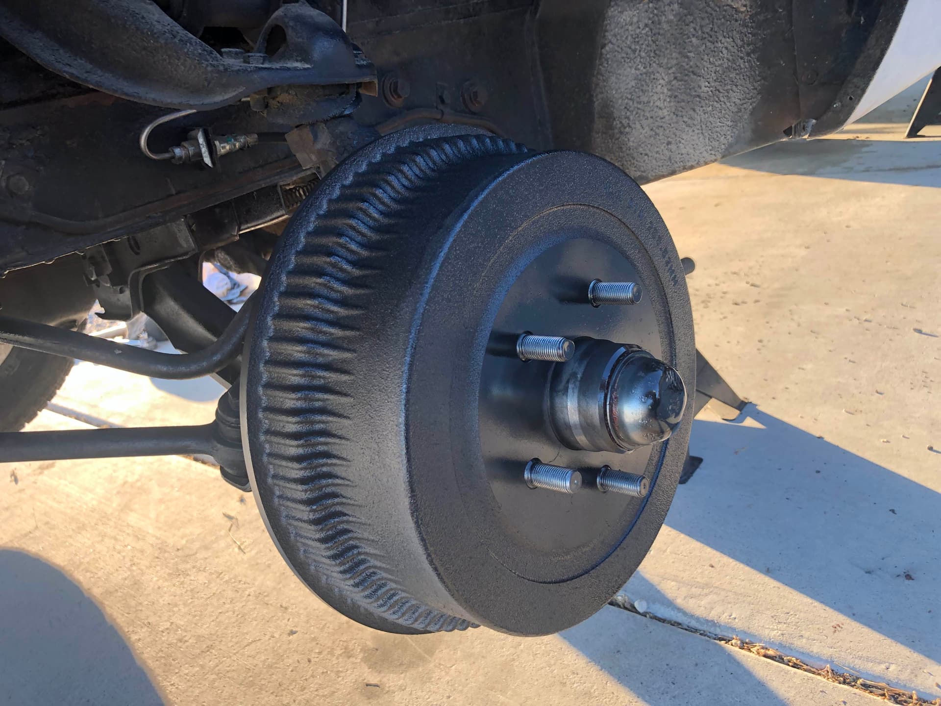

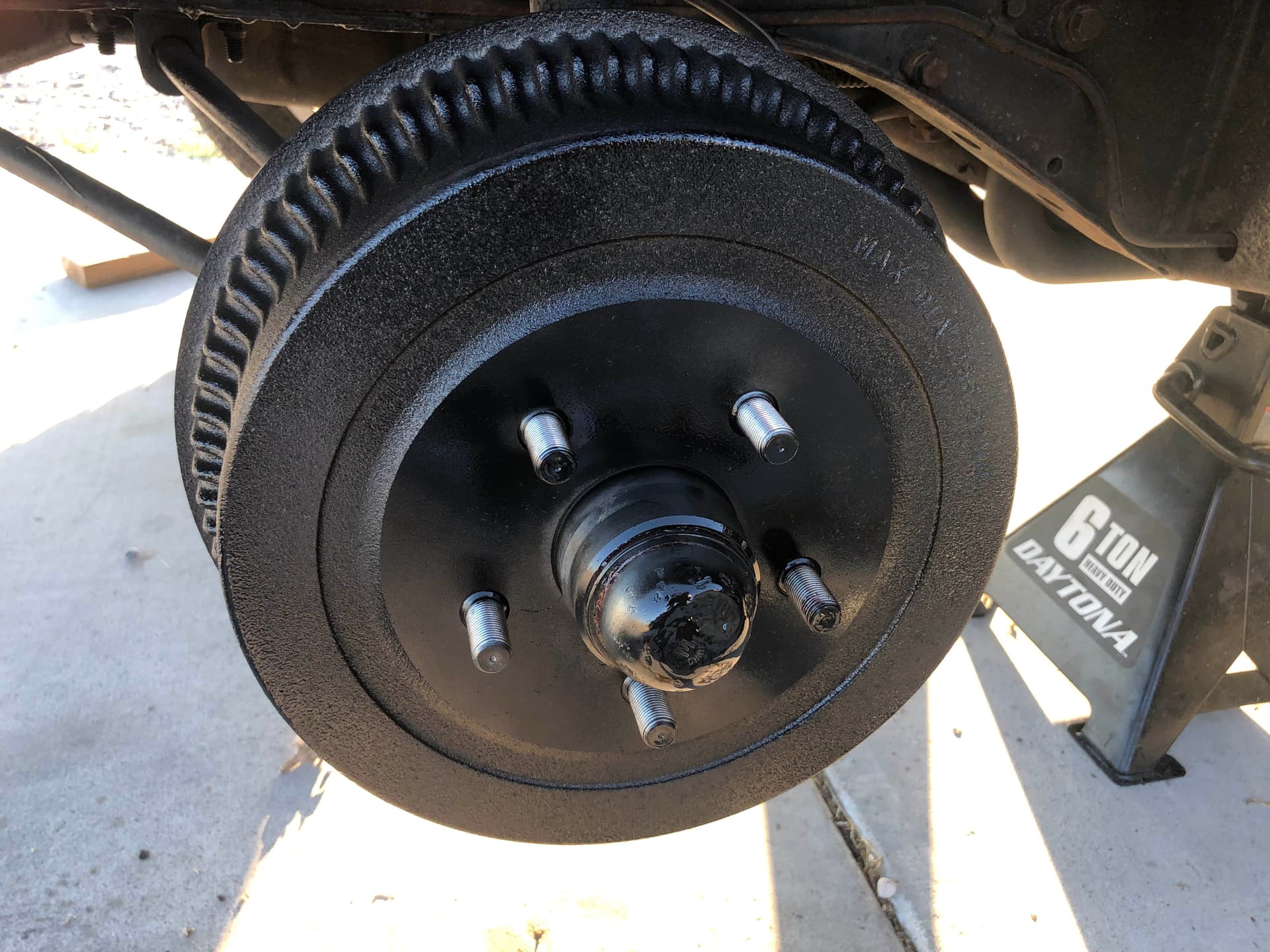

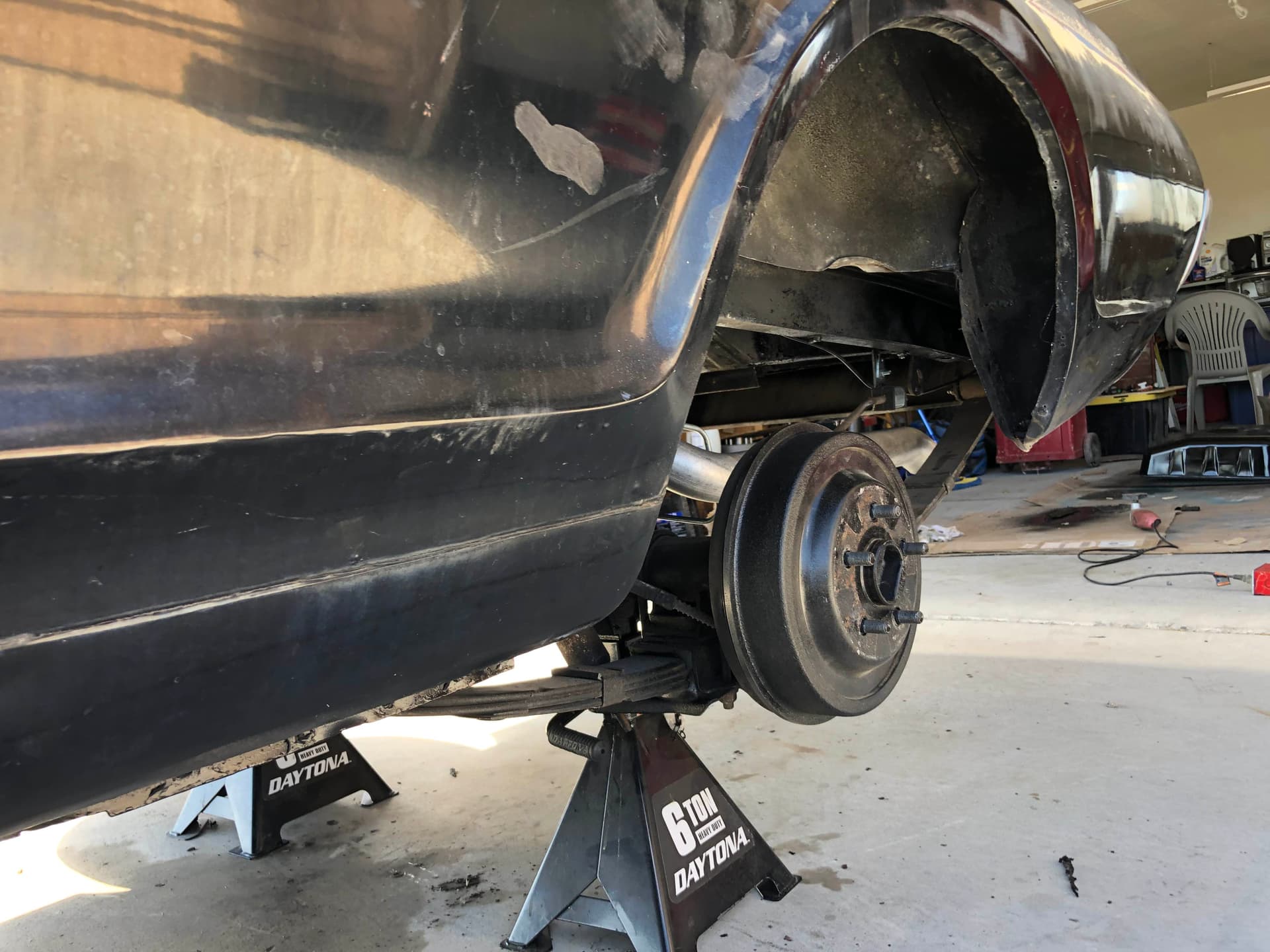

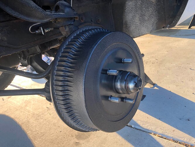

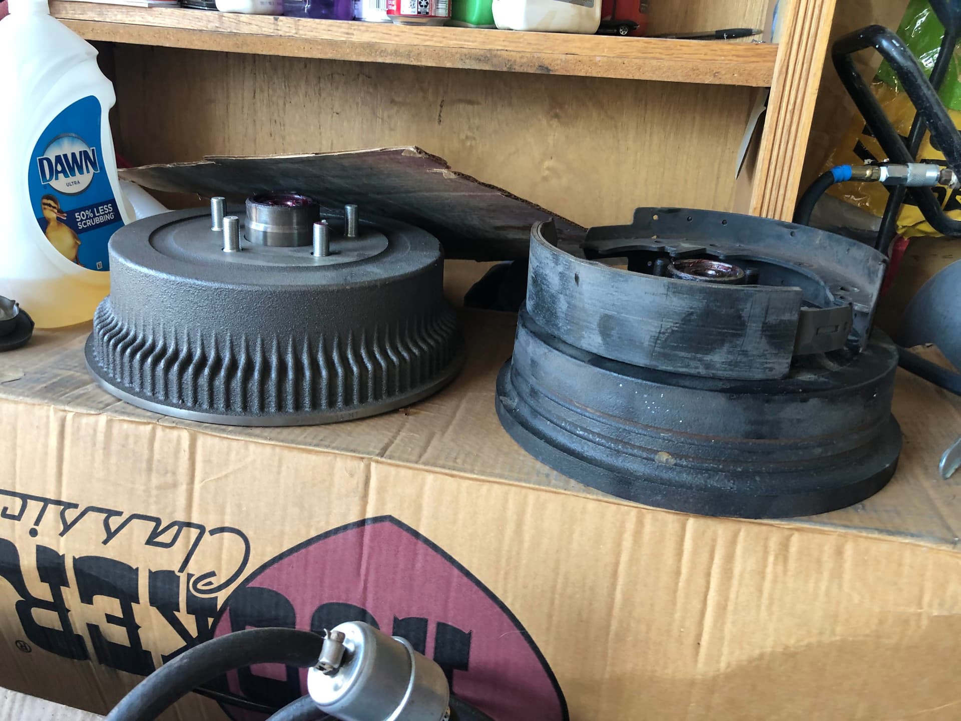

I ordered v8 front drums and brakes and they were bigger than my mixed and matched originals. They fit my spindles just fine. i re-used the original hardware because it looked good, and the parts CJ pony sent me were trash. (A decision ill either enjoy or regret, because the pins that hold the brakes in were a little short).

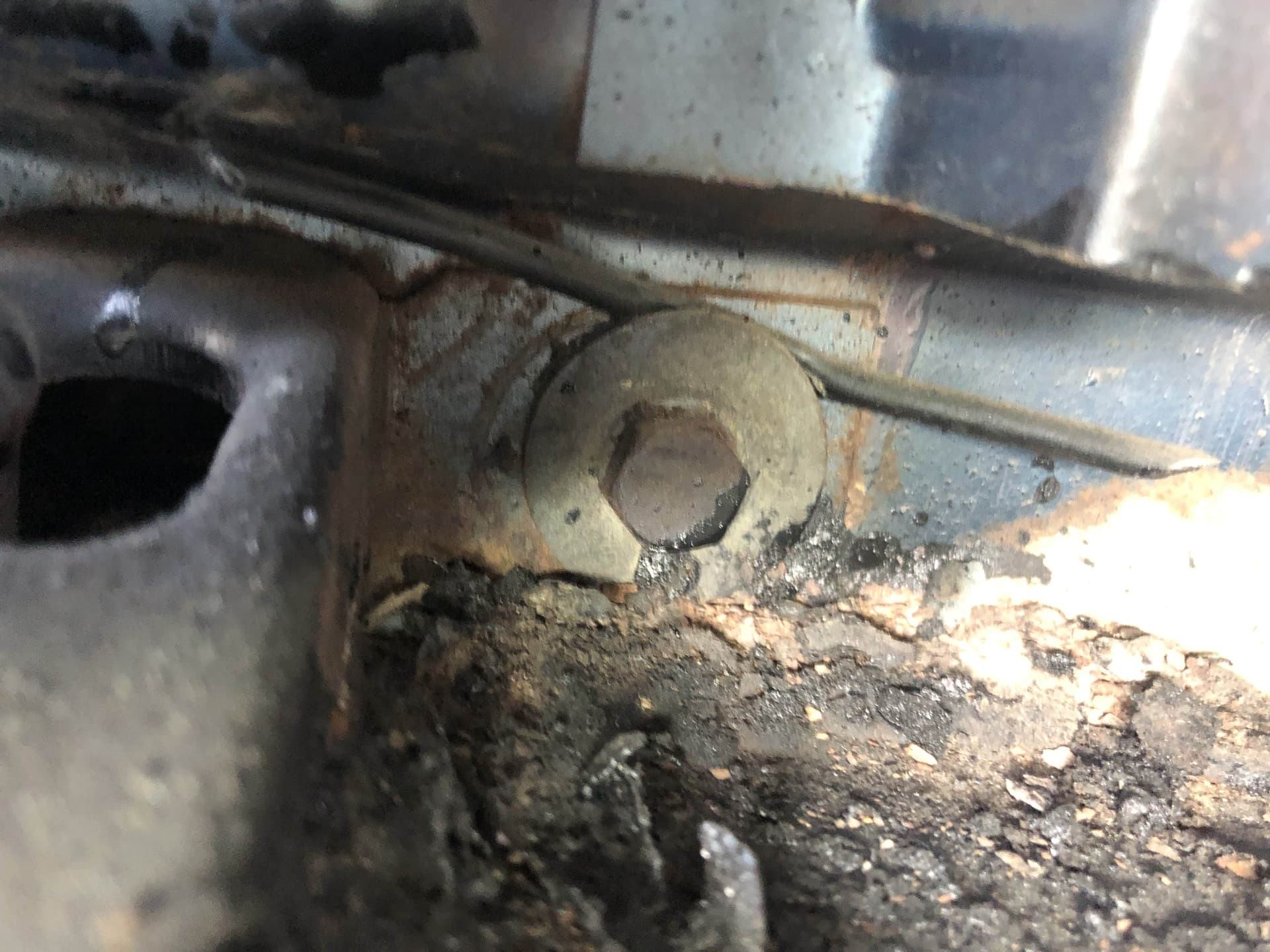

I’ve also taken the liberty to clean up my front torque thrusts!

Ah that makes sense! It could very well be the original 2.79 because I can top out at 70 in second gear! haha

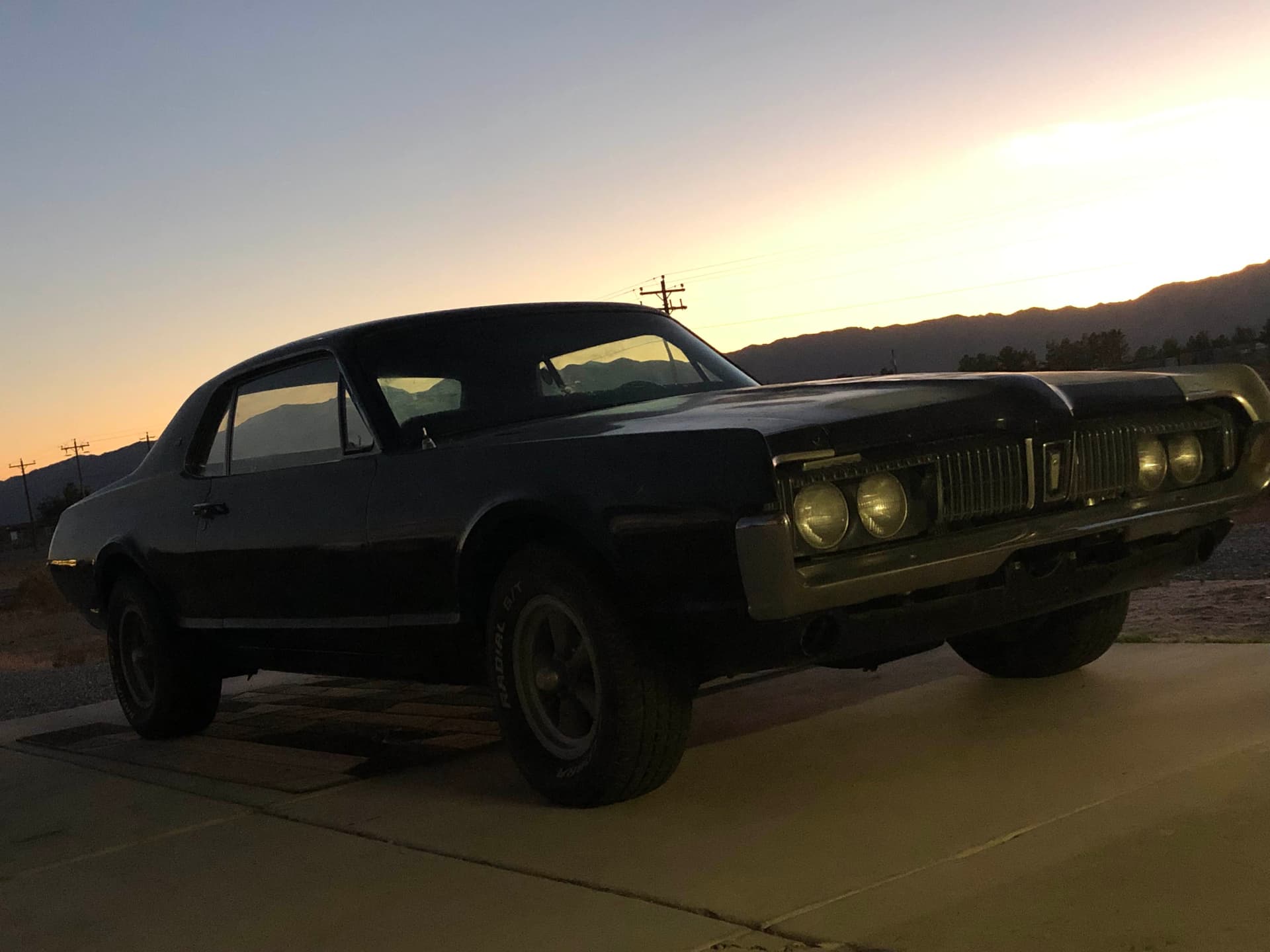

I reckon it’s time to put fuel in it!

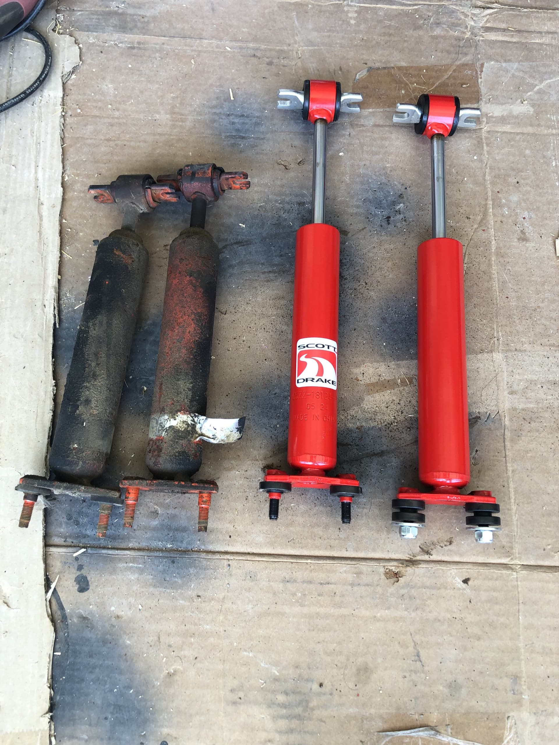

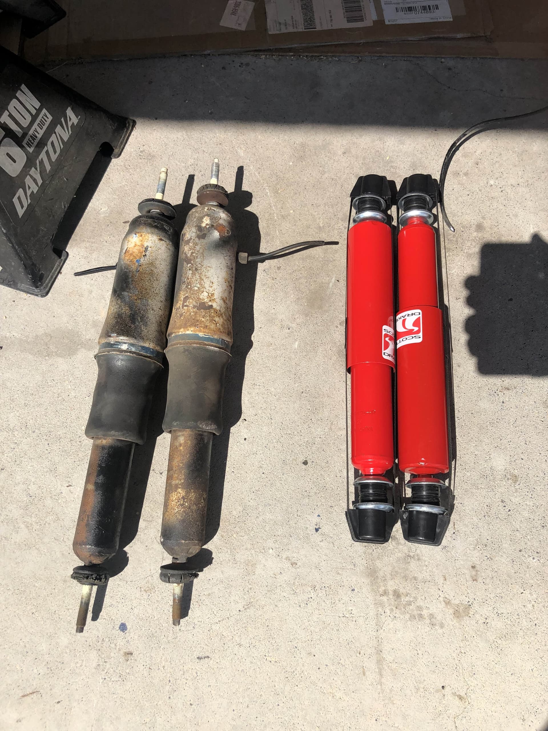

I had somebody tell me that running airshocks is bad for the trunk floor so I picked up a set of gucci shocks!
I also found out why I couldn’t air them up, somebody (probably me), crimped the air line in the bumper bolt (probably for the better lol)

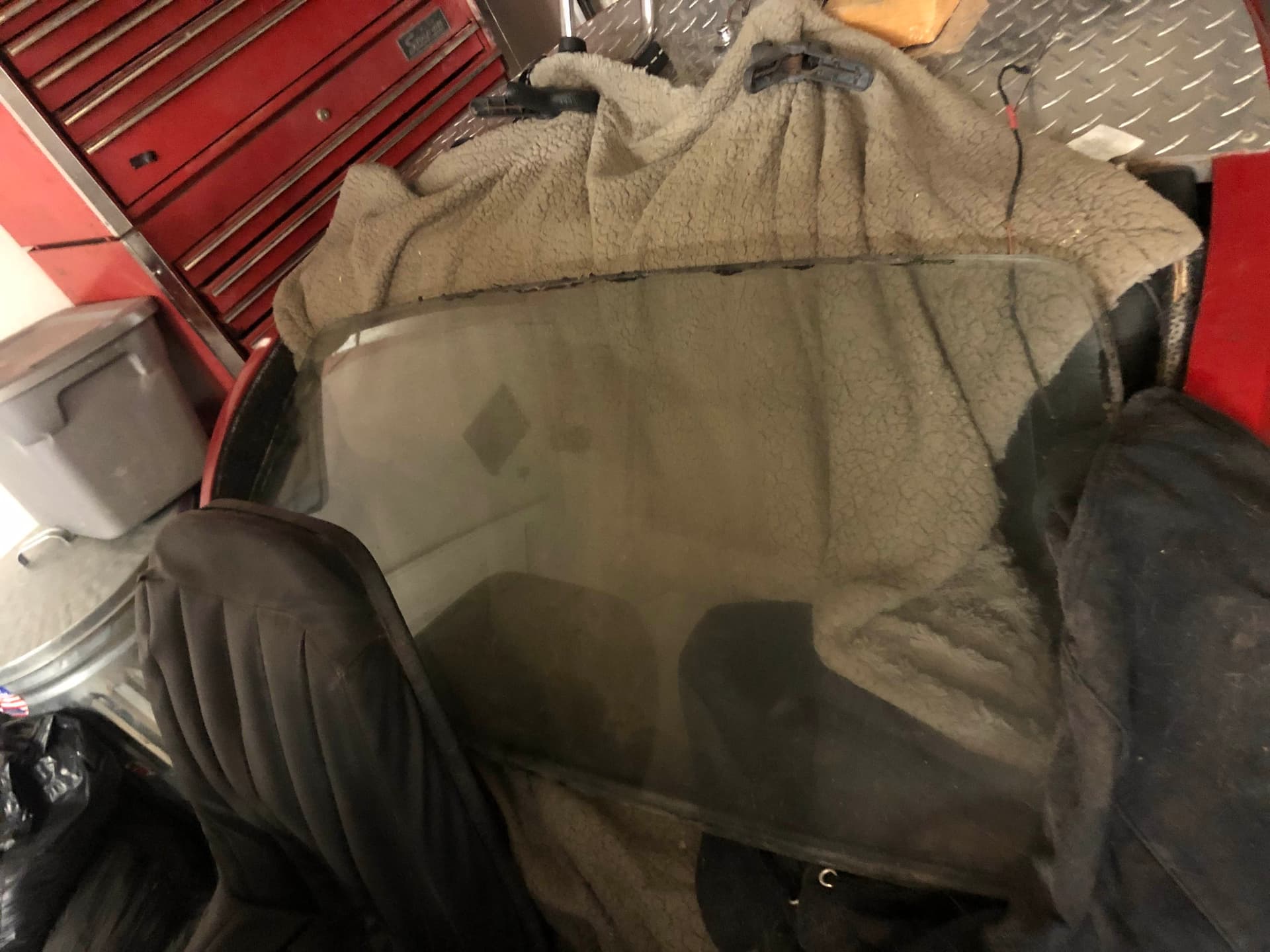

So if you’ve been following along, my driver’s side quarter glass has been kinda hanging in there because it came off the track.
Window finally rolls up and down!

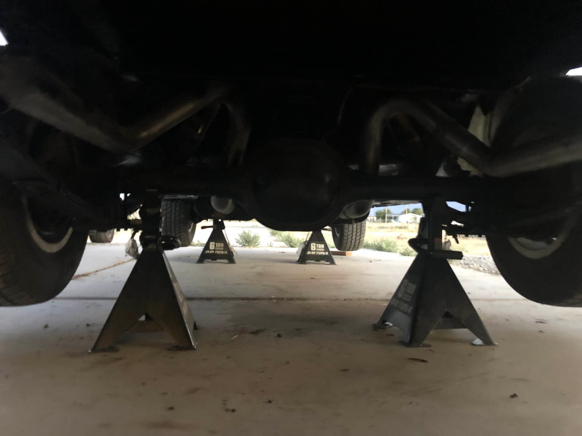

I got the front shocks in aswell!
If you want to turn your cougar into a mustang, try taking a corner fast with blown front shocks and brand new rear shocks!

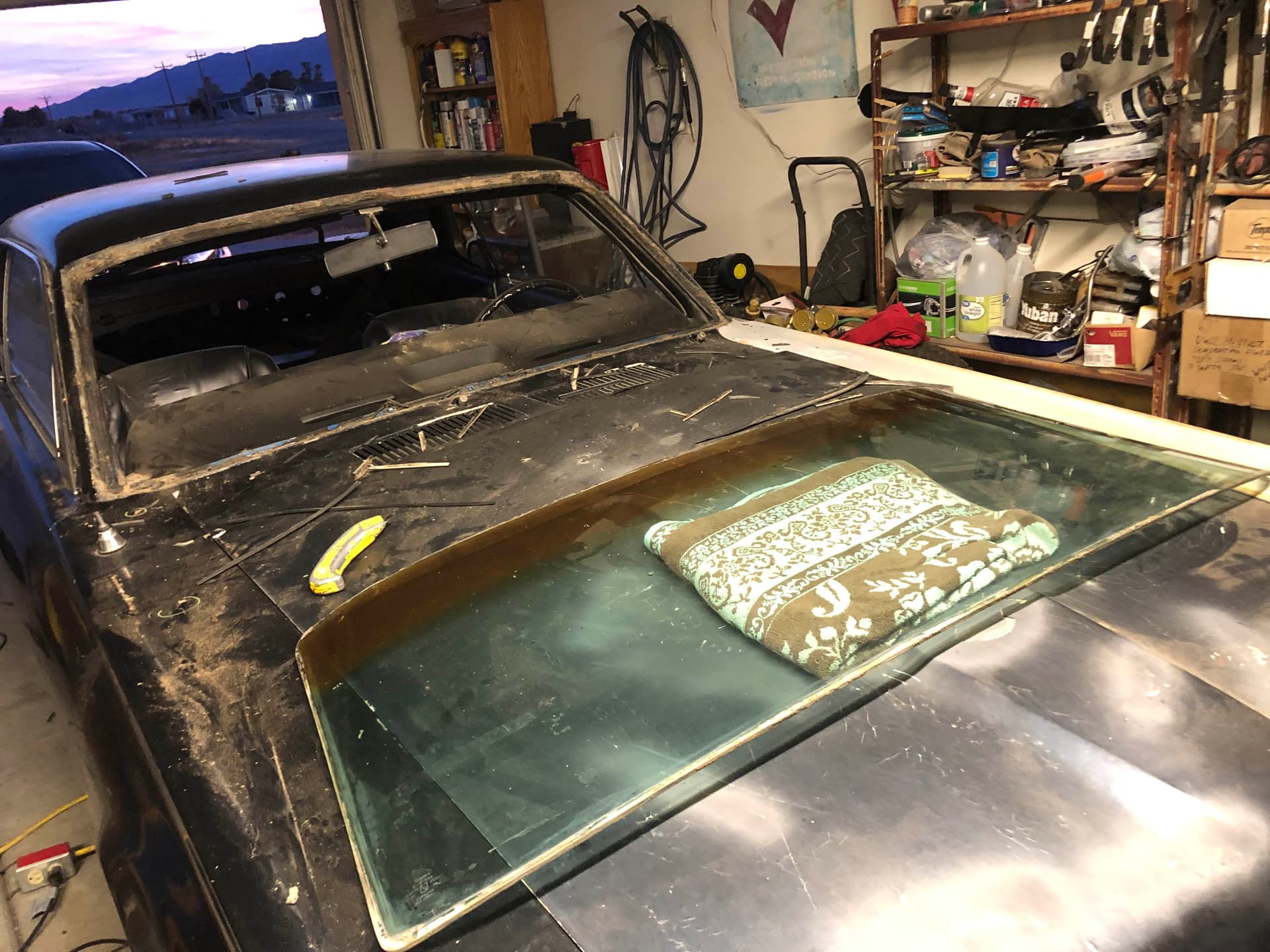

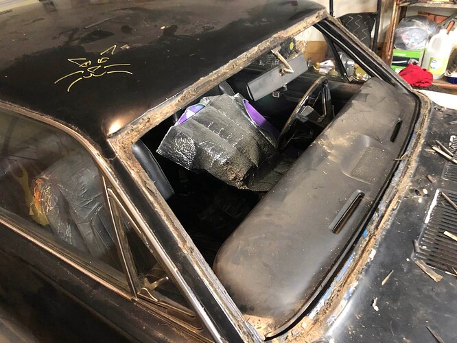

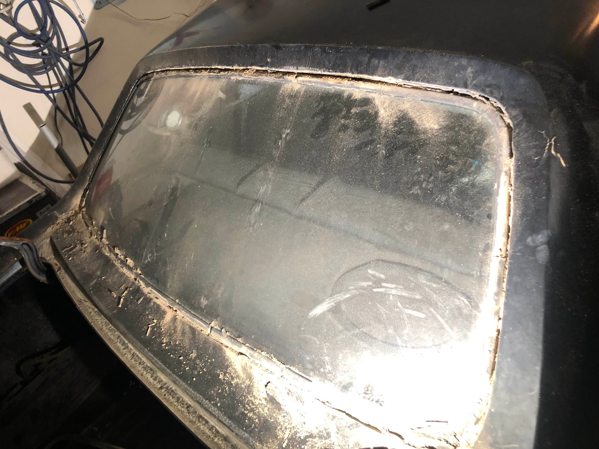

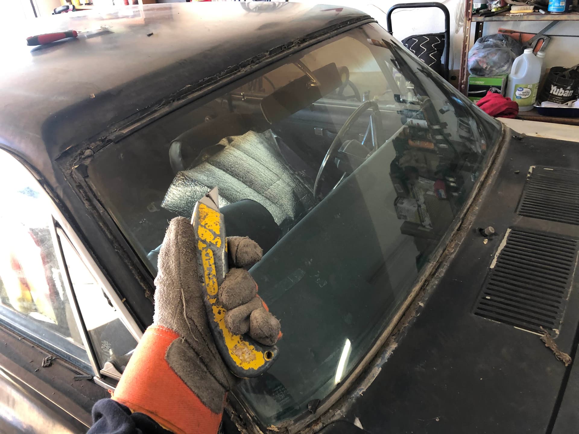

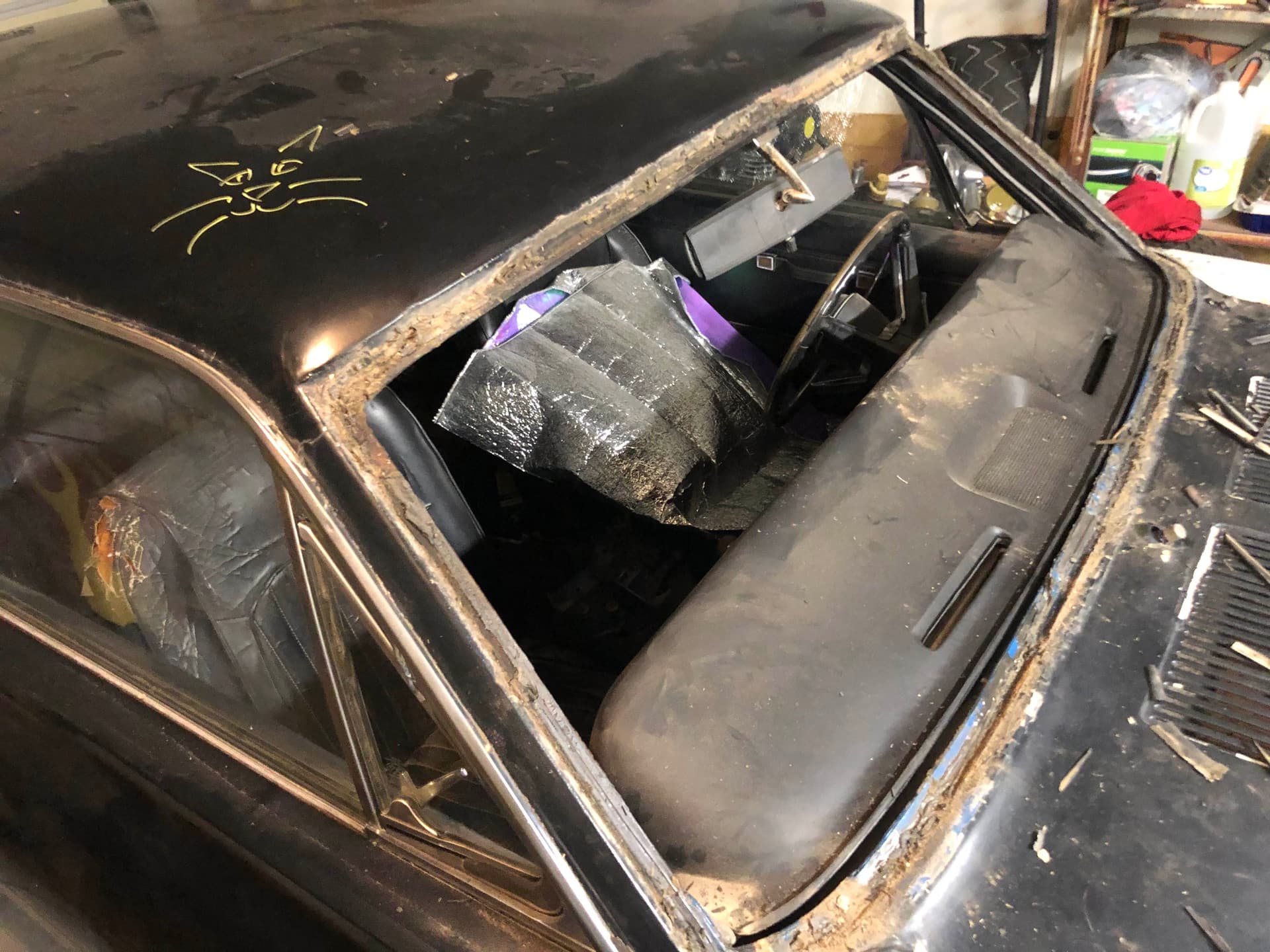

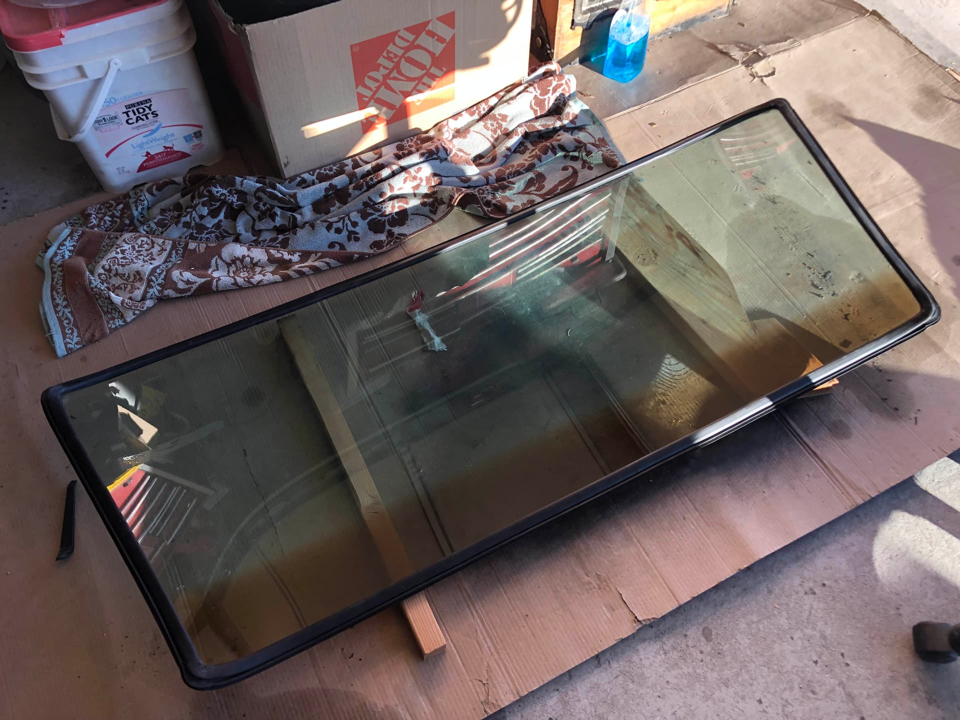

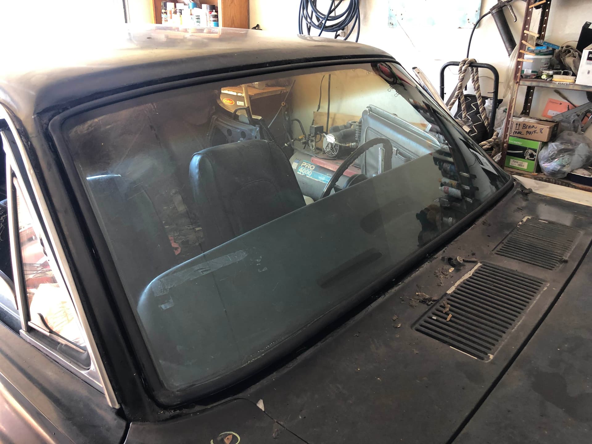

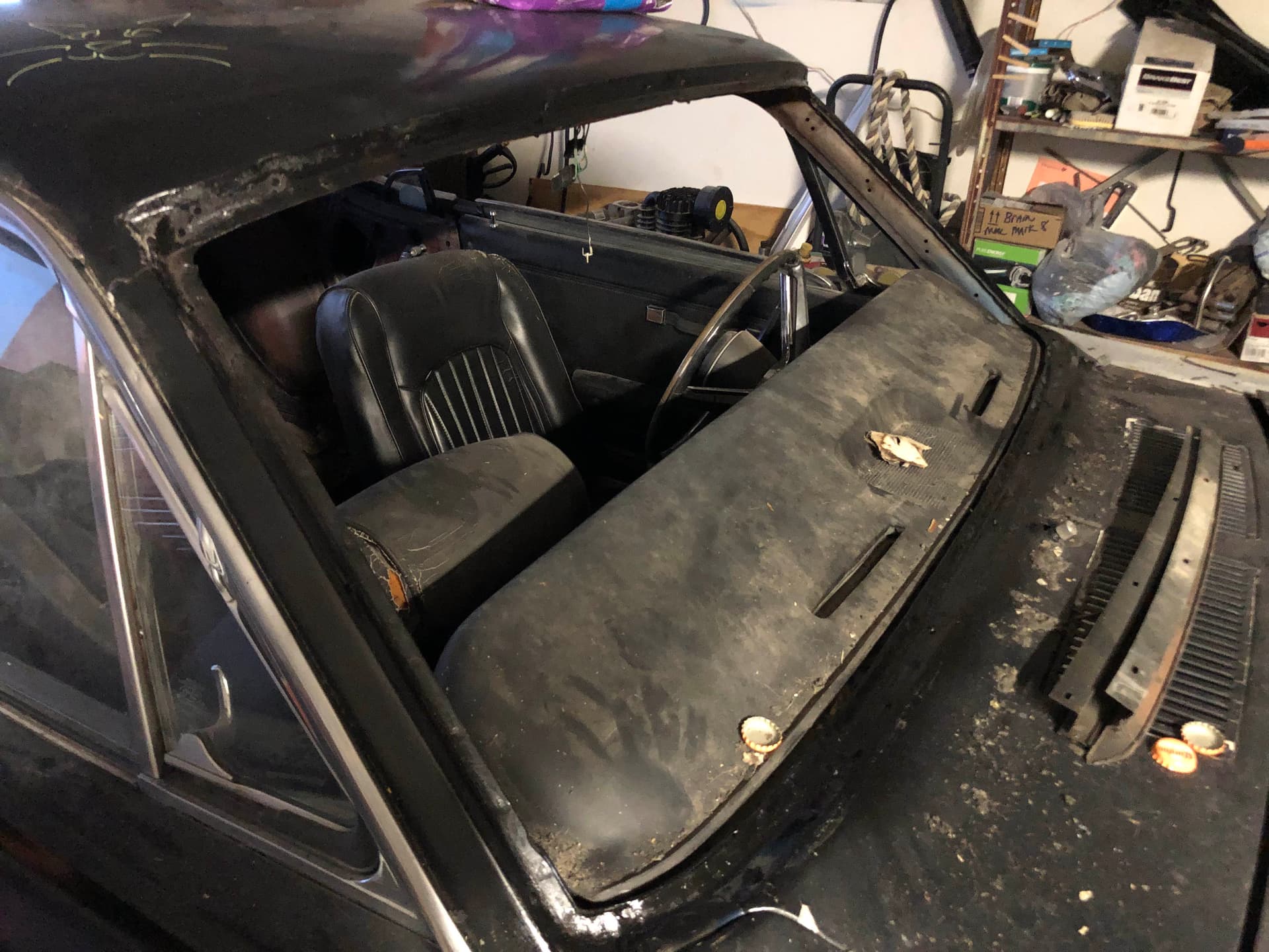

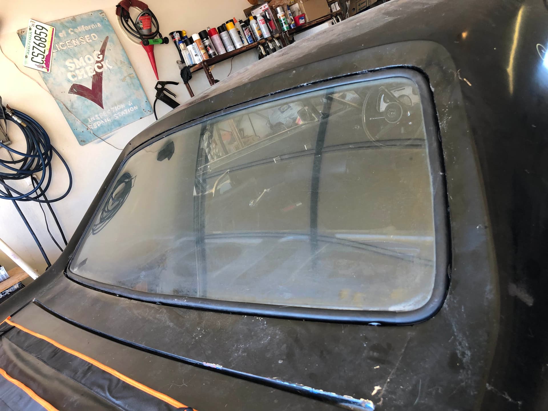

Celebrating a successful front windshield removal this evening!

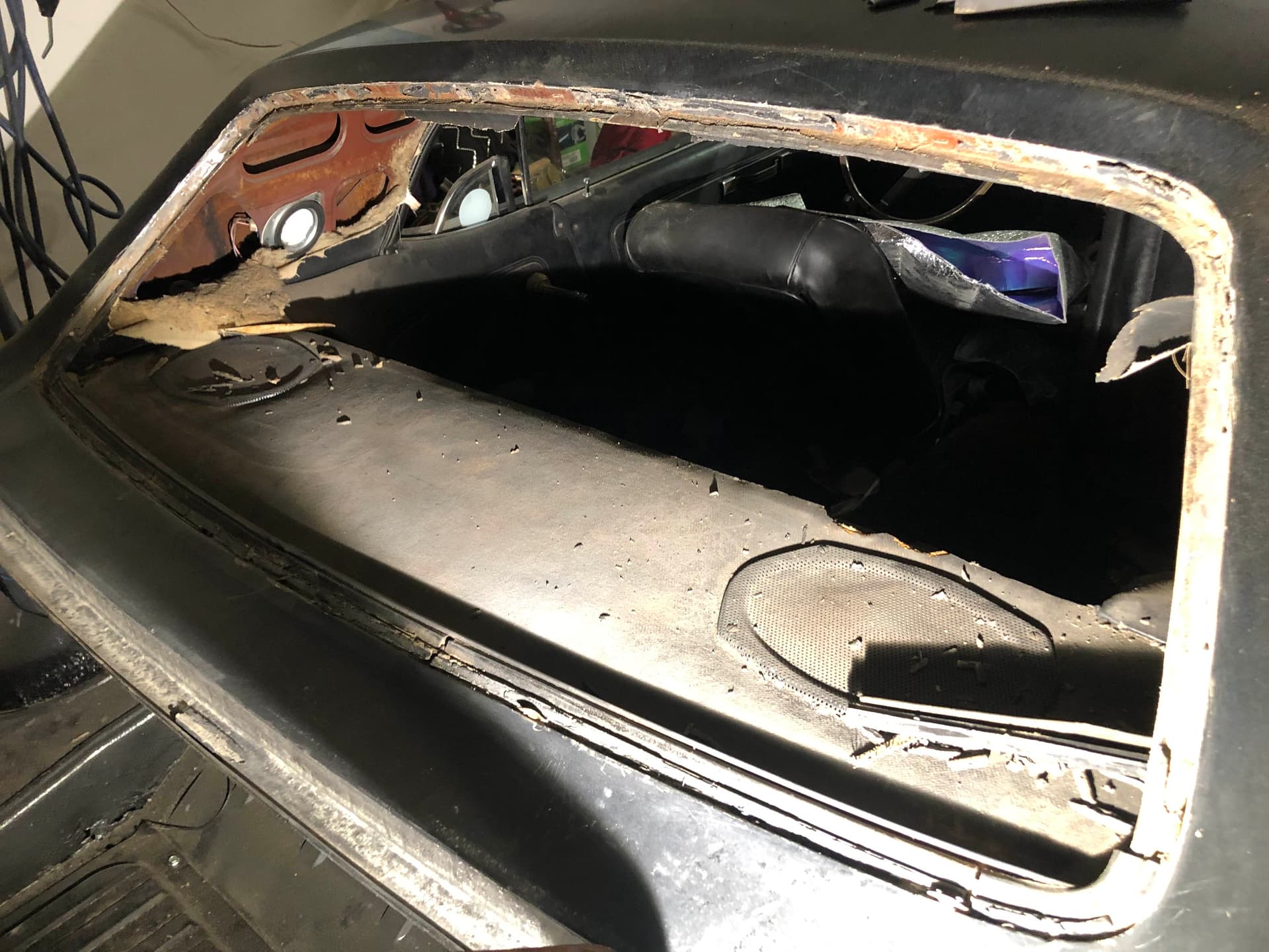

I carefully cut it out with a boxcutter until i could gently lift it out. The window lips look amazing, i thought for sure i was going to need to do rust repair but they’re all there.
Stay tuned!

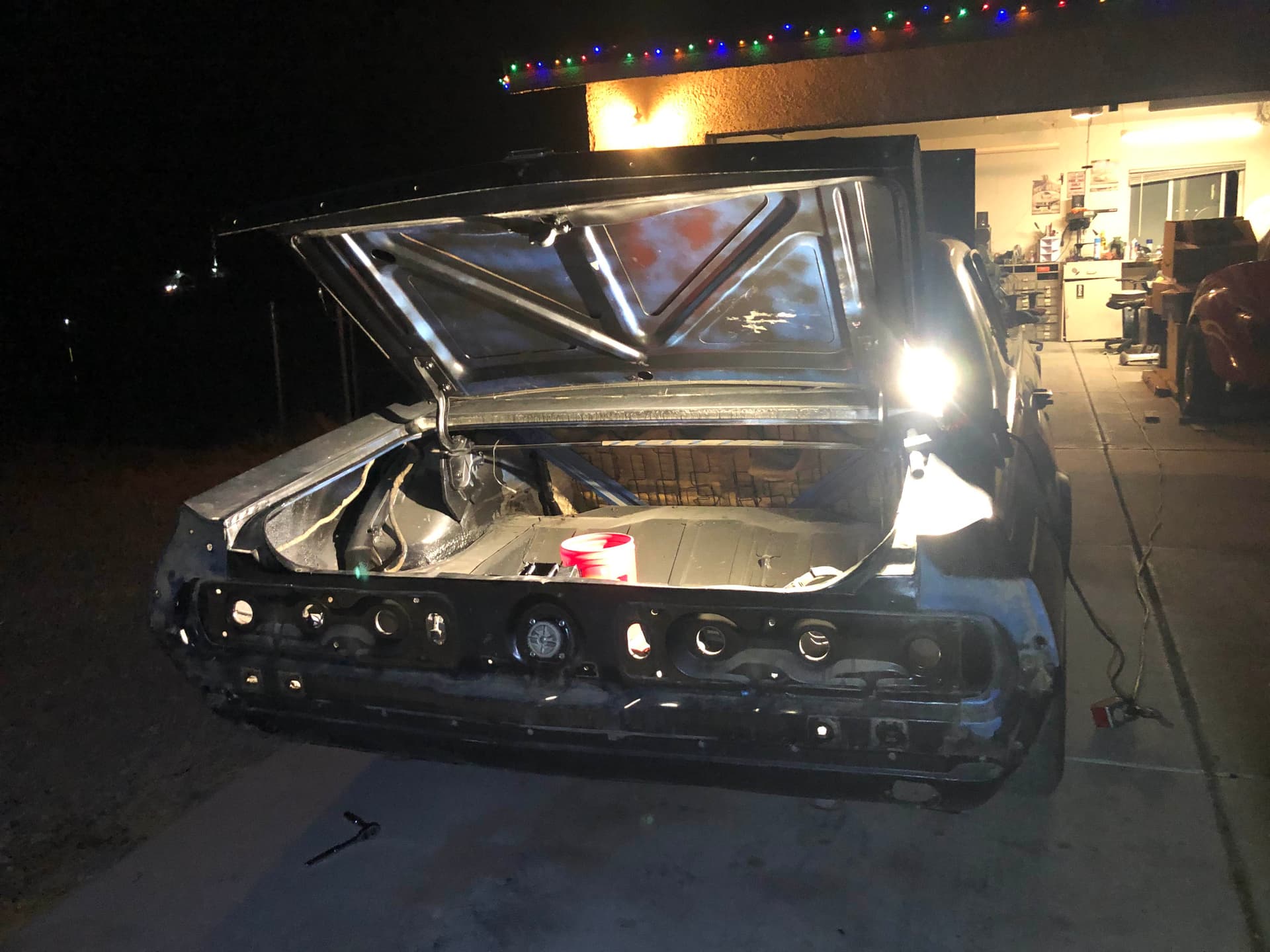

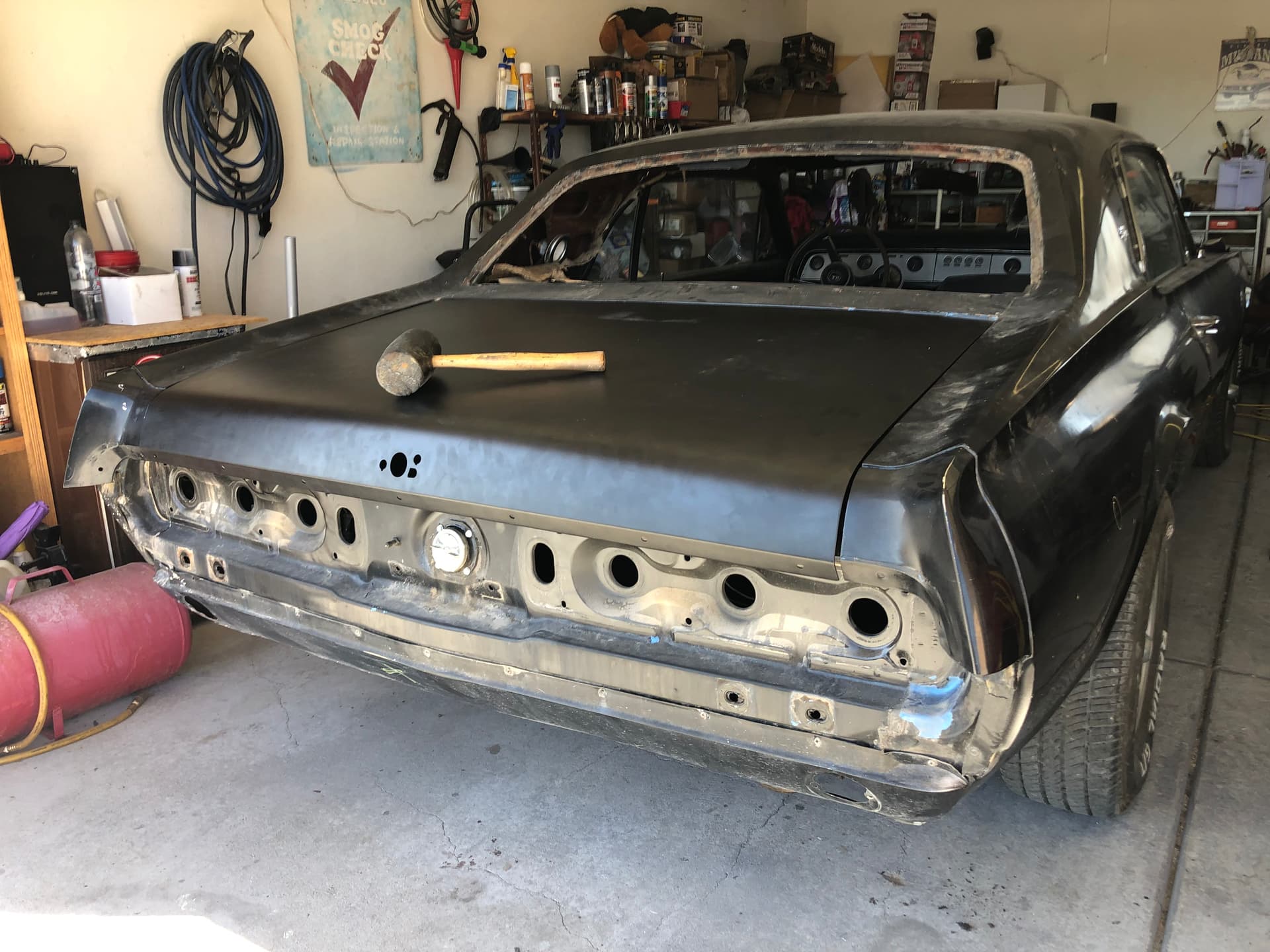

Firstly, new trunk lid!

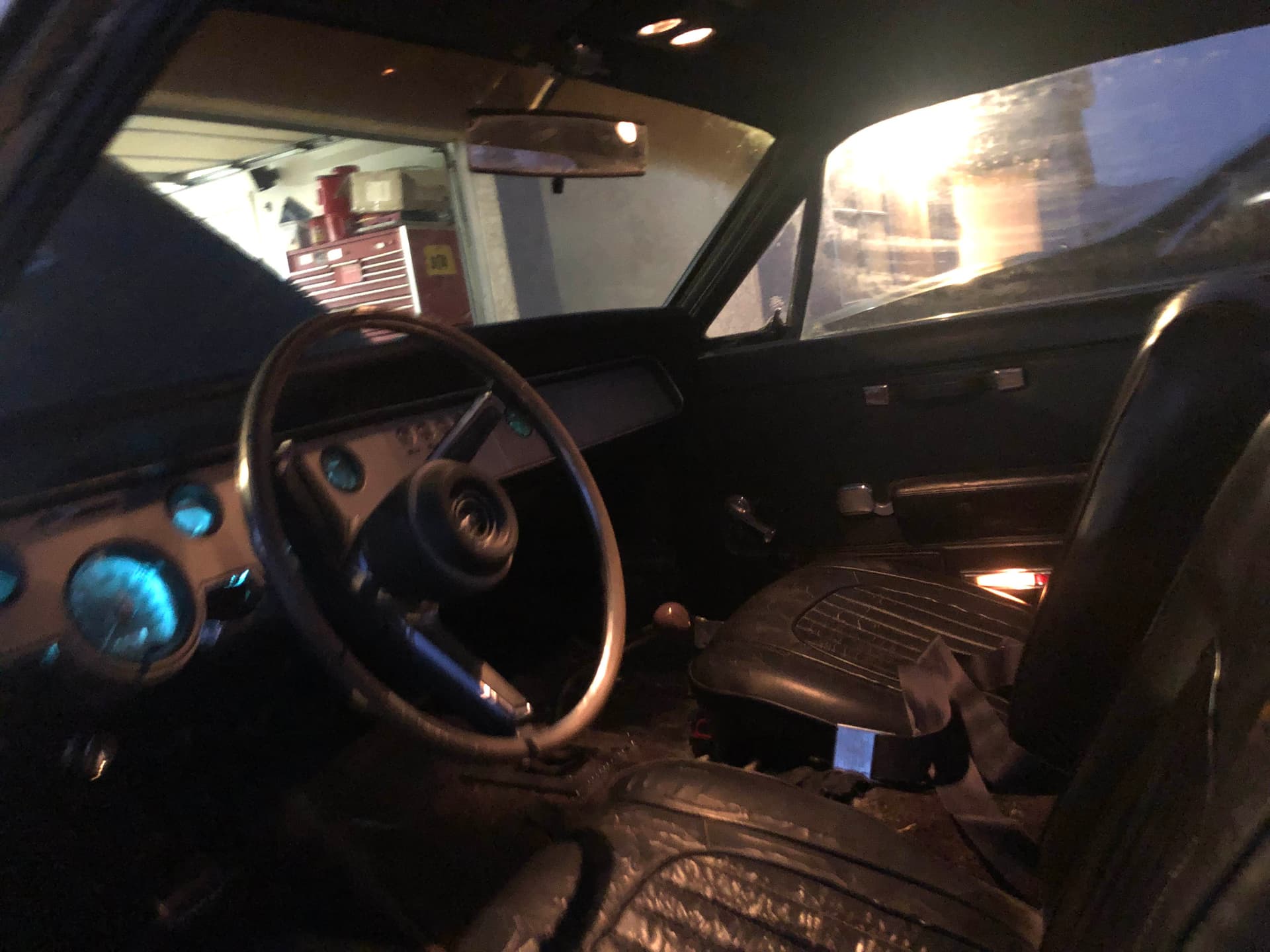

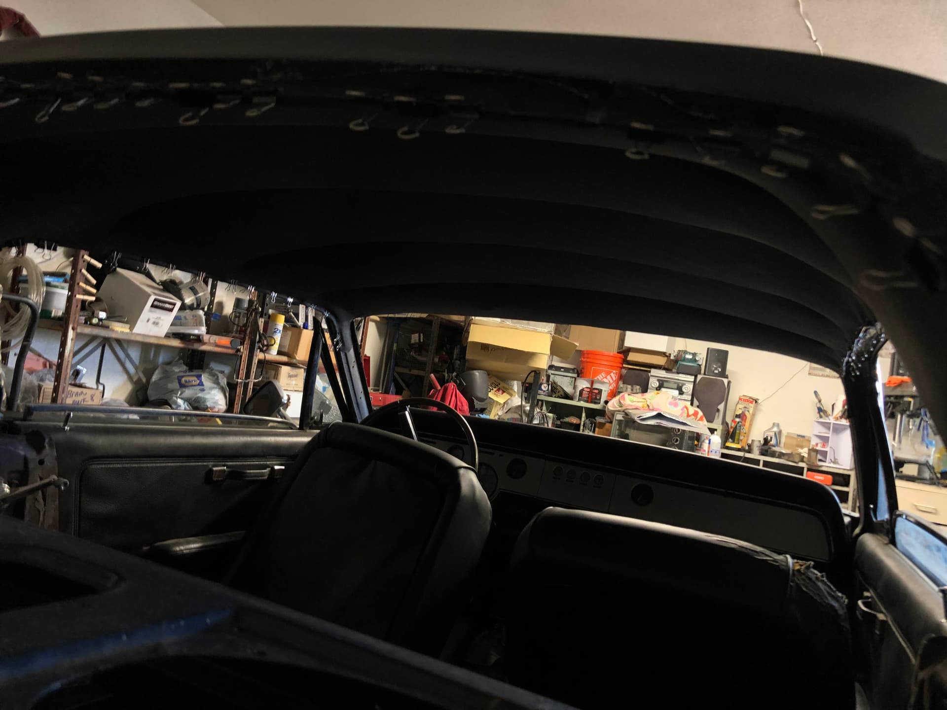

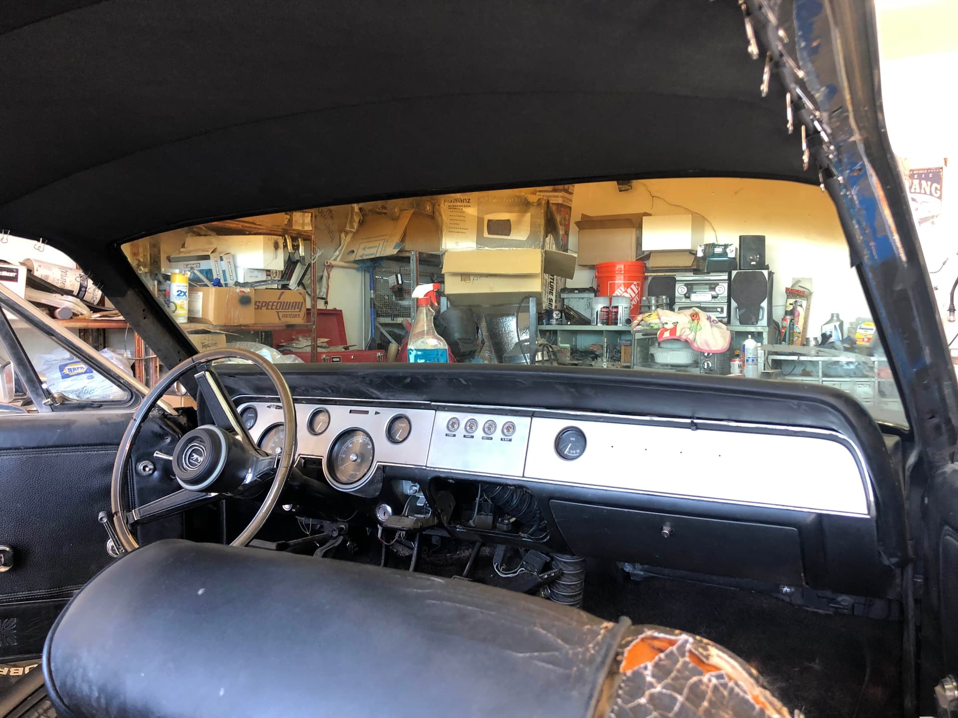

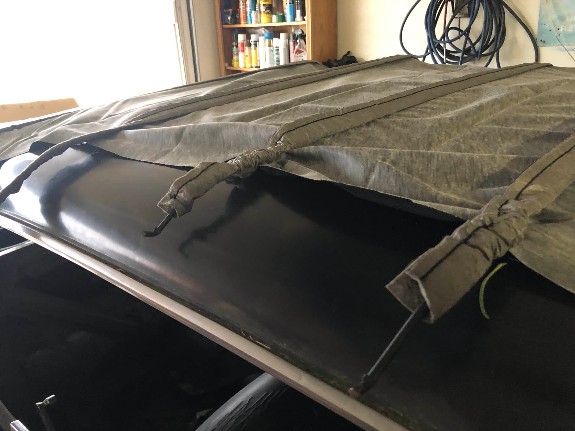

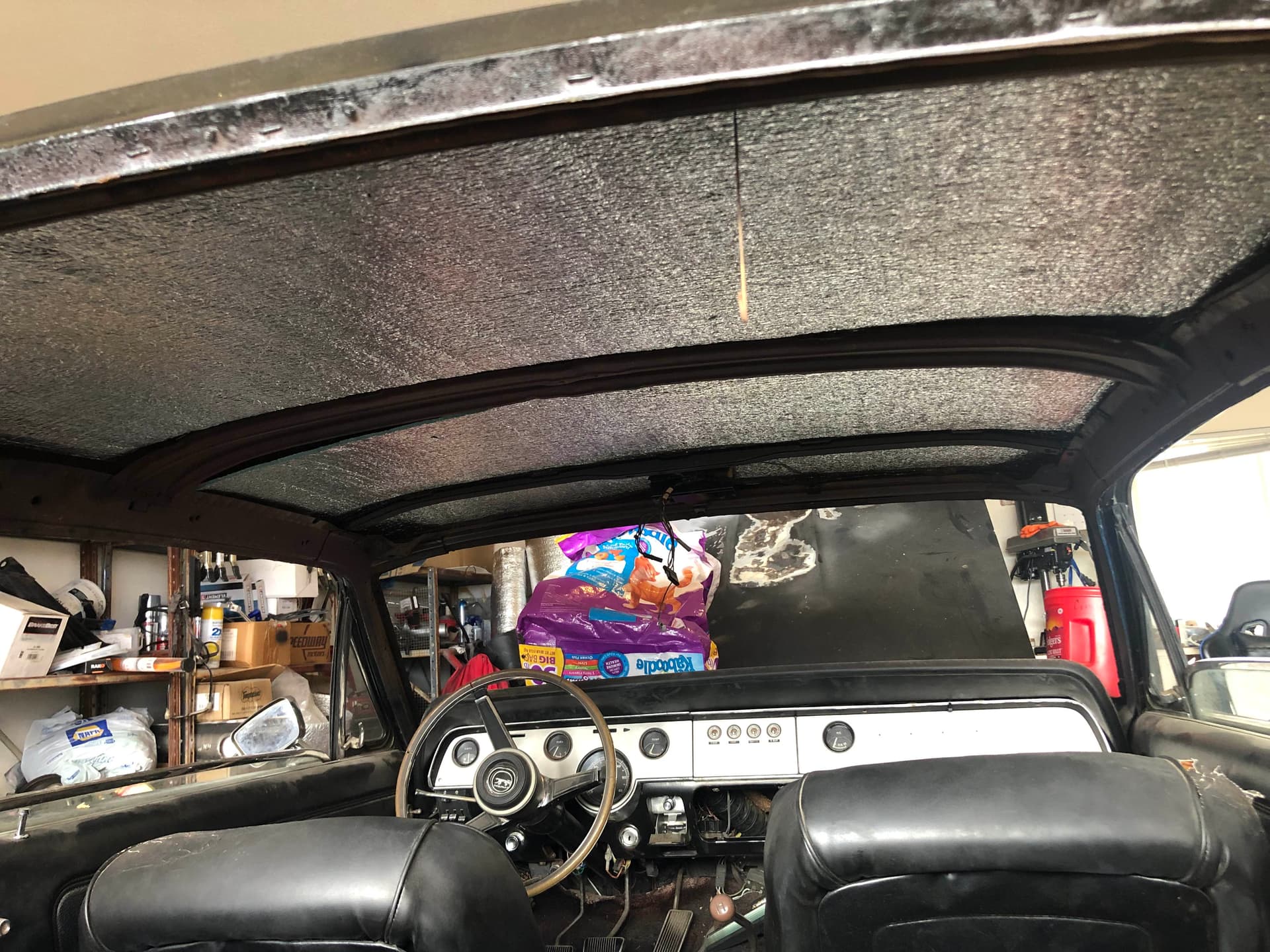

Cleaned up the window lips and did tons of prep work for the headliner. Got lucky as nothing was rotted out there. I’m doing the paint backwards but I want to drive the car as im doing bodywork, because that will take the longest.

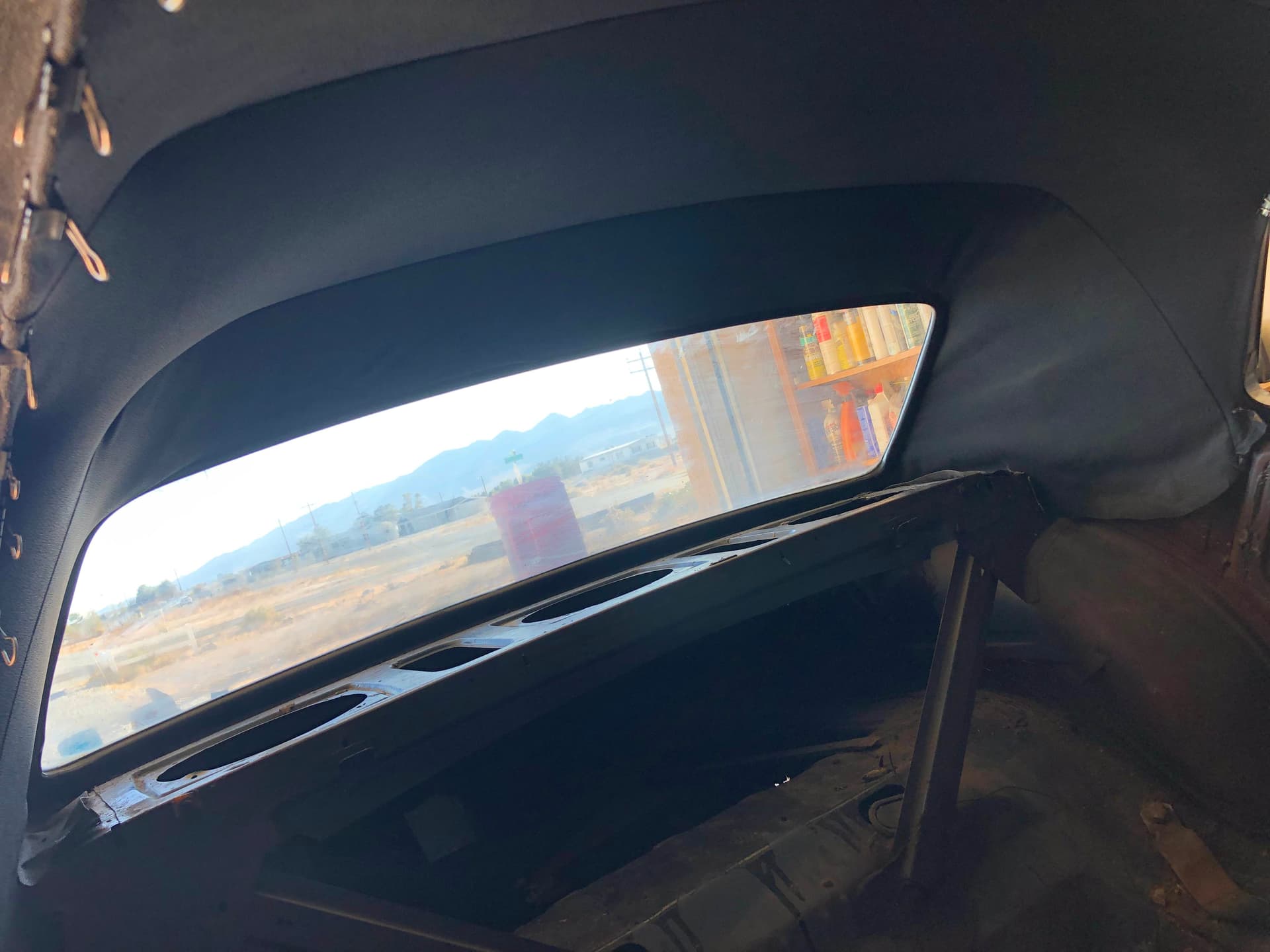

The headliner it’s self took quite some time and I still have to cut the holes for the courtesy lights and reinstall the visors, mirror etc. It took around 40 hours including windows out and back in, I made several mistakes but Im pretty good at doing headliners now. Firstly, dont use gorilla glue, secondly, the bows are meant to go in a specific order, and thirdly, forget doing the clips as vinyl cement will allow you to reposition the headliner and clip it afterwards while it’s curing.
The Windows were the most nervewracking but I managed to save the original glass and re-install them. I used don’s method of pulling the string and it was a pretty simple job, just had to be careful not to break the glass or pull down the headliner.
Overall, today was a good day, I got to drive the car again after paying insurance and registration while it’s been apart in the garage! :joy_cat:

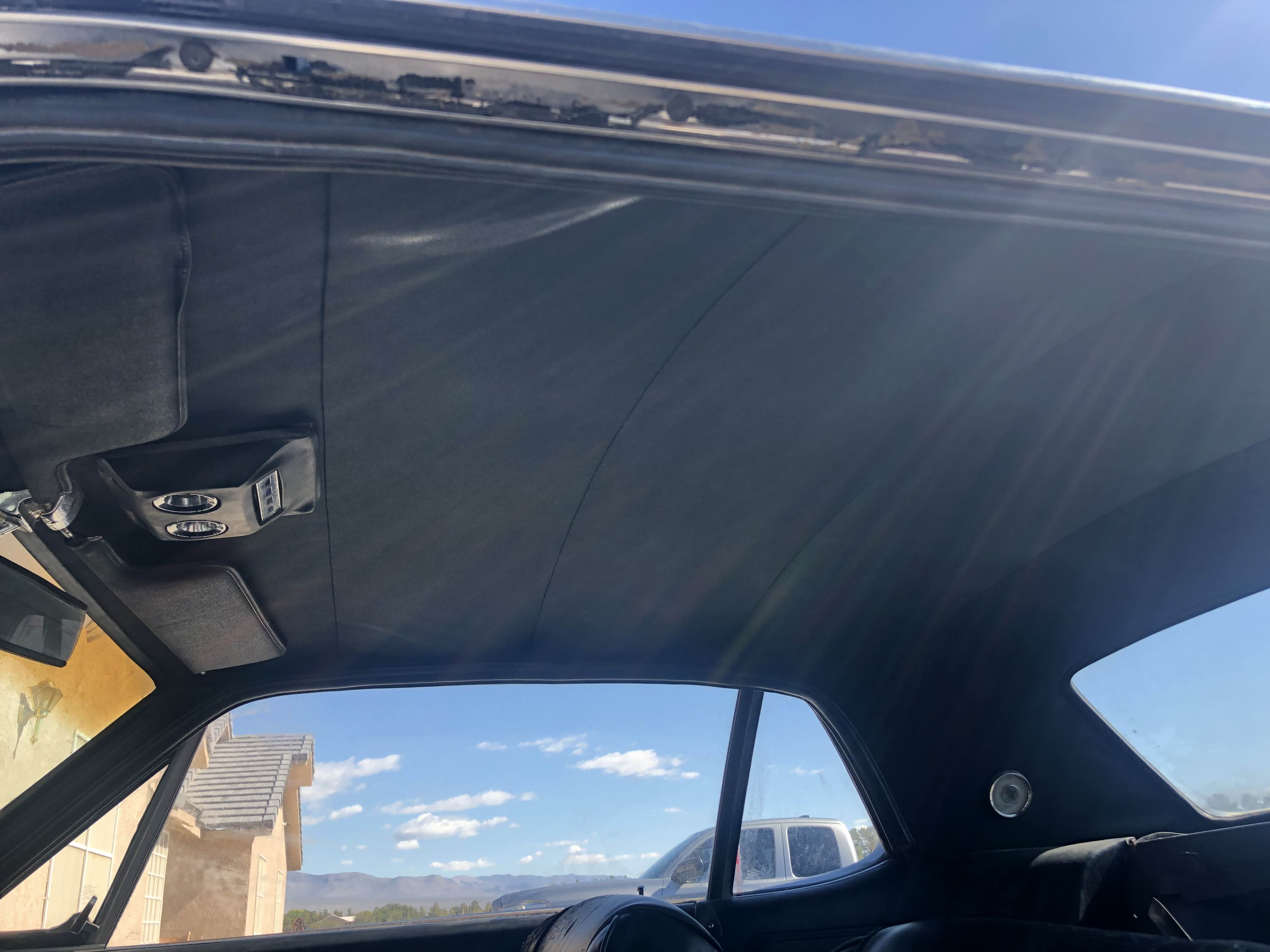

The headliner has been going great! I can’t wait to show you guys!
I just thought i’d post a funny malfunction with me electric headlight actuators in the meantime :joy_cat:
It seems like the actuator has decided to spin 360 degrees in the opening direction.

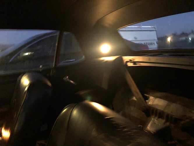

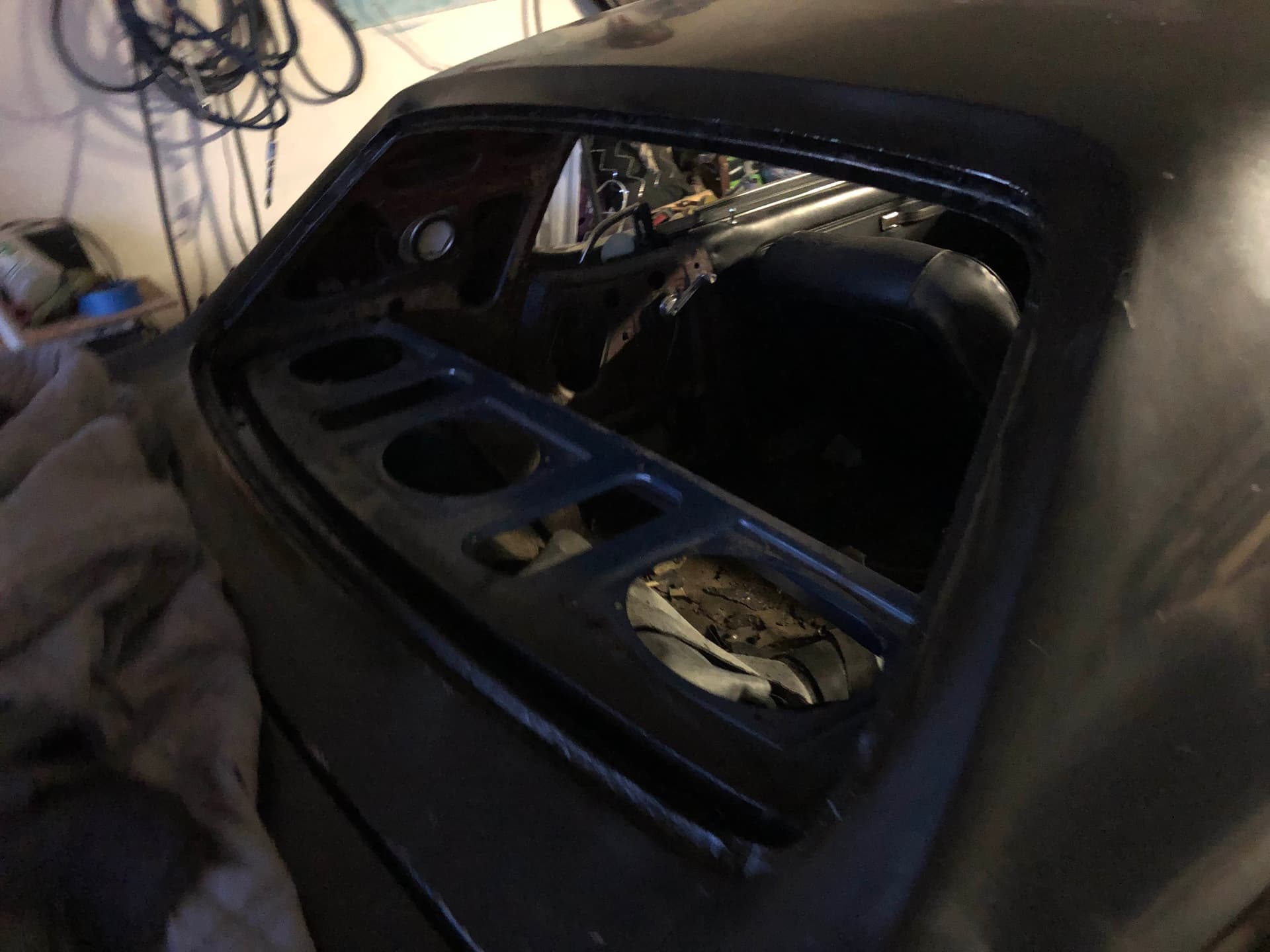

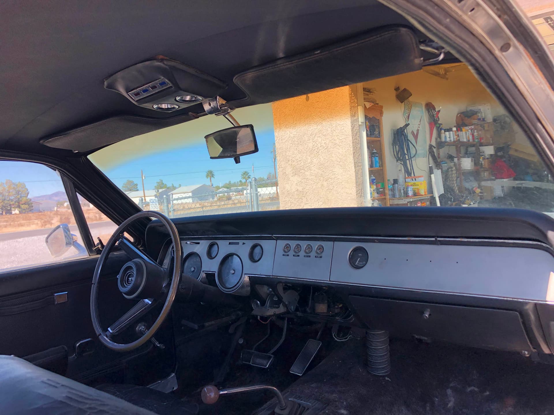

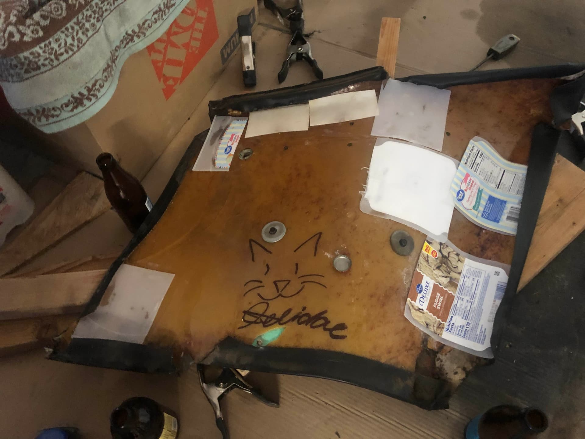

The headliner came out stellar! A Huge win in a field of setbacks. (my actuator breaking and a rotorhammer falling on my rear interior card)
I wanted to post a pic with the back seat in, but glueing it back together is taking a long time.
