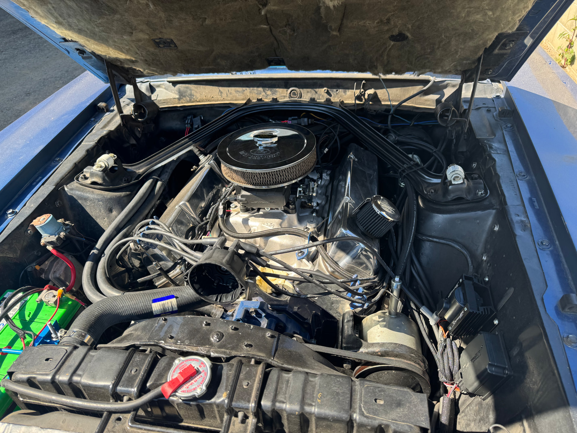

EFI, Borgeson steering, headers, exhaust

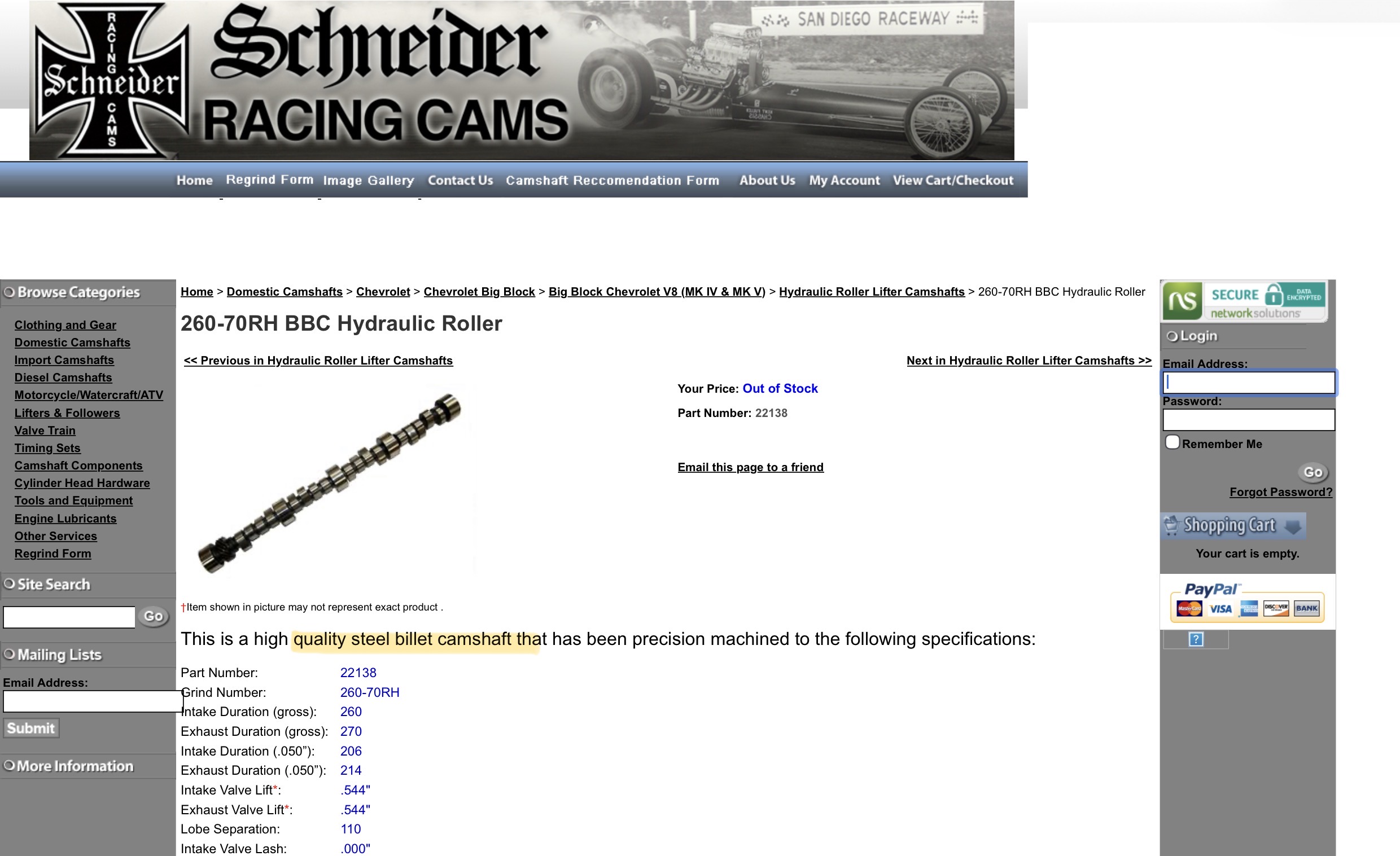

Schneider doesn’t indicate the material for its Cleveland hydraulic roller cam, but its Big Block Chevy version is billet steel. Apparently most roller cams are billet.

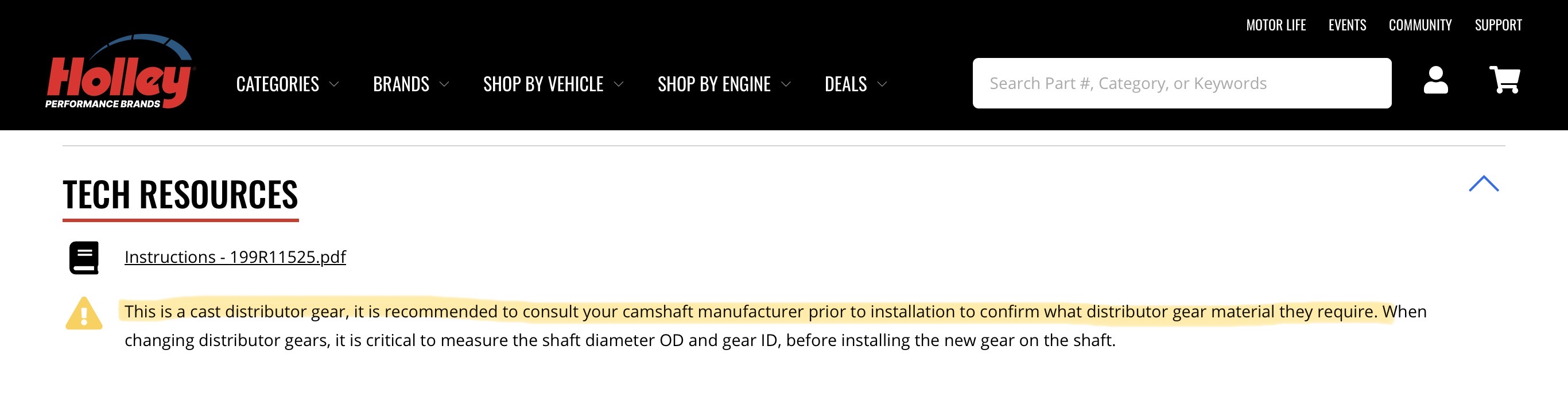

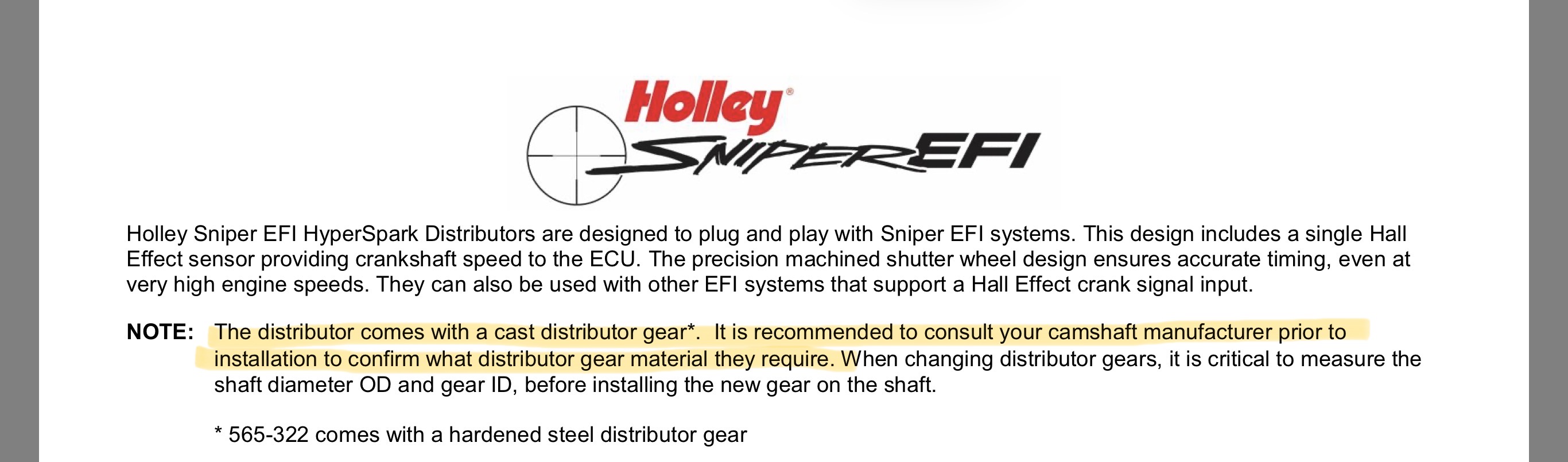

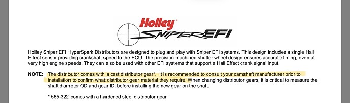

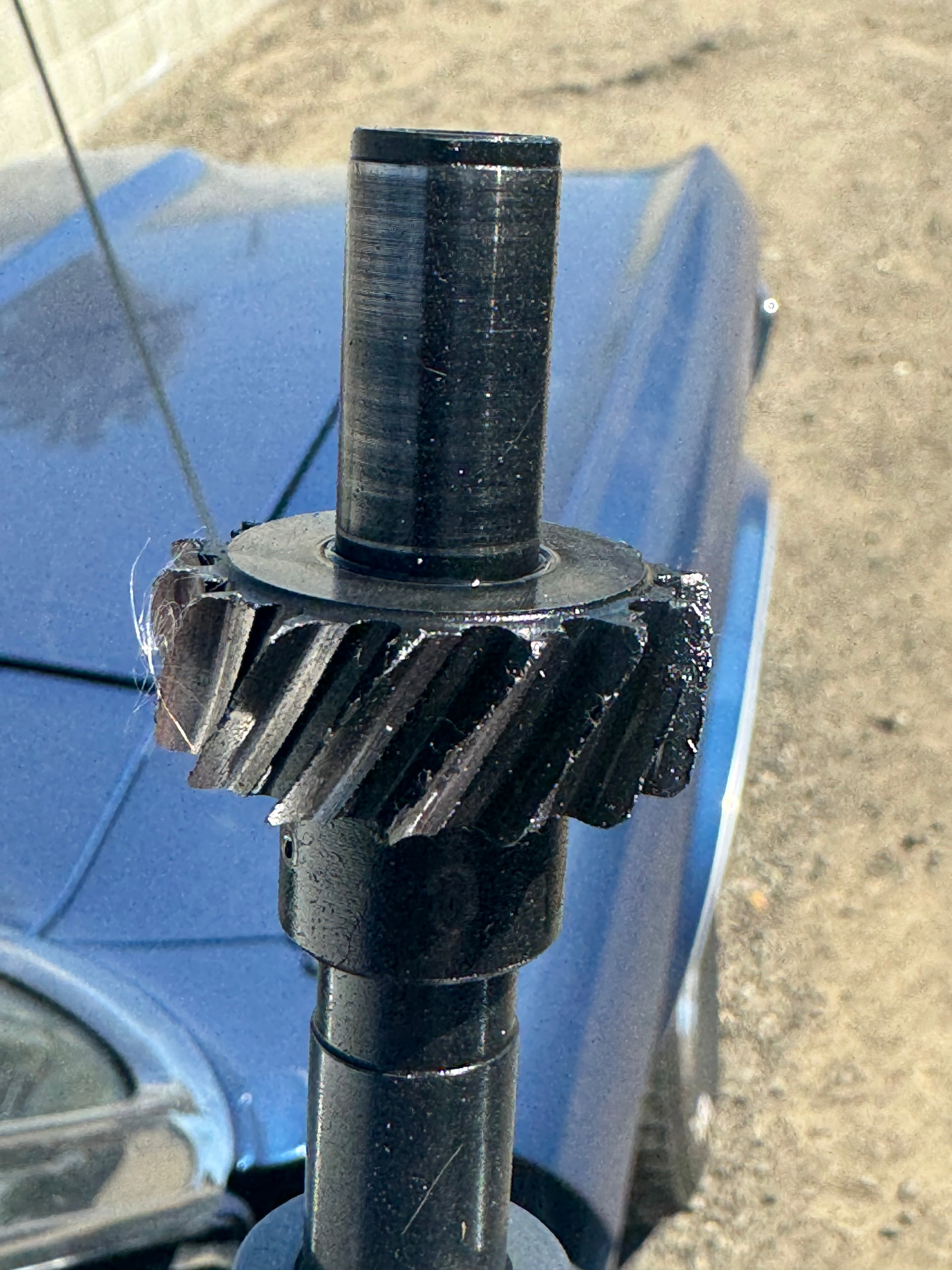

The Holley Hyperspark distributor uses cast iron gears, for which billet steel is too hard. They’d not last long, especially on a Cleveland, in which the distributor also drives the oil pump, Cleveland engines put more load on the distributor gear than many other engines.
That’s why Holley instructs Hyperspark installers to consult the camshaft manufacturer prior to installation to confirm what distributor gear material they require.

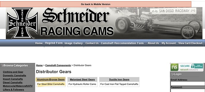

For Steel Billet cams Schneider recommends Aluminum-Bronze distributor gears.

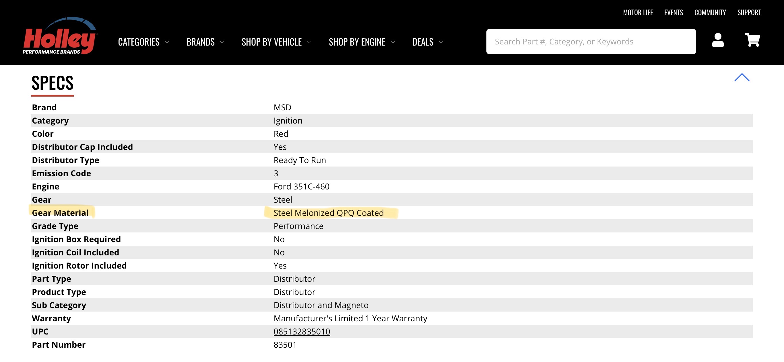

The MSD distributor the Holley Hyperspark replaced had steel melonized gears, so it survived longer.

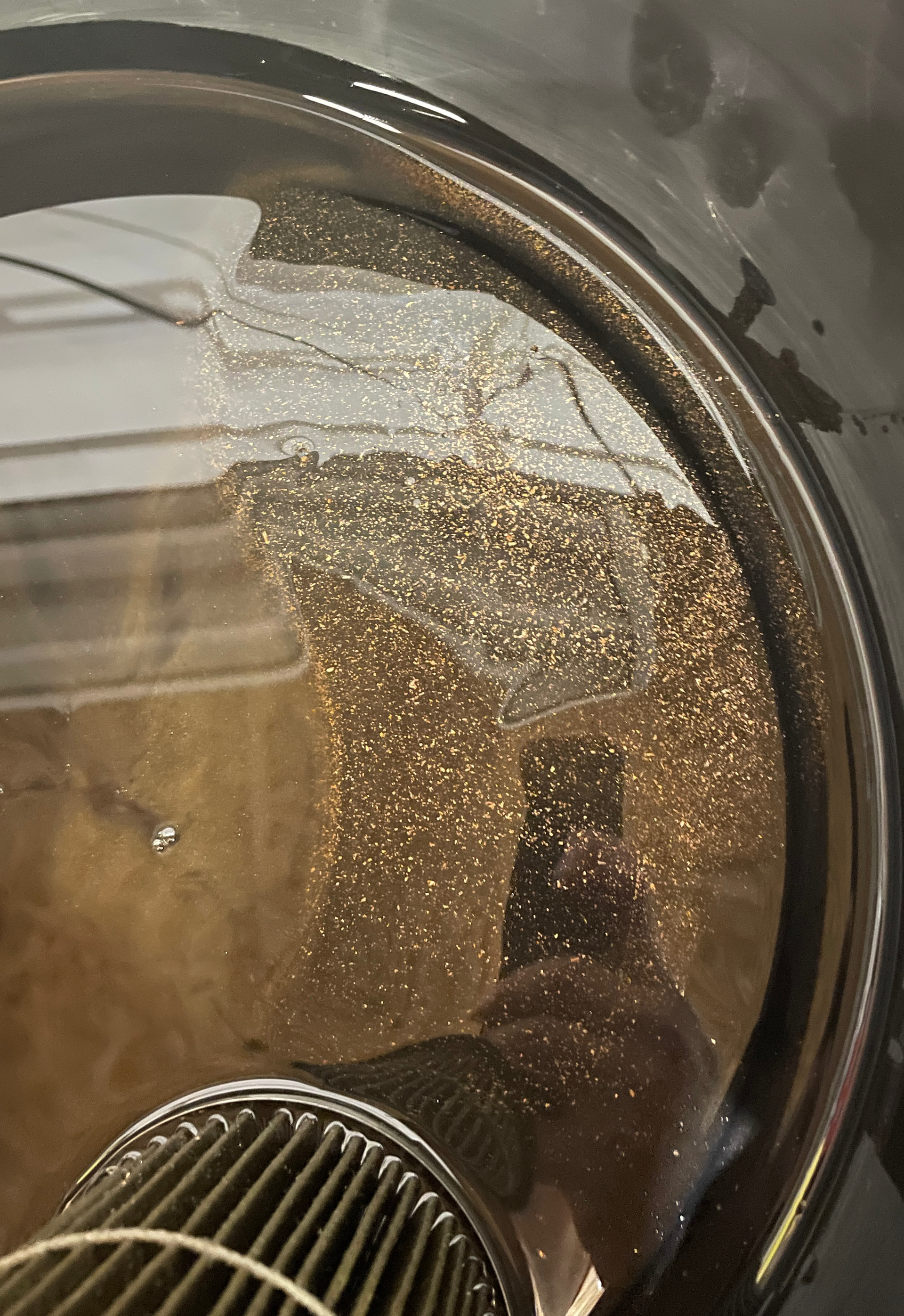

Now it’s back to the shop for warranty repair. The only problem is it’s 131 miles back to the shop, the tow will cost $700 and we haven’t resolved who’s going to pay what for that. Should I not have driven it out of the area during its initial shakedown? I did have business (I wanted to take it to interior shops for estimates).

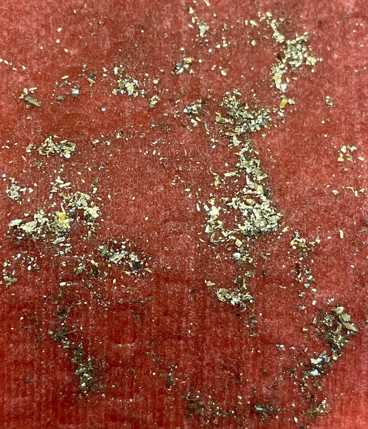

Unfortunately the gear will deposit shards of metal through the engine making a rebuild necessary. This is bad and a sign the shop doesn’t know what they are doing. Good luck.

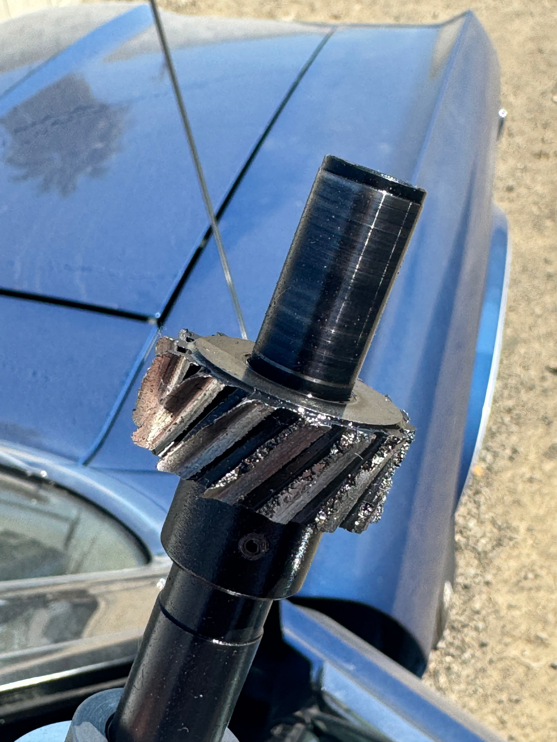

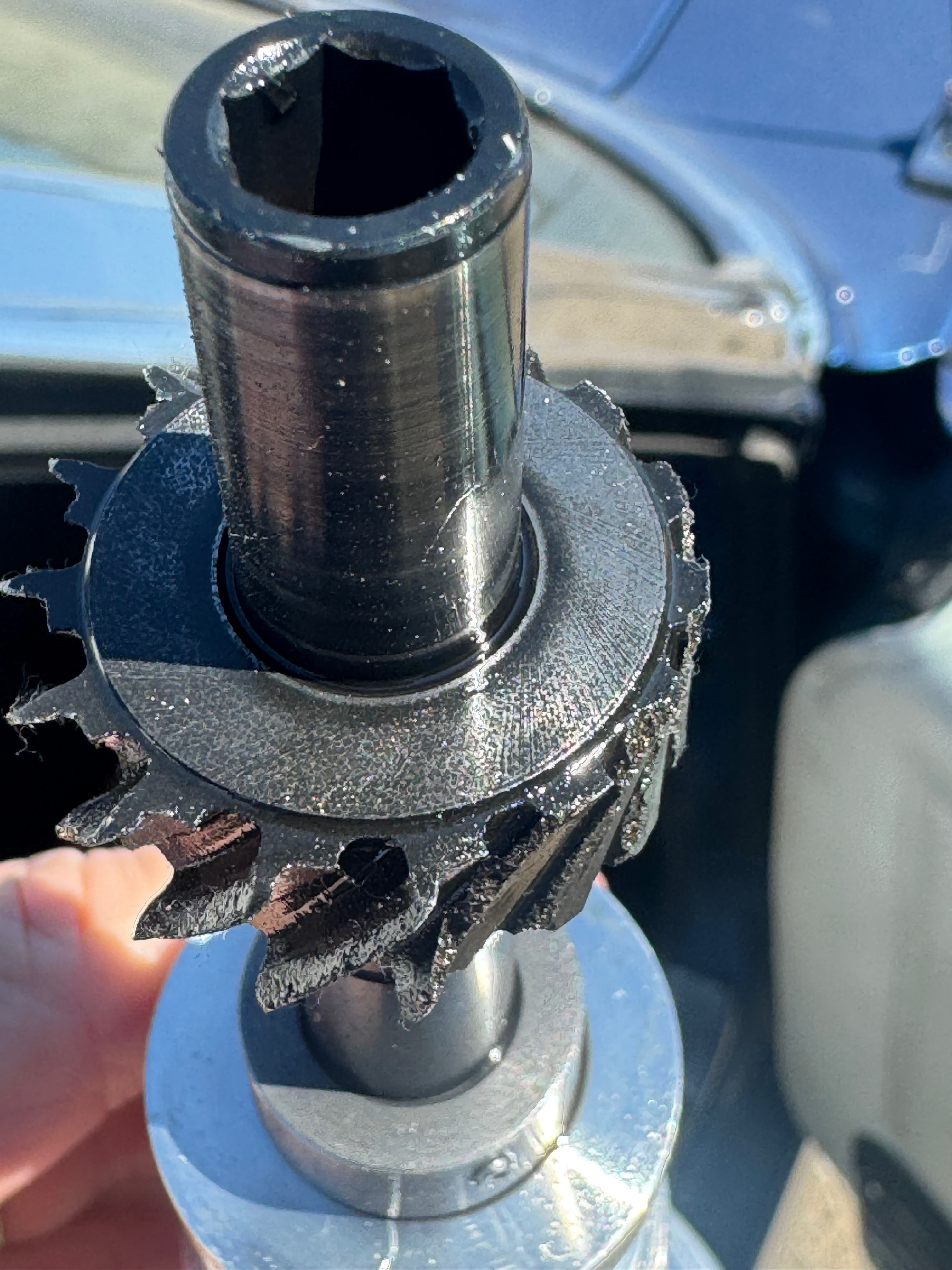

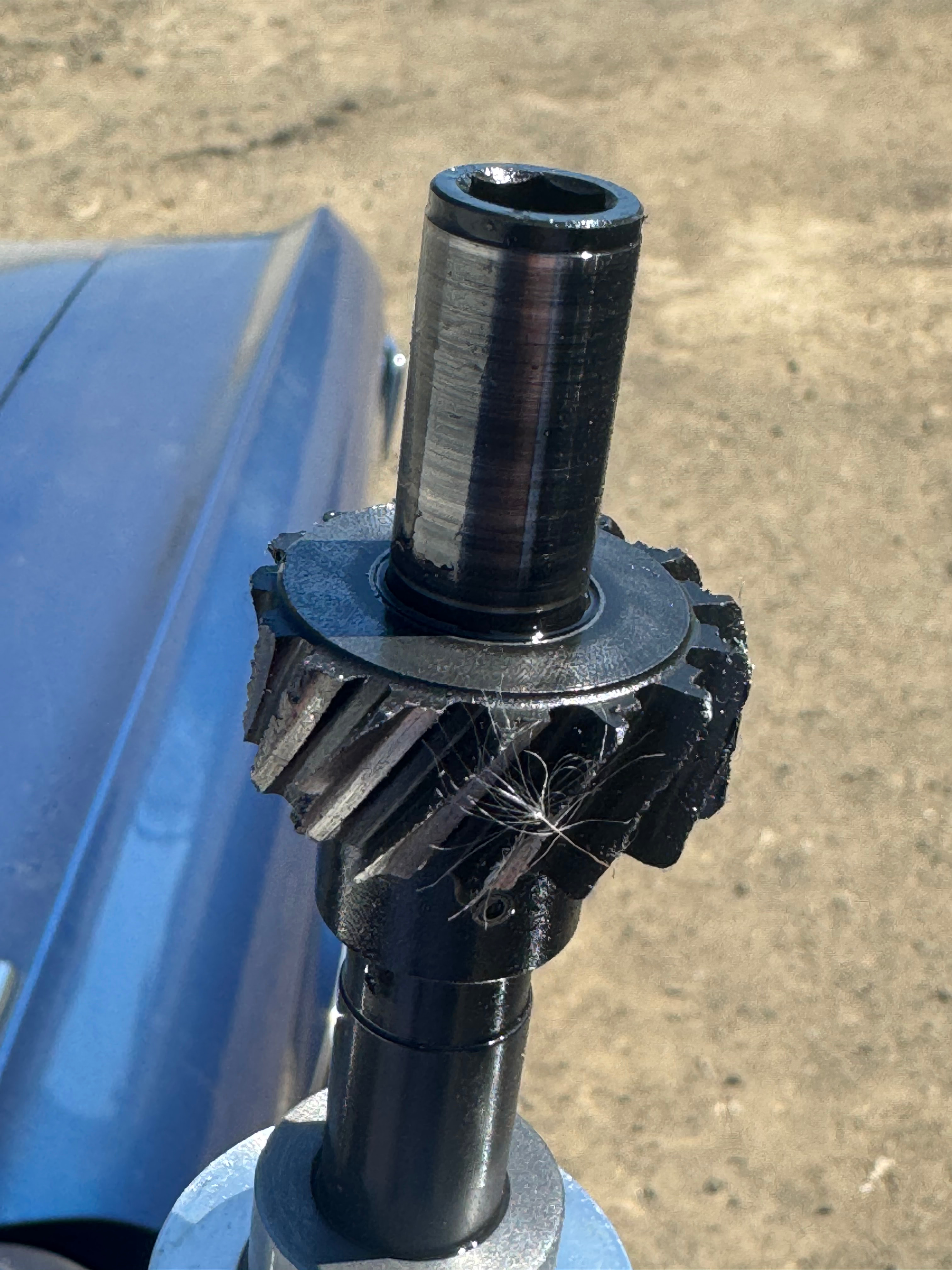

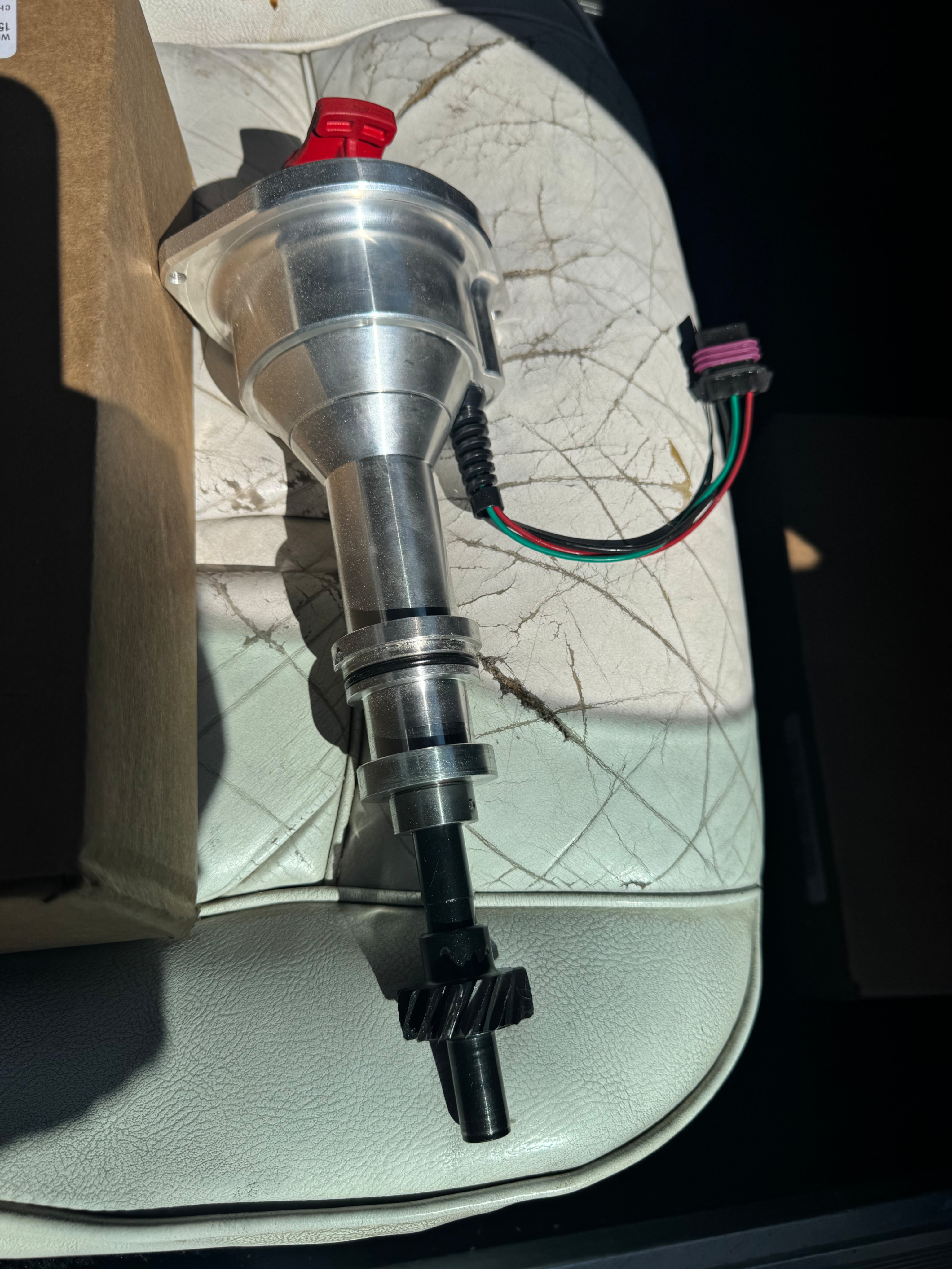

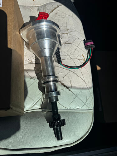

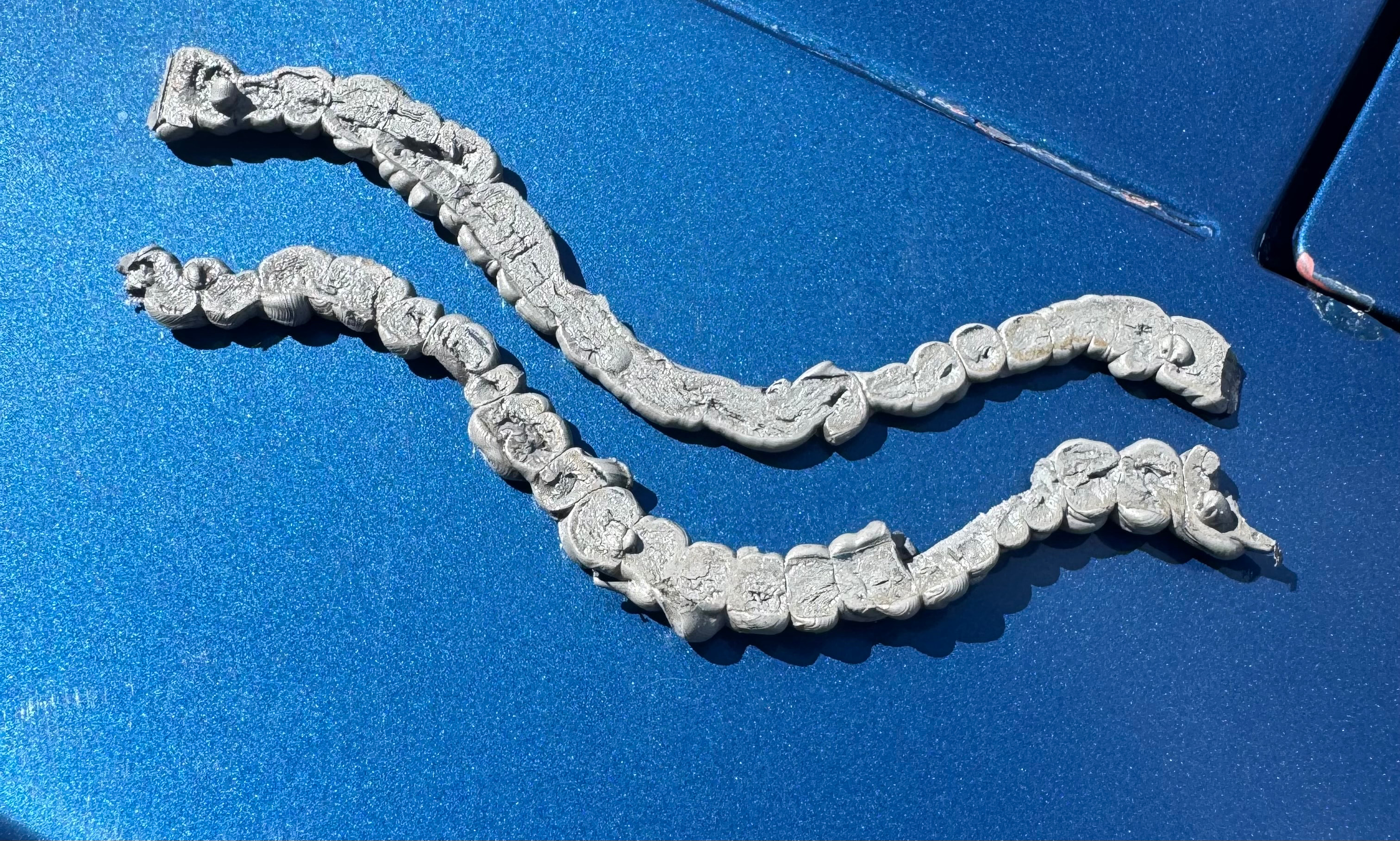

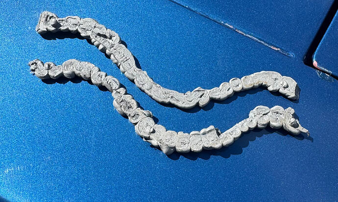

Here’s pics of the distributor and gears.
A case of severe tooth decay!

Saying that you need a complete rebuild is a little premature. If you had a high quality oil filter that was rarely in bypass mode, you should be fine. As someone that endured 3x failure of a thrust bearing without damage to main or rod bearings due to a high quality Motorcraft fl1a, it’s worth inspection, not complete disassembly.. I can assure you I had more debris than you will from a distributor and cam gear

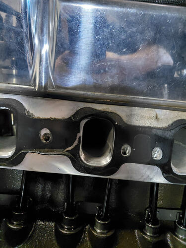

An update. Originally I wanted the Holley Sniper EFI to improve drivability. When rebuilt with the new cam and the carb the car had a rough idle and would stall out while parking. This was greatly improved by the EFI.

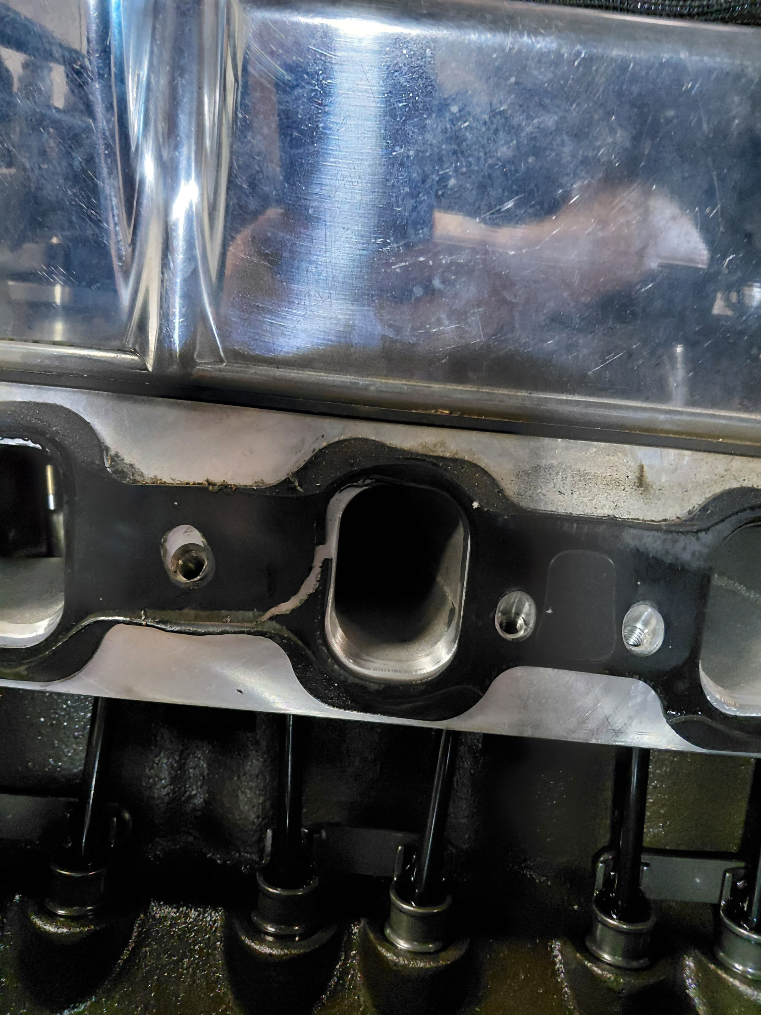

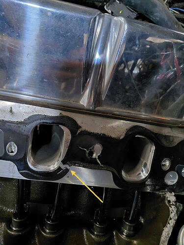

An oil leak developed, and I took it to a new mechanic. He identified the leak came from the rear intake manifold seal. So, the manifold came off the fix the seal. The sealant had been applied as beads, instead of a stream, which made for cracks which leaked oil.
Recall, the engine was built by the hapless shop which took four years, and had put the tie bars in the wrong way.
But, that’s not all. The was intake gaskets were torn, which was allowing a vacuum leak.

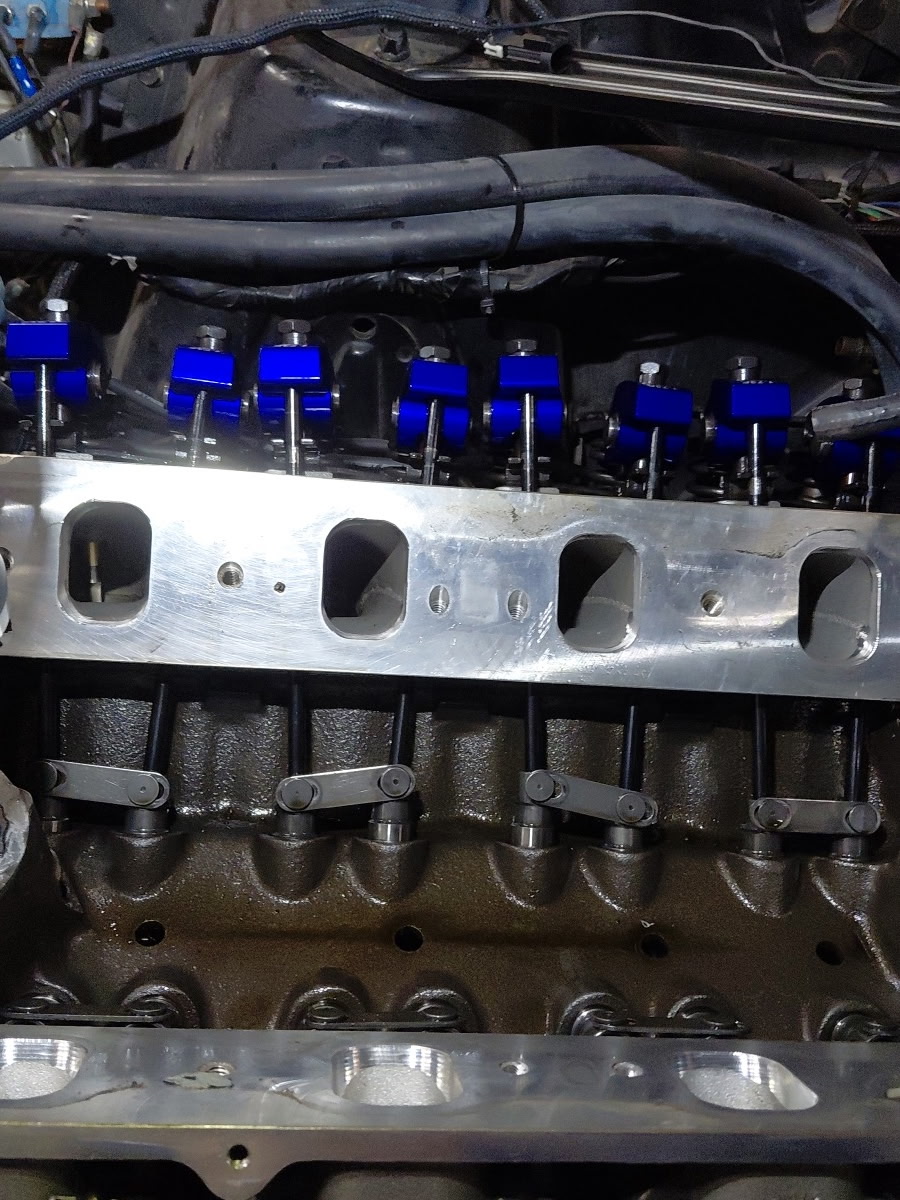

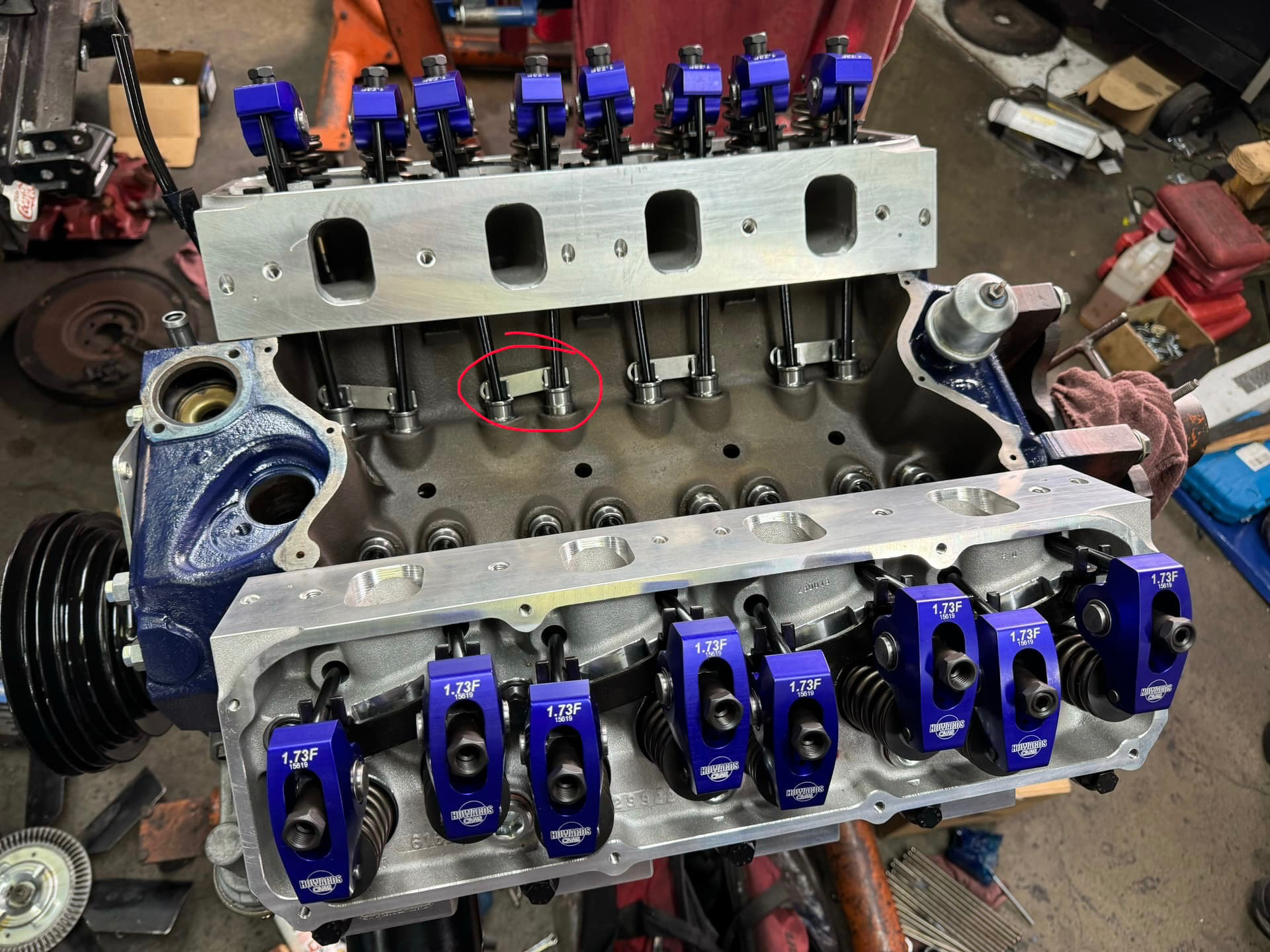

As long as the intake manifold was off, that was an opportunity to reverse the tie bars.
Before:
After:
Also, while the Edelbrock Performer Intake Manifold 2750 was off, the mechanic machined a passage in the divider of the this dual plane manifold, to allow the Sniper censors to sense both sides. Don’t have a pic of this, but it’s like different versions of the manifold.
So with these repairs and modifications, the engine is running smoother than ever. I think that a lot of the initial drivability problems that I attributed to the cam and carburetor were actually the vacuum leak. The Sniper did its best to adjust for this, so the drivability improved. Now we’re experiencing the EFI without a vacuum leak, and it’s really nice.

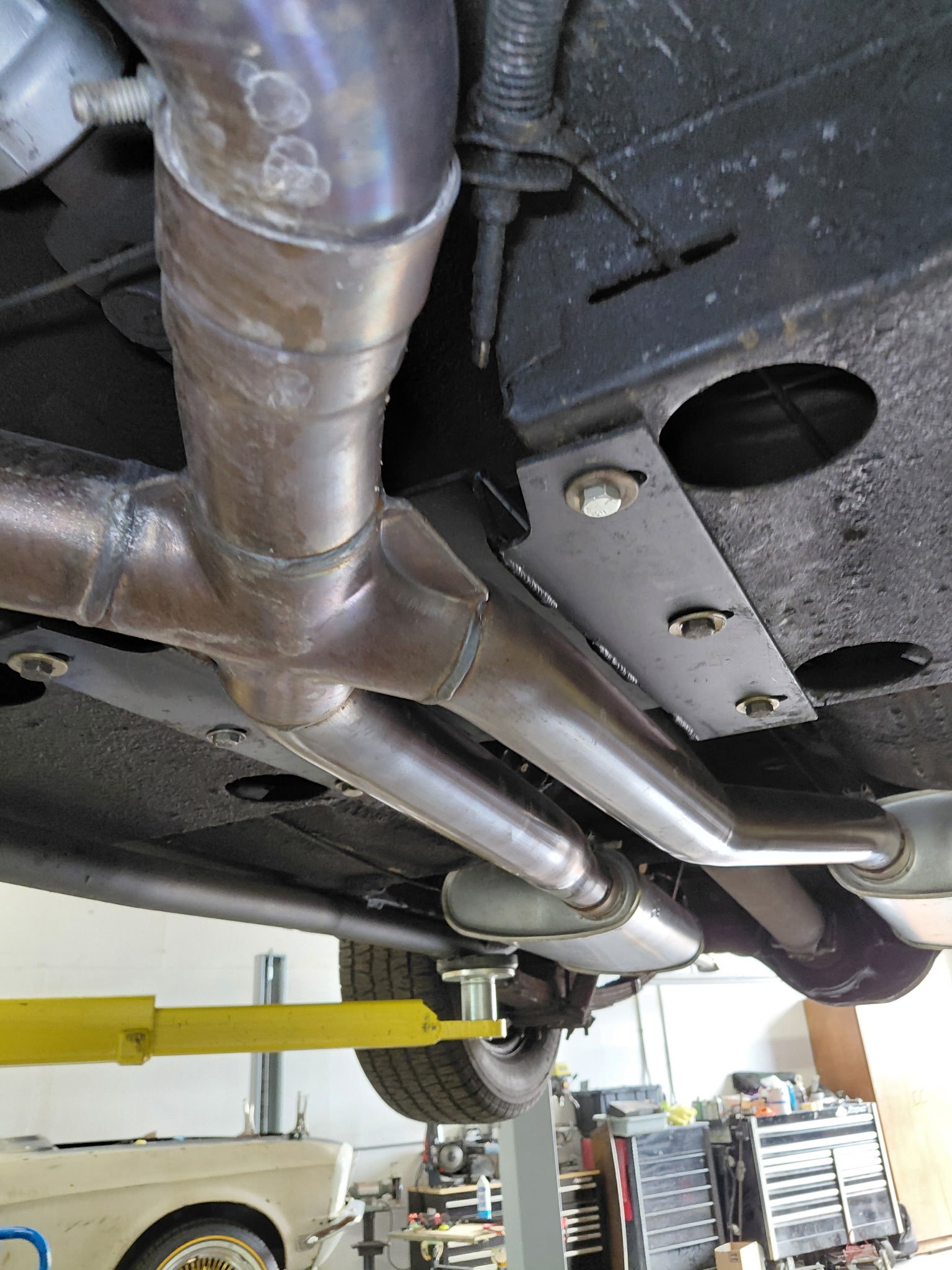

The shop originally hung the frame plate under the pipes, which caused ground clearance problems. More recently they fabricated a plate to go over the exhaust, and today it was on the lift and I finally got a pic.
Also seen is the Maier subframe connector, which has made a tremendous difference in ride quality.
They did nice work! Your exhaust is hanging lower than factory, but I’m glad that is not causing you clearance problems.
