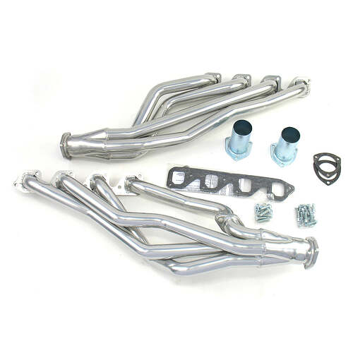

:black_small_square: Doug’s Headers D670S4

For example they’re confident the headers will fit even with the Borgeson.

Tubular headers are going to make it noiser in the cabin. We ran magnaflows on a 390 but put a ton of insulation in the floor, above the headliner ,a metalic rear seat bulkhead insulated package tray , insulated trunk ect

I’m not really knowledgeable of the differences in sound between headers and iron manifolds.
:black_small_square: Do headers make the exhaust louder, or change its character?
:black_small_square: Do headers transmit more sound through the metal into the interior?
:black_small_square: If so, does ceramic coating make a difference?
:black_small_square: Would a shorty header mitigate header noise? I’m looking at Doug’s Headers, but Sanderson makes a shorty. Which to choose?

Sanderson shorty headers are not louder than the OEM cast iron manifolds
Borgeson steering box is larger than the OEM Ford box and Sanderson advised it may not clear the headers. Getting rid of the complex, leak-prone OEM PS system is always a good choice in my book. I use R&P steering (a favorite mod of mine) so clearance is not an issue for me.

I have Tri Y headers and have not noticed it being any louder than manifolds.
