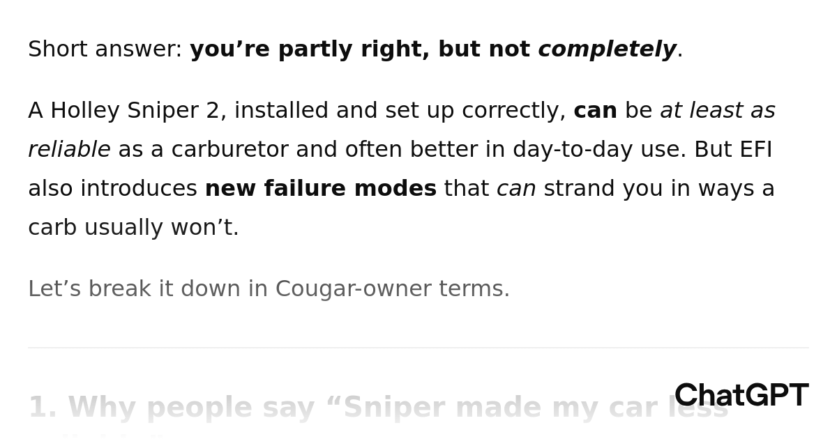

The problem is that the shop is incentivized to cut corners if the are working against a fixed price. Or you have a DYI install where the owner doesn’t know what has to be done correctly or even what matters. So in both cases the fix is to remove the dumfuckery and correct the installation. ChatGPT got it mostly right. However it didn’t spell out the details.

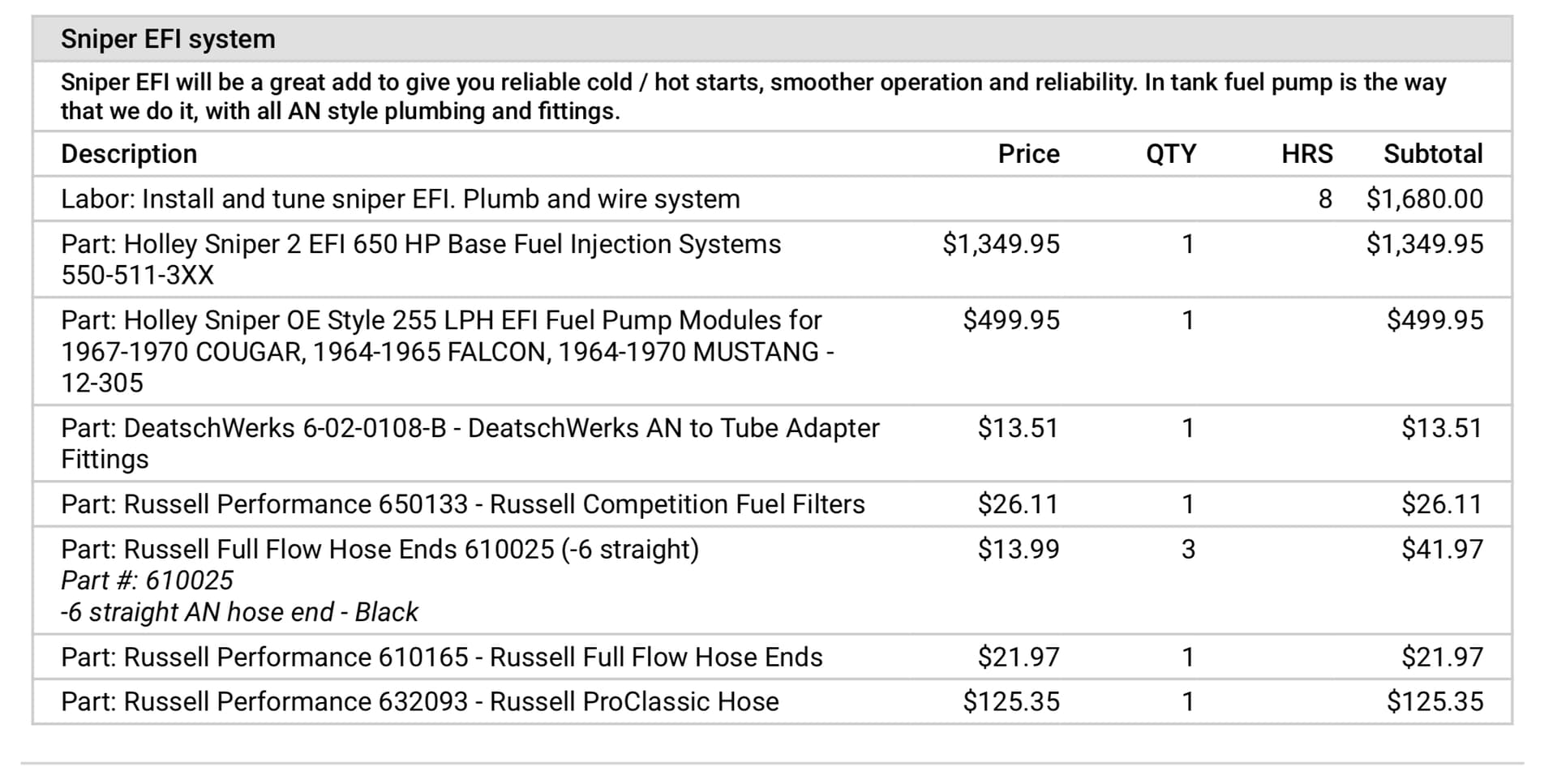

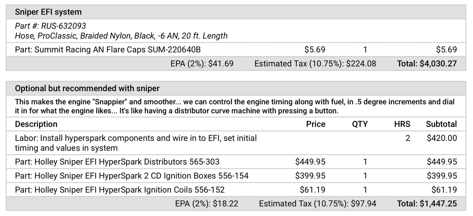

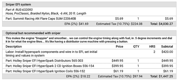

Here’s screenshots of the estimate with all the parts. This look like a shop that knows what it’s doing?
I can relate to the GT car thing. The labor seems really fair for the Bay.
Looks like the shop knows what they need to buy, I would only say if you decide to do the ignition, they can order the sniper 2 as a kit and save you about 900 dollars. Their parts total for the sniper setup with fuel pump and tax is $3231.

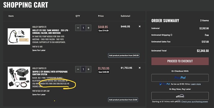

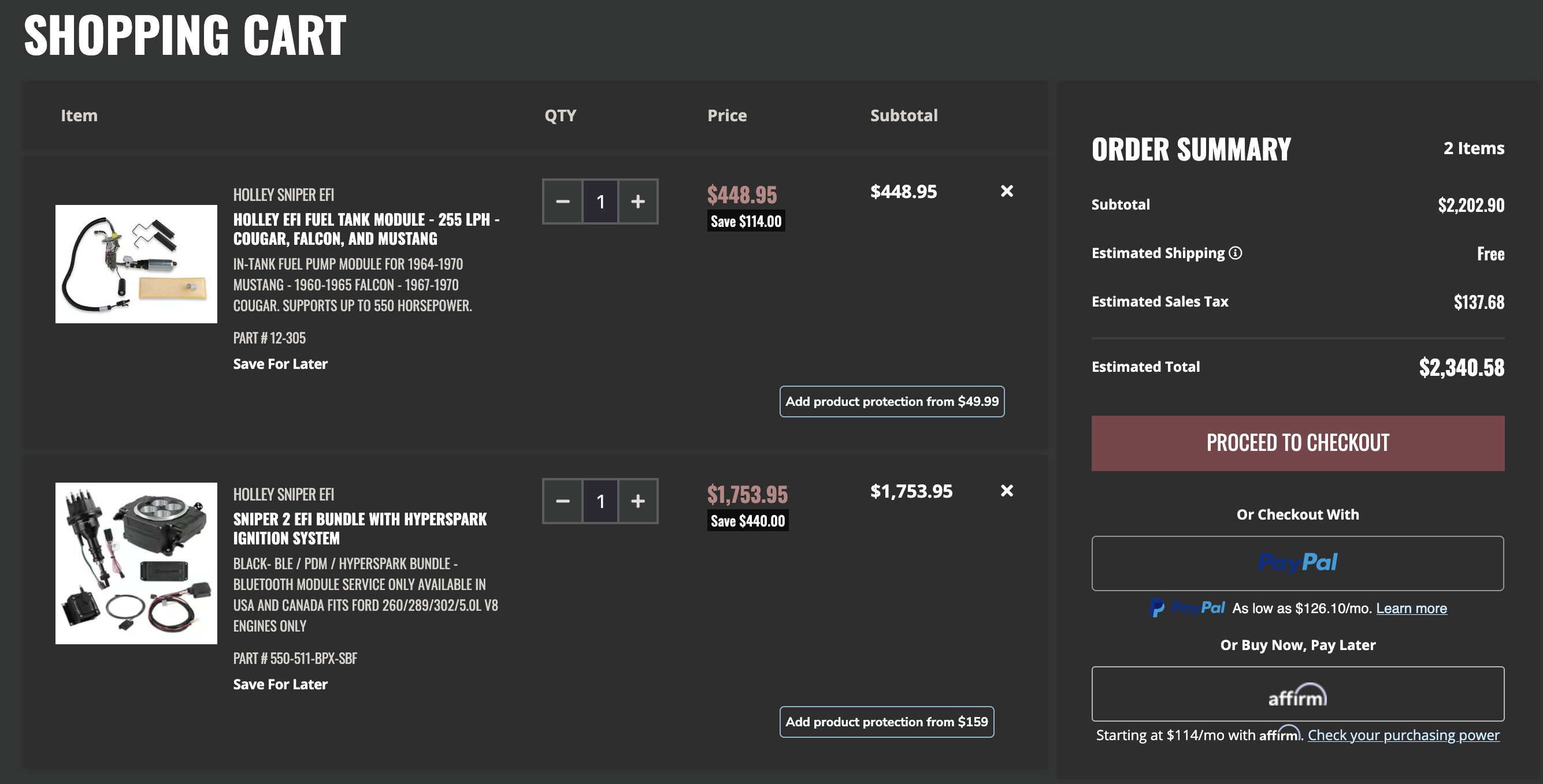

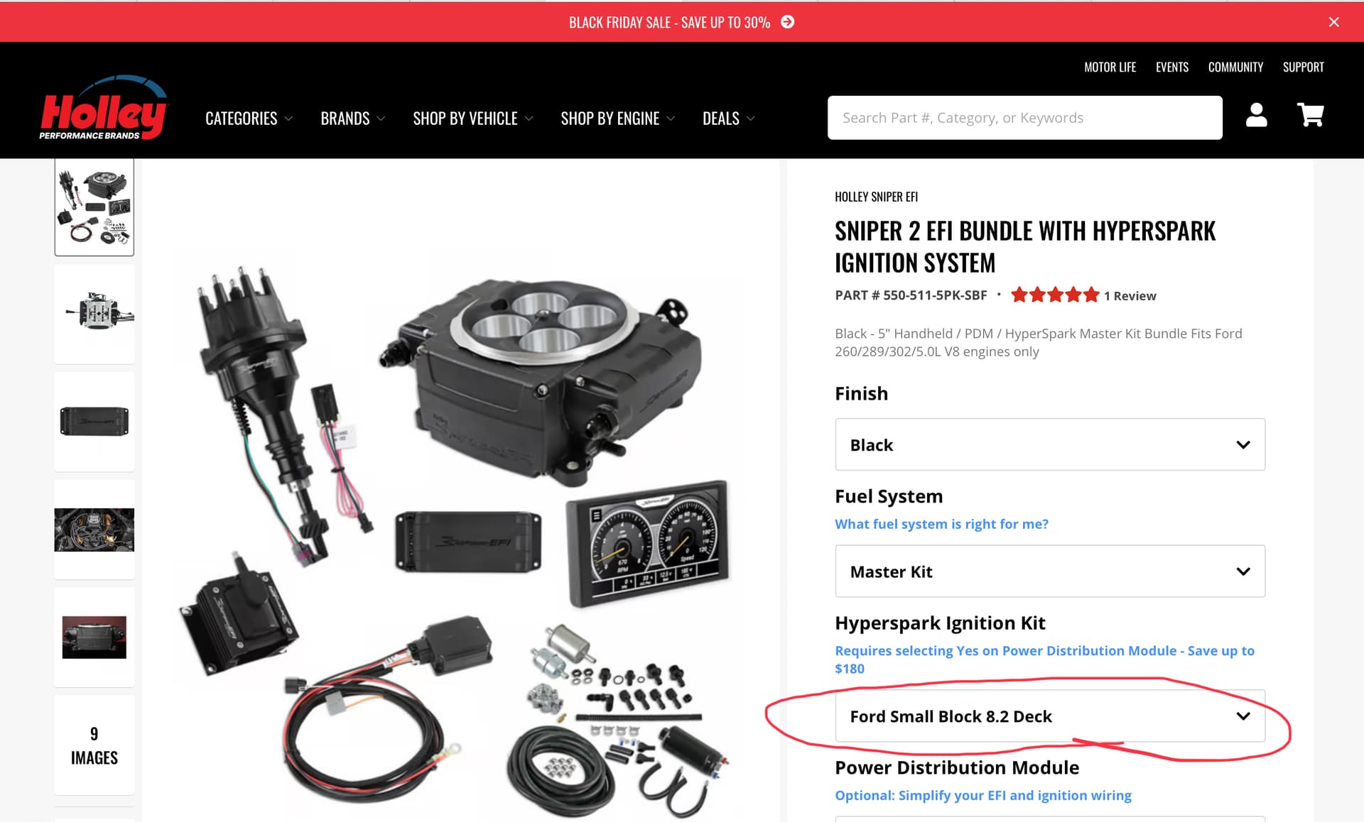

Here is all of that straight from Holley for $2340 to your door. Maybe you can order it and save some of that cost? That also includes the Sniper PDU which to me would make the wiring much cleaner.
Remember as a shop they will have a markup on their parts too, it will almost always be higher then what you can find online. Depending on the shop they may or may not let you supply the parts needed. Its also common practice if the customer supplies the parts the labor costs may be higher as well
Yeah, i saw that, but that bundle is only good for the 302, 8.2 inch deck height. Mine is an 9.2” deck height Cleveland. If the shop is a big Holley customer, maybe it can work a deal? The shop owner said, however, that he didn’t find Holley was attentive to their shop customers.
https://www.holley.com/products/fuel_systems/fuel_injection/sniper_efi/sniper_4-barrel_systems/sniper_2/parts/550-511-5PK-SBC

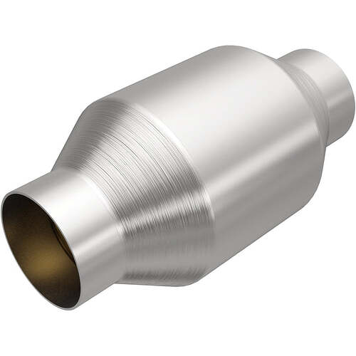

I’m looking forward to the catalytic converters, it’s a trick learned by the garage I’m taking it to. Cuts down on the droning noise, and cuts down on exhaust fumes.

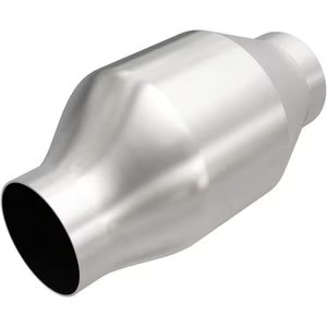

The MagnaFlow Standard Grade Co Universal Catalytic Converter 53956 isn’t that expensive, is high flow, should cut down on noise, and will reduce auto fumes. What’s not to like?
I think you have sunglasses on. The borgeson steering is OK but the chinese made copy of a generic motors pump is leaky crap that will disappoint you. There is not a good reason for catalytic converters that is some hogwash.

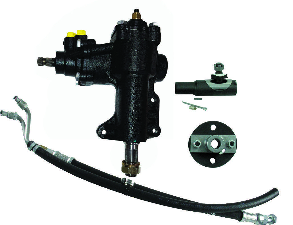

I’m getting Power Steering Kit Part #: 999024. It’s U.S. assembled.
All Borgeson power steering boxes are assembled and tested in the USA from globally sourced components and have a 3 year warranty.
Is this the Borgeson steering that’s OK, or the Chinese made copy of a generic motors pump?
Borgeson has been manufacturing these conversion steering boxes for at least 15 years. If they are leaky crap, wouldn’t that have caught up to them by now?
Catalytic converters have really cleaned up the smog in LA, so they are a necessary evil for modern cars. But there is lots to not like about them: stinky sulfur smelling exhaust, high operating temp, increased exhaust back pressure, added cost, theft risk. I would instead spend that money on high quality mufflers and maybe resonators to get the desired sound.
If the guy is cruising around. cats are ok and no noticeable difference. the fi will help with the gas fumes or a well tuned engine.
