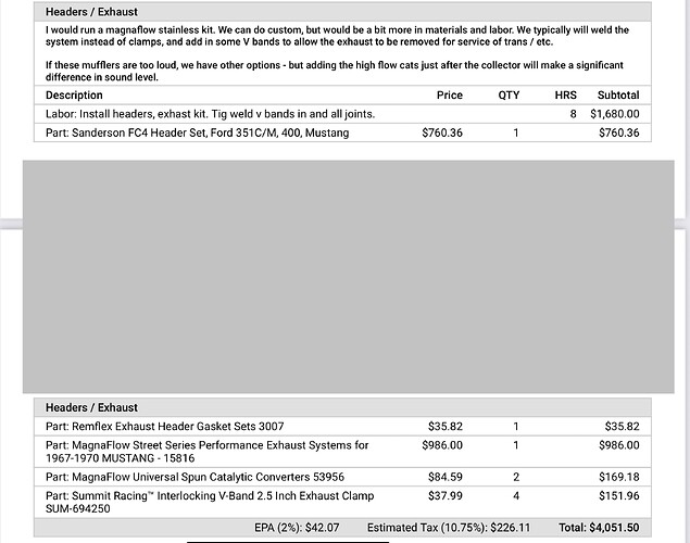

Here’s the parts for the exhaust. The Sanderson headers are going to bolt up to a Magnaflow Mustang kit, with my controversial cats in between? What mufflers to be used to be determined. I might want something quieter than the Magnaflows.
My Cougar is not responsible for U.S. deindustrialization and globalization of supply chains. It’s not realistic to keep my Cougar free of Chinese manufactured parts. Borgeson is a storied U.S. company, it assembles and tests in the U.S., and issues a three year warranty. If I want to keep my car straight in its lane without tuna boating, Borgeson and it’s Chinese parts are gonna have to do.
I’m not qualified to judge whether cats with their platinum are good or bad for the environment. They’re not really being installed for the :globe_showing_americas:.
The shop gives every indication it knows what it’s doing with the exhaust installation. I’ll be sure to tell them of your concerns.

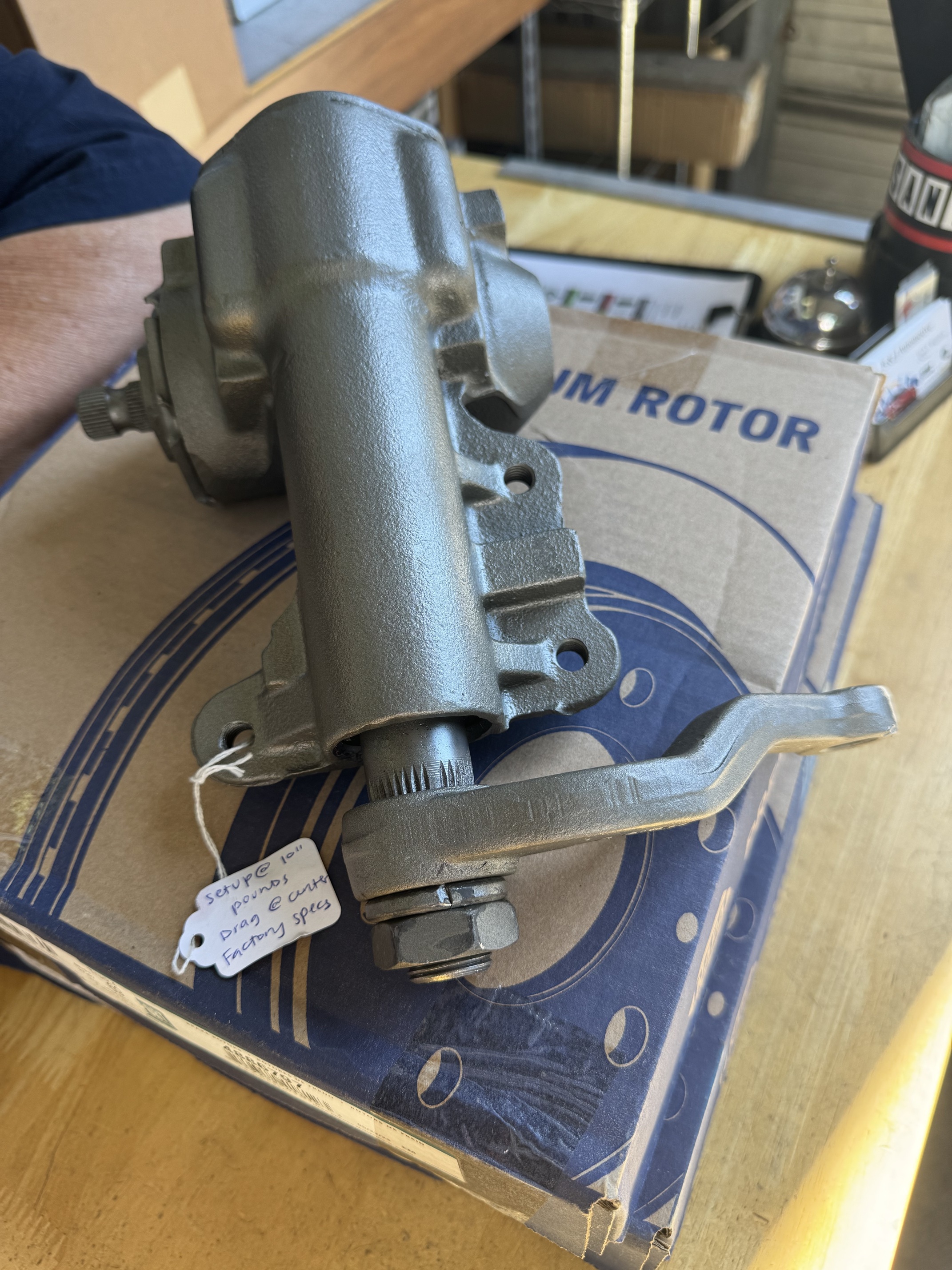

My Cougars suspension has been entirely rebuilt, except for the steering box. The steering was very loose. So I had my steering box rebuilt by Chocko Stang. It was a lot better. But it’s still numb and somewhat vague, as I recall from my 1968 GT XR-7 in high school. I wouldn’t look forward to taking Highway 17 to Santa Cruz. I want the steering to be better, so that I’ll never think twice about driving it.
Dan Chock does a great job. If it was me I would feel privelaged.
I extolled of my Dan Chock rebuilt steering box when I got it. Brought me right back to 1970, which isn’t that great.

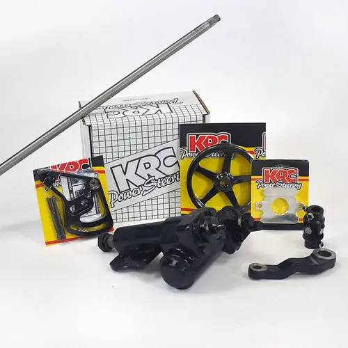

Where’s the Maier box/kit made? ABS box is I believe from a company in SoCal. KRC pump.

Your plans are cool, don’t understand the intention to use catalytic converters though…

it sounds like your building a cruiser. save money. no headers. this will save a lot of man hrs.
Pypes exhaust, they have one specifically for cougars. purchase without mufflers, pick your own. buy 2 1/4 “ it will be quieter than 2 1/2” .
go efi. but exhaust crossovers must be blocked off or aluminum intake

Yes on Borgeson kit, Run the GM style pump as the ford one wont cut it for their gear box.
May consider Electronic steering over the borgenson? About the same cost, bonus over hydro is being able to control the assist. No pump hanging off the motor
I disagree on the cats personally, I think its more hassle and protentional issues then it is helpful. These aftermarket cats never last very long and or are simply there to pass emissions which you probably do not have to worry about on your car. Also if you are running a high zinc oil it will degrade the converters faster as well. Having EFI on the car will make a big difference on the smell and even the exhaust drone, I know it has on mine with no other changes.

The Chinese made pumps leak profusely. Maybe the vendor is responsible. Maybe not. In any case the answer is use GM original pumps and you won’t have an issue.
