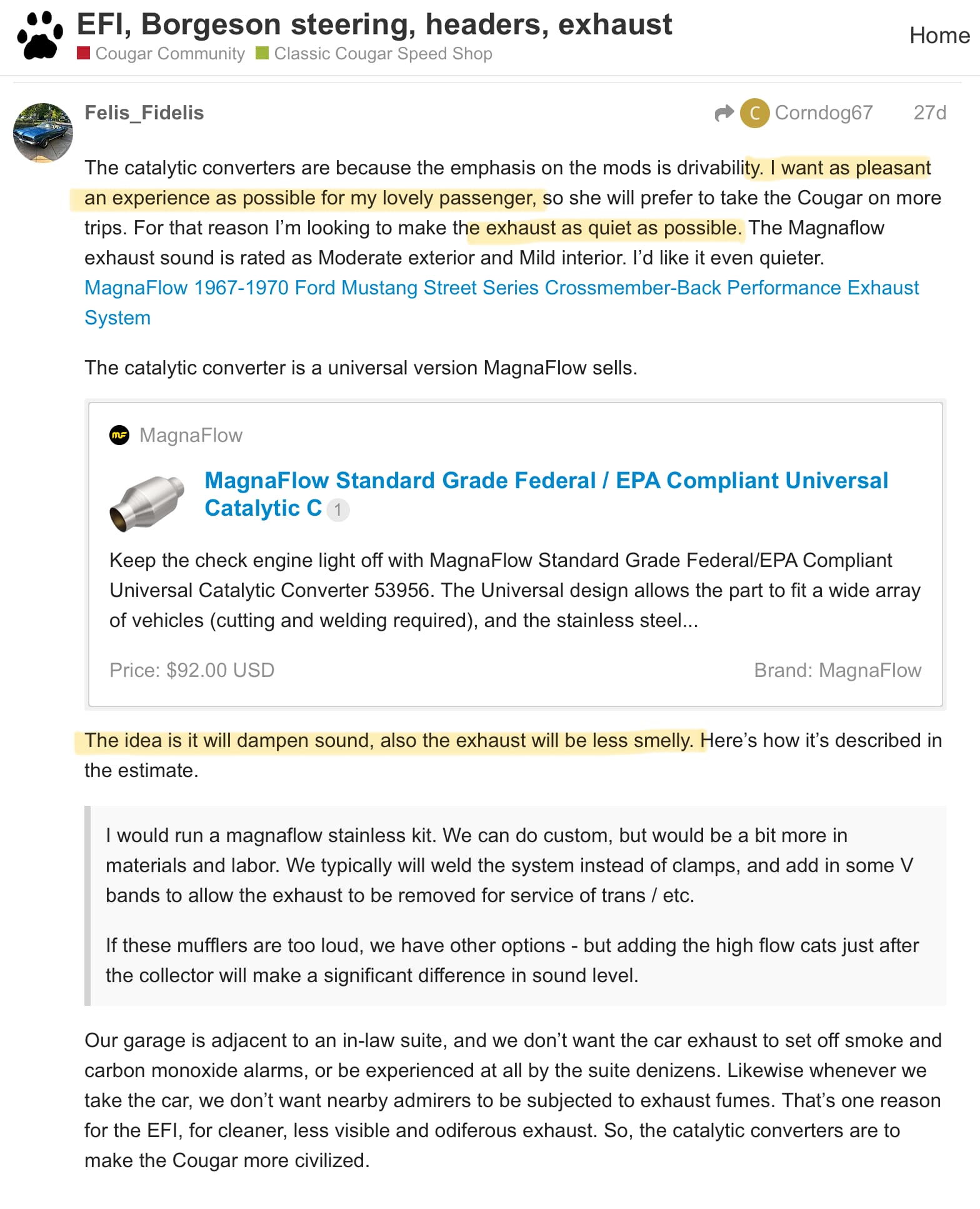

Not sure if this has been asked but in newer cars you have a up stream O2 (before cat) and down stream O2 (after cat). Do the snipper let you set it up to work like that? I do know if the O2’s are not correct they will kill a cat.
Don’t you just need to put an oxygen sensor in the exhaust pipe, catalytic convertor or not? I thought aftermarket EFI systems for non-cat cars didn’t need a cat.
I applaud your idea to clean up the exhaust smell and emissions with aftermarket catalytic converters, but it’s just not that simple (I wish it was, I’d run them too). If your EFI system is not rigorously tuned with the intention of keeping the cats alive, they’re going to get fouled and ultimately burn up. You’ll end up having to replace them fairly regularly if you put any mileage on the car. Catalytic converters are not a set and forget thing like a muffler, to work correctly they have to be kept within a certain temperature window. Also running too rich a mixture will burn them out quickly.
The catalytic converters are the idea of the shop that’s installing the headers, exhaust and EFI. It’s something he’s learned that works well. I’m going along with his recommendations. I’ve sort of enjoyed how much discussion the cats have stirred up!
That’s interesting, maybe with a decent EFI tune it’s feasible to run cats. I’m curious to hear how it works out.

In order for the cats to work they need to get hot enough to “lit off”. The closer to the manifolds the better. They also need the air/fuel ratio to be lean or near stochiometric (14.7:1). Having the EFI properly set up can help a lot with that. The other thing to consider is those cats will add a lot if under hood and floorboard heat if not insulated well. Honestly a properly tuned EFI or carb and a good ignition will go a long way towards achieving what you want.
I described to the shop what I was looking for (as I did in this post), and the shop recommended the cats to make it quieter, and to also cut down on fumes. Are you still confused?

I agree one has to evaluate answers from questions posted on these forums, but it appears these “keyboard warriors” have been fairly consistent in their recommendations…especially in not using cats for their questionable gain in this configuration. However, fuel injection should make a positive impact in addressing that “smelly exhaust” due to their ability to meter fuel via use of the O2 sensors…thus cats aren’t needed. Another option is to leave off for now, and add later once all of the other work is done…provides a way to see if issue is addressed.

I would have some questions for them if it was my car such as…..Do they write specific efi tuning for converter operations? do they run an O2 sensor on each bank? downstream O2 sensor for monitoring of converter function? Do you run a high zinc oil and if so how will that affect converter life? What is the life expectancy of these converters? Can I get replacements easily? Do they increase the in cabin temperatures and if so how do you counter that? For the customers that you have installed these on how much do they actually drive their car? etc

I’m really curious now how it will turn out, especially with the controversial cats. I’ll let everyone know if the heat scorches through the floor plan, it reeks of sulphur, doesn’t quiet at all, messes up the FI exhaust sensor, etc. They’re only $85 a piece, and they’re not itemized as additional labor (it’s 8 hours for the entire headers and exhaust).
I’m very curious about how the catalytic converters will work out and install details such as where they place them in the exhaust system, etc. If you don’t mind sharing some pics of the finished install here I’d love to see them.
