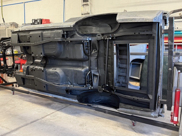

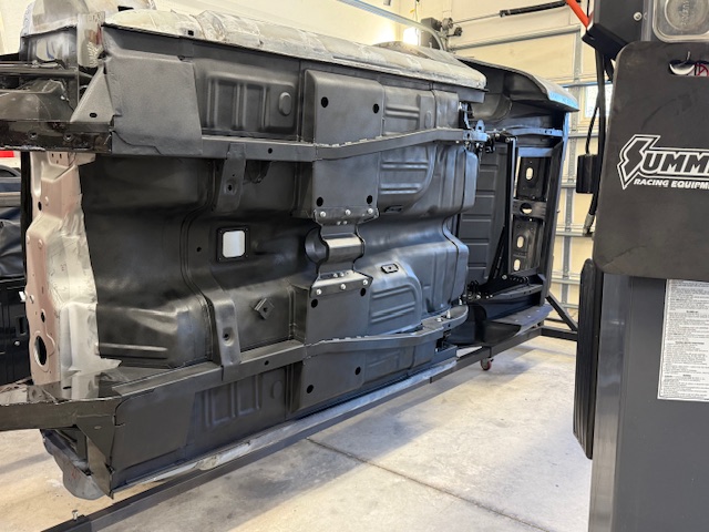

Notice the reinforcement plate used here with recess areas for the exhaust to fit beneath the plate. Might be just what you need!
That reinforcement plate is interesting, and appears quite robust. Maybe @Axshun can tell us more about it.
The cross member is a Cougar/Mustang convertible specific part from TinMan Fabrication. It’s a really nice, well built part as it is a direct bolt in place of the original plate and has a driveshaft loop and space for up to 3 inch exhaust. Not cheap by any means, but I think it was worth the cost.
Here is the link:
Ford Mustang Convertible Crossover Drive Shaft Loop 1965-1972 – Tin Man Fabrication
The convertibles have a plate that bolts there from the factory except the it is flat. The stock one is pretty decent. I think this one is more about getting a little more exhaust pipe clearance and driveshaft loop.

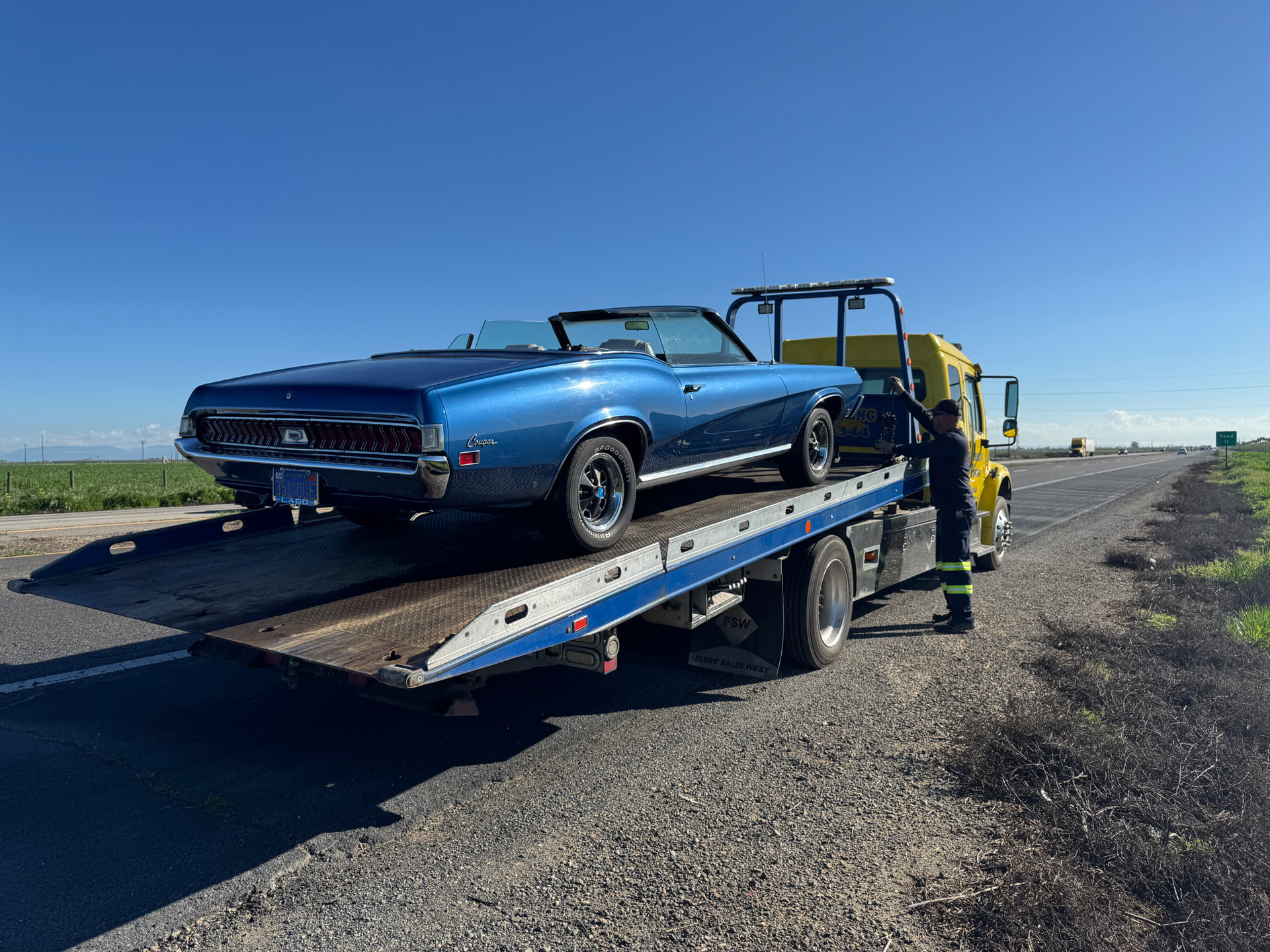

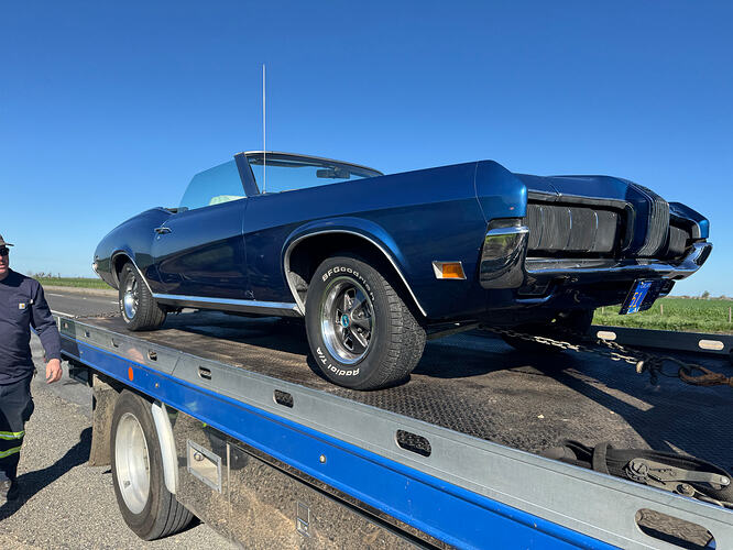

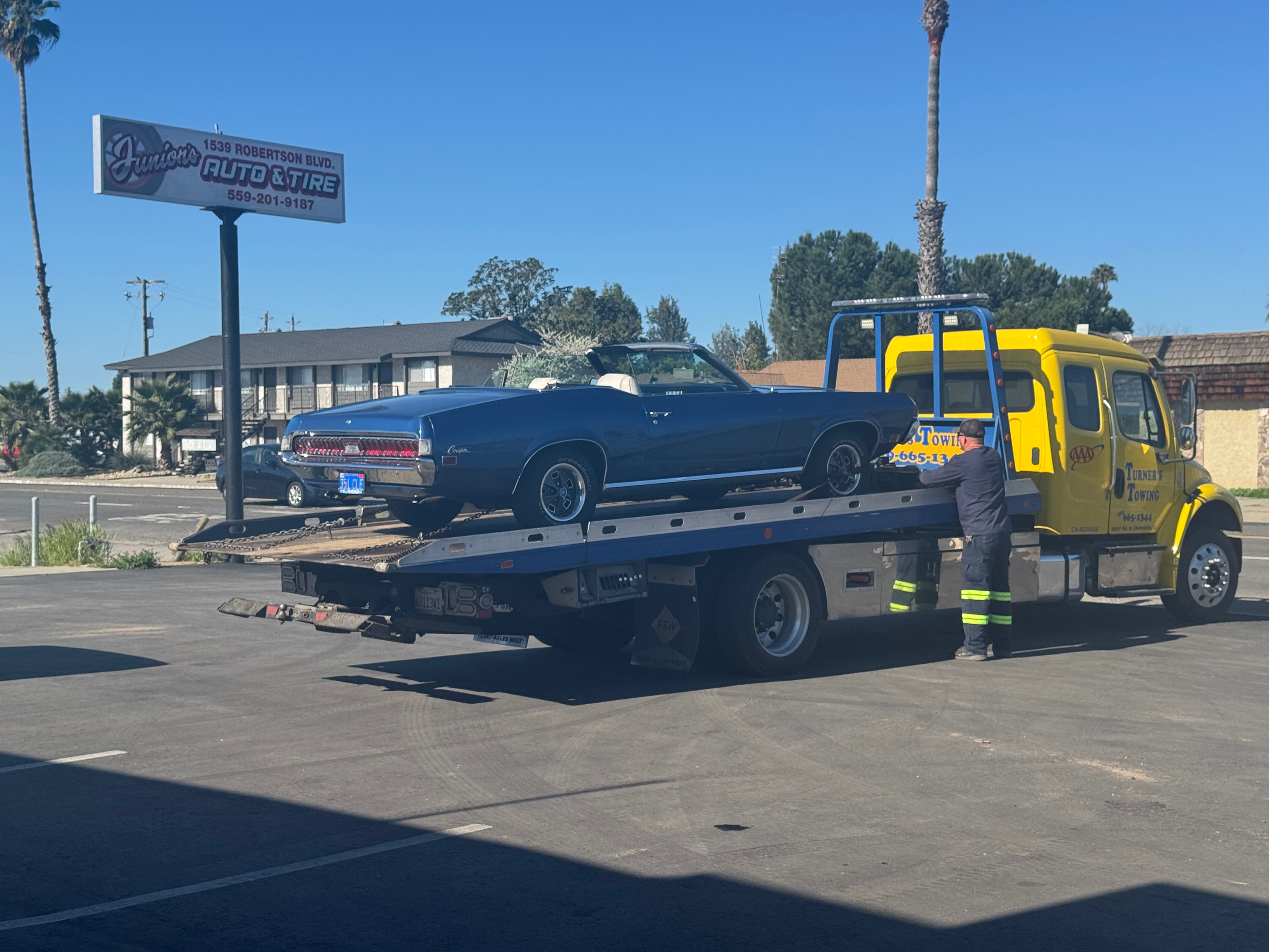

More to the story, though. Over the weekend i noticed the performance was off. Wouldn’t start right up, and was chugging a bit on acceleration. I took it on my 167 mile Monday morning drive from the South Bay to Fresno. It was driving okay, but on a lonely stretch of Hwy 152 the engine conked out. Had to get it towed to the nearest small town of Chowchilla. There it’s been at a repair shop. Found out today what the problem was. It has to do with the Holley Sniper system’s incompatibility with what’s on the car.
