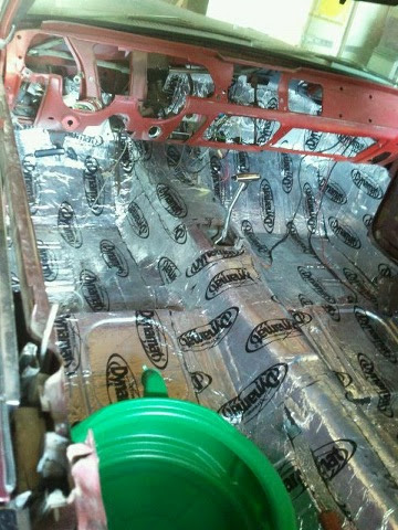

Has anyone used this before? I have applied a coat over the entire floor pan and fire wall. I wish the restorer would have suggested doing the fire wall before we installed AC unit, gas pedal, brake clutch assembly etc. It was a pain applying small pieces on my back and locating areas that were missed. I am concerned about it stoping the heat and have enough to apply a second coat at least along the front floor pan.
I used a similar product.
That stuff is just butyl and aluminum. The butyl reduces vibrations and the aluminum reflects radiation. For the firewall, you also want something to limit heat conduction. A second layer of butyl and aluminum is not ideal. You need some sort of closed cell foam.
Thanks Adam. What are you going to use?
I bought a Dynapad to use on my firewall. It needs to be trimmed, of course, but it is the perfect width. Under the Dynamat, I have two layers of POR-15 mixed with some Hy-tech ThermaCels. The ceramic beads float to the top, which gave the POR-15 a texture like 320 grit sand paper (not that I see it since it anyway). Since my Cougar is still under construction, I can’t tell you how well it all works yet. As for under carpet insulation, I have not figured that out yet. I’m hoping what I have is good enough. I may upgrade to mass backed carpet or Dynaliner, but that won’t be for a while.
Adam, thanks for the education and the link. I just ordered my dynapad. I have a mat backed carpet ready to install so I hope that the dynapad will be sufficient. When will the spending stop? SalD Cougar Geek.

OK, on to cars… I used a butyl/foil adhesive on my firewall, then glued a foil backed carpet underlayment/insulation over that. It seems to have made a huge improvement.
This is the carpet underlayment. http://www.jcwhitney.com/heat/sound-insulation/p2010475.jcwx?filterid=c2663u0j1
