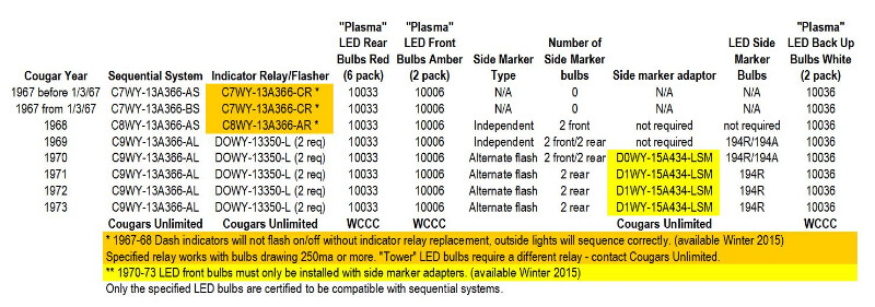

They are plug-and-play for 1967-68, but for 69-73 you’ll need to change over to the solid state flasher unit, as well as [probably] the solid state sequential unit. We’re still gathering information on what’s needed. Feel free to chime in, those of you who are electrically inclined.

I have a 71 convertible and put the Led’s in the rear, you have to change the sequential unit in the trunk as well. Prior to installing them I checked amp draw with marker lights on and drew 6.2 amps with brake lights I drew 11.2 amps. Changed to the Led bulb and drew 4.9 amps on marker lights and 6.1 amps with brake lights. That’s just over a 5 amp difference! I could not test turn signal draw as the Led’s will not fire the turn signal flasher can and we are out of stock on the new solid state one. With the original can in it did turn on the inside light and the outboard marker light so I drove it home from Salem to Gresham (about 50 miles) some interstate and some two lane country road. These lights are very bright, and I could see the road signs behind me for oncoming traffic clearly with just the marker lights and when I stepped on the brake it lit them up for 75-100 yards behind me. They are also clearly bright during the daylight hours also.
