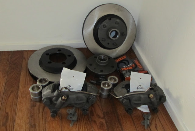

My disc brake project took a leap forward today.
Here’s what I have so far:
1967 Cougar Hubs - eBay - $75/pr
1971 Cougar Spindles - eBay - $75/pr
1971 Cougar Inner Wheel Bearings - PartsGeek - $13.70/pr
1971 Cougar Outer Wheel Bearings - PartsGeek - $11.70/pr
1971 Cougar Wheel Seals - PartsGeek - $3.70/pr
1967 Thunderbird Calipers - PickNPull - $24/pr
1967 Thunderbird 11.73"X1.25" Brake Rotors - PartsGeek - $119.70/pr
1967 Thunderbird Caliper Repair Kits - PartsGeek - $19.70/pr
Total: $342.50 including shipping
I still need a master cylinder, tie rod ends, brake hoses, proportioning valve, and brake pads. I also have to get a pair of caliper brackets from Mike at MAECO Motorsport and slightly modify the calipers.
Adam glad to see things are going good for your project. I have to say you have the nicest floors I have ever seen in a garage. :poke:
Thanks Steven. :beerchug: Yep, I’ve got lots of parts piled in my office. That corner I try to keep clear for pictures.
