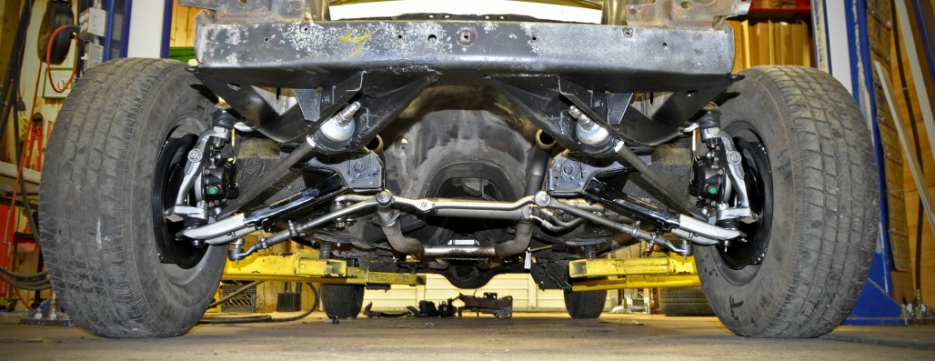

So, before I started putting the brakes on, I needed something to attach them to. That meant it was time for new upper and lower control arms, spring perches, springs, rubber isolators, and shocks. The springs are the 1" lower Scott Drake “performance” ones, and are a little thicker steel than the originals. Hopefully they aren’t too harsh. The shocks are pretty ordinary KYB’s, basically a stock replacement (looks like I need to update the pic for the website, it shows a gray one, but they are black now). Oh, and don’t forget to do the 90 degree grease fitting adapters on the upper control arms if you ever want to grease your suspension.
This weekend I got the driver’s side brake put together. I exchanged my core calipers for rebuilt ones and got the semi-metallic pads. Did this side first to figure out how to do it, then I’ll do the other side in the video
Somehow, I think what took the longest was installing the little rubber insulators. The bolts kept wanting to push them out the other side. Kind of annoying, but I got 'em eventually.
(I know, I still need to install the cotter pins)
Stuff is looking gooooood! One thing I realized is that I’m finally at the point where I’m putting stuff ON the car instead of just taking things off! It’s a big turning point… Also in the works, I’ve been cleaning up / painting the steering linkage stuff, struts rods, etc so they look presentable as well. Had to get a new idler arm too because mine was a little wobbly. Anyway, hopefully this week I’ll finish up the other side, and on a slightly unrelated note the vinyl top might get done this week too. Then I’ll try to throw the front and rear glass in, with some help of course. Then there’s no reason not to hang the doors, and paint the engine compartment, and start on the interior, and… you get the idea.

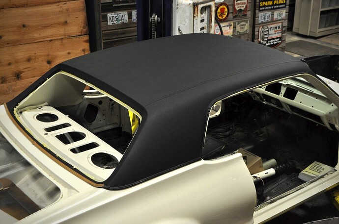

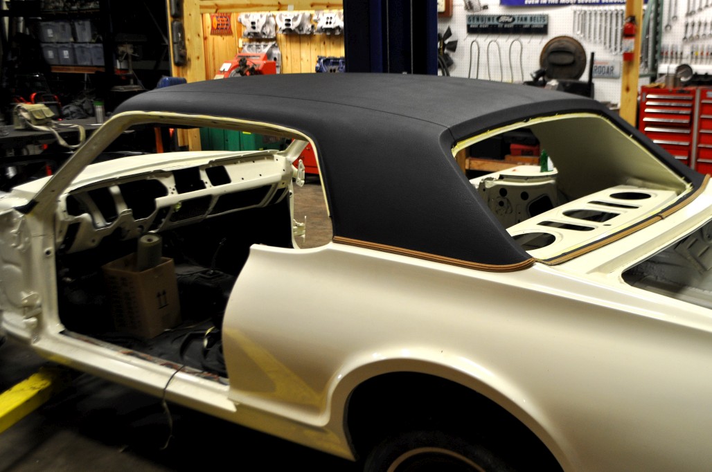

Big news of the day… new vinyl top is on!
Very happy with how this came out. The only little thing that isn’t perfect is the RH stitch line, which is a teeny bit crooked. But otherwise it looks awesome. Good tight fit and everything. Oh, and ignore the saddle-colored trim pieces. I grabbed those from the shelf because I couldn’t find my original ones.
Needed to paint mine anyway, so if they don’t turn up I’ll just blast & paint these ones.
Installed by the same guy who did my headliner, and the convertible top in our most recent video.
This is the top of the line, OEM material from SMS Auto Fabrics (link). They are slow to produce (mine took about 3 months) and expensive. But in my opinion, if you intend on keeping your car for a long time and you care what it looks like, or if you’re doing a concours resto, it’s definitely worth it. The quality of this material is just so much better than the typical one we sell, not to mention it’s almost exactly the same as the originals. I’ll talk a little more about the differences down below.

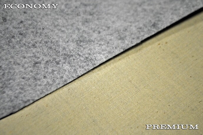

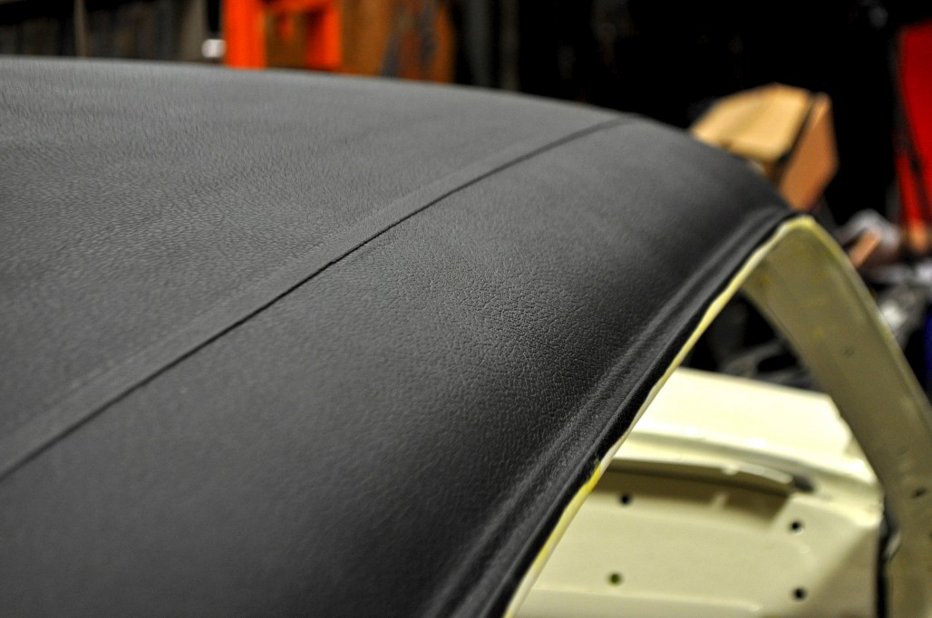

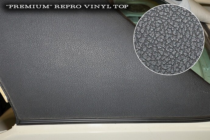

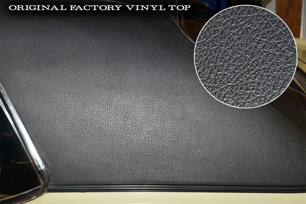

Anyway, a little more about the vinyl top. I took a couple of comparison shots with the “average” reproduction that we sell (top in pics) and the “concours” version (bottom in pics) that I put on my car.
Texture comparison:
A couple things I noticed about the “average” one - the texture is a little bit rougher, and it has a shiny finish, which I don’t really like. Also, when you pull on it, you can actually stretch it a little, whereas the “concours” one is very taut and won’t stretch with your bare hands. The texture on mine looks more natural and precise and it has a more matte finish, which looks better IMO. Another thing about the “average” one that you can’t see here is that there is a fairly noticeable repeating pattern that you can see when it’s installed on the car. The “concours” one probably repeats the pattern too, but if so I haven’t been able to tell. Here’s the back:
If you’ve ever pulled an original vinyl top off a Cougar, then you will have seen a canvas-like backing material that looks like the bottom one in this pic (concours one of course). The “average” one has soft white fluffy stuff on the back that doesn’t seem like it would do much to stop moisture. I guess the good thing about it is that it would provide a little more padding to hide imperfections on your roof’s sheet metal. But the overall feel is just cheaper.
So, just to be clear, I’m not trying to put down anyone who has put the average top on their car. In fact, it’s been the only new vinyl top option that most people knew about for a long time (my car had that kind of top on it before). It does the job and looks good (see pics on the listing on our site of the Tiffany Blue '68). However, seeing it next to the OEM material, and seeing the proper one installed on my car… it makes a huge difference in the quality of the car’s appearance, in my book.
Here are more comparison shots of texture. An original vinyl top, the economy version, and this premium version that I used.
When the installation was all finished, I had to step back and absorb it for a while. It really looks great in person. That, and it’s starting to become recognizable as the car I want it to be.

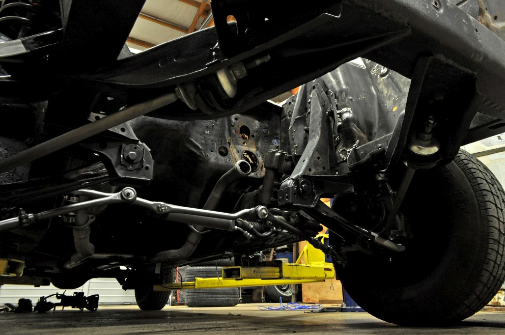

Also, while I’m here, the front end progress is very good - I cleaned up and painted the drag link and tie rods (had to replace one of the inner tie rods) and put them in the car, with a new idler arm, rebuilt power steering ram cylinder (mine had a bent shaft and a dented cylinder), and hooked it up to a rebuilt steering box (mine was shot). Strut rods also cleaned up / painted and installed with new bushings. Brakes are essentially done on both sides except for the lines. A few things still need buttoning up / torquing / cotter pins / etc. Here’s a couple quick pics, sorry they are on the ground and you can’t really see a whole lot.
The Snowball rolls on!
