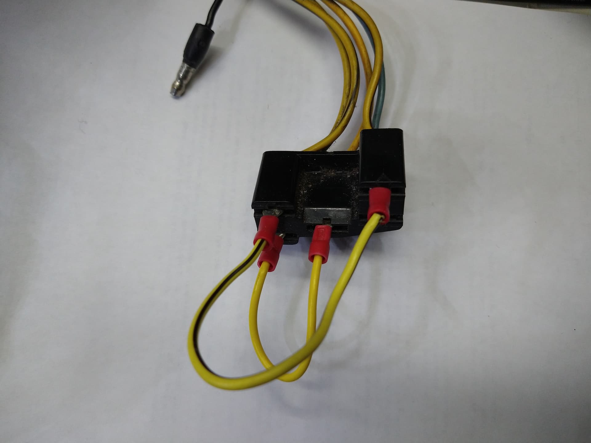

the system is operating in emergency flasher mode where the outer and inner light is blocked by the emergency flasher relay (K10). Either the relay is bad (typically a broken internal ground wire) or has no power on the light blue wire. Test it by removing it and replacing it with two jumpers made from 3" of 18ga wire and 1/4" quick disconnect male crimp connectors.
Connect yellow to yellow and yellow/black to yellow/black. Then test the input wires at the K8/K9 combo relay.
If the flashing yellow, yellow/red, and yellow/black signals do not appear at the relay outputs (the rear lights), then either the riveted wire connections or the internal relay contacts may be oxidized.

Tested the Emergency Relay bi pass based on your above advice to create the jumpers. I was able to determine flashing lights at each of the respective 3 inputs to the K8/K9 as well as the main power on the Violet & White. So I am assuming that something is wrong then with the Emergency Relay?
I do have another one I got with my second Motor/Sequencer & K8/K9 set and am going to put that on to retest with it plugged in to see if I get different results.
As long as there is 12V on the light blue wire, the K10 relay coil has failed (burned out winding or broken ground to case) or the relay contacts are oxidized. Typical OEM K10 coil winding measures around 65 ohms. When energized, the relay contact (yellow-yellow or yellow/black-yellow/black) resistance should be less than .1 ohms.
