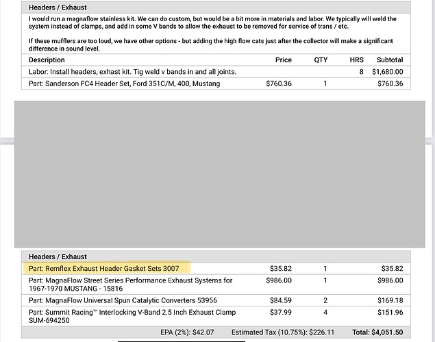

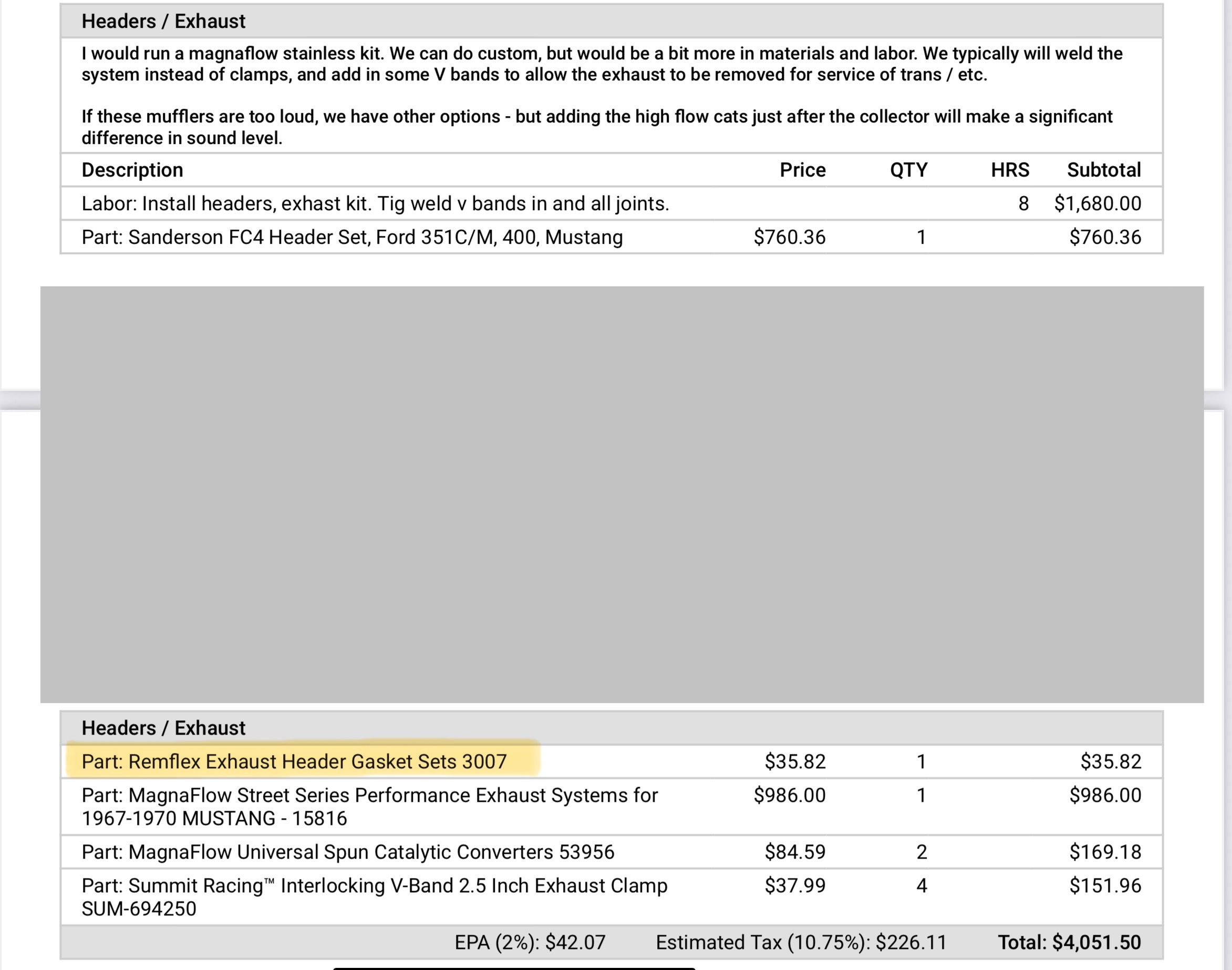

Remflex gaskets seem to work better than anything else we have tried.
Nothing in the current Borla line-up matches what I have. Probably closest is the Universal series. I bought a complete Mustang exhaust system from them and had it modified to fit my car.
Checks out; Remflex gaskets on the estimate.

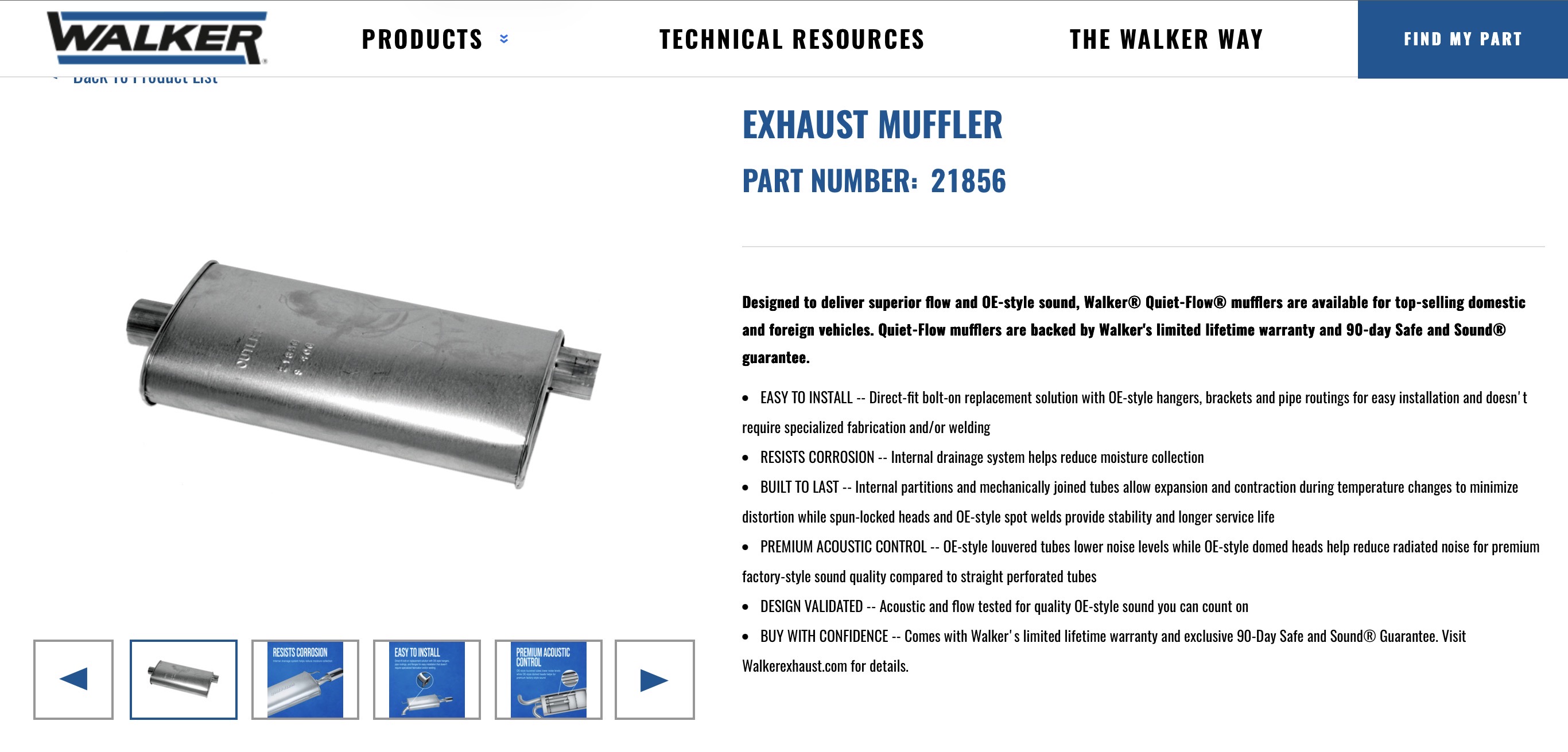

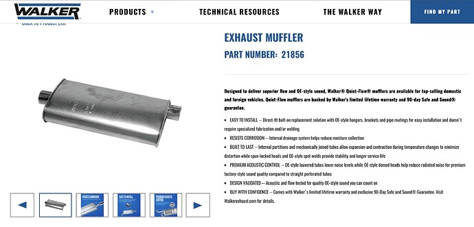

The shop will start work on the exhaust tomorrow. The mufflers are determined to be Walker Quiet-Flows. Sounds like the neighbors aren’t gonna know my Cougar’s comings and goings.

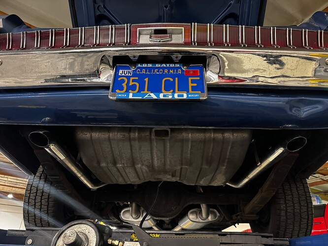

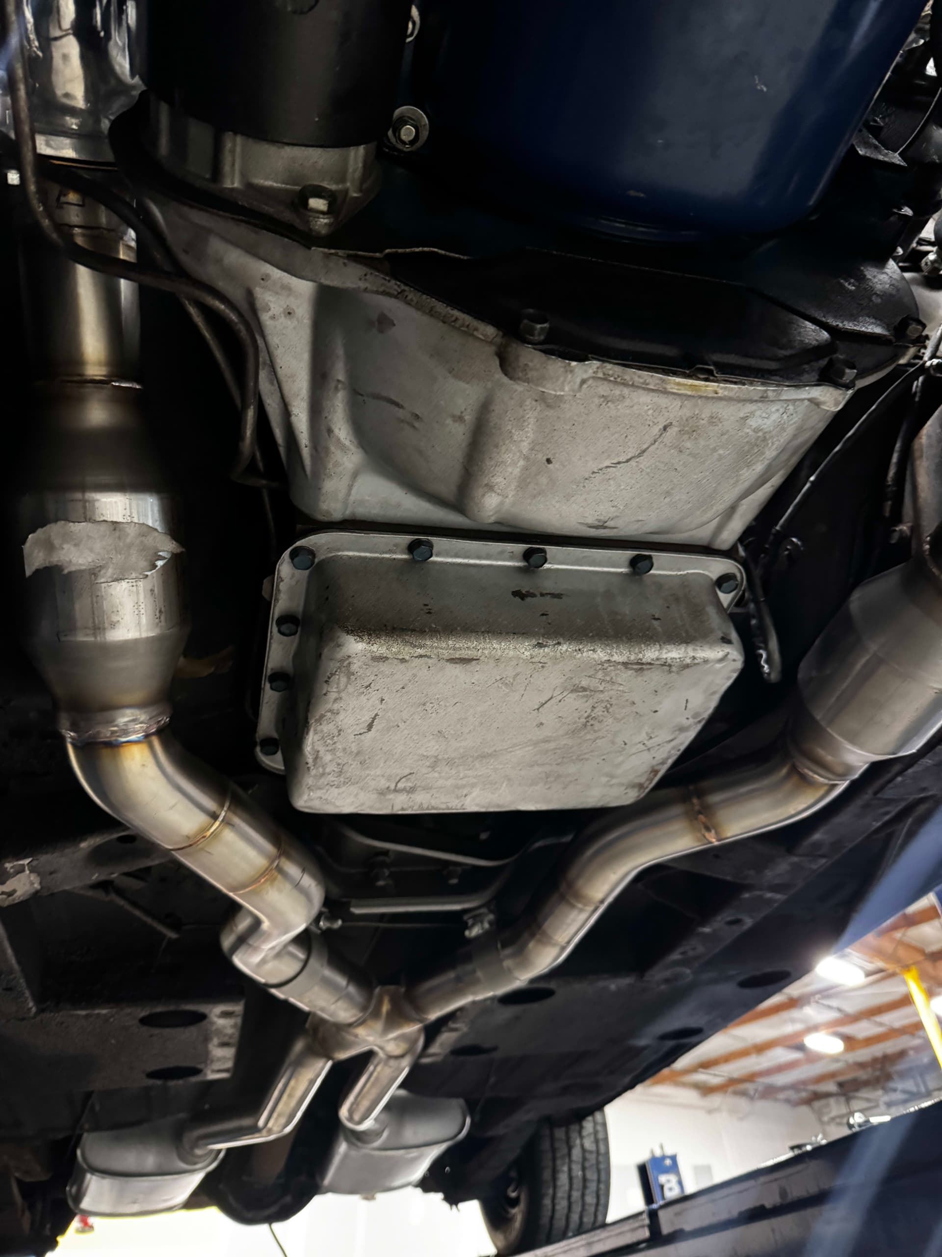

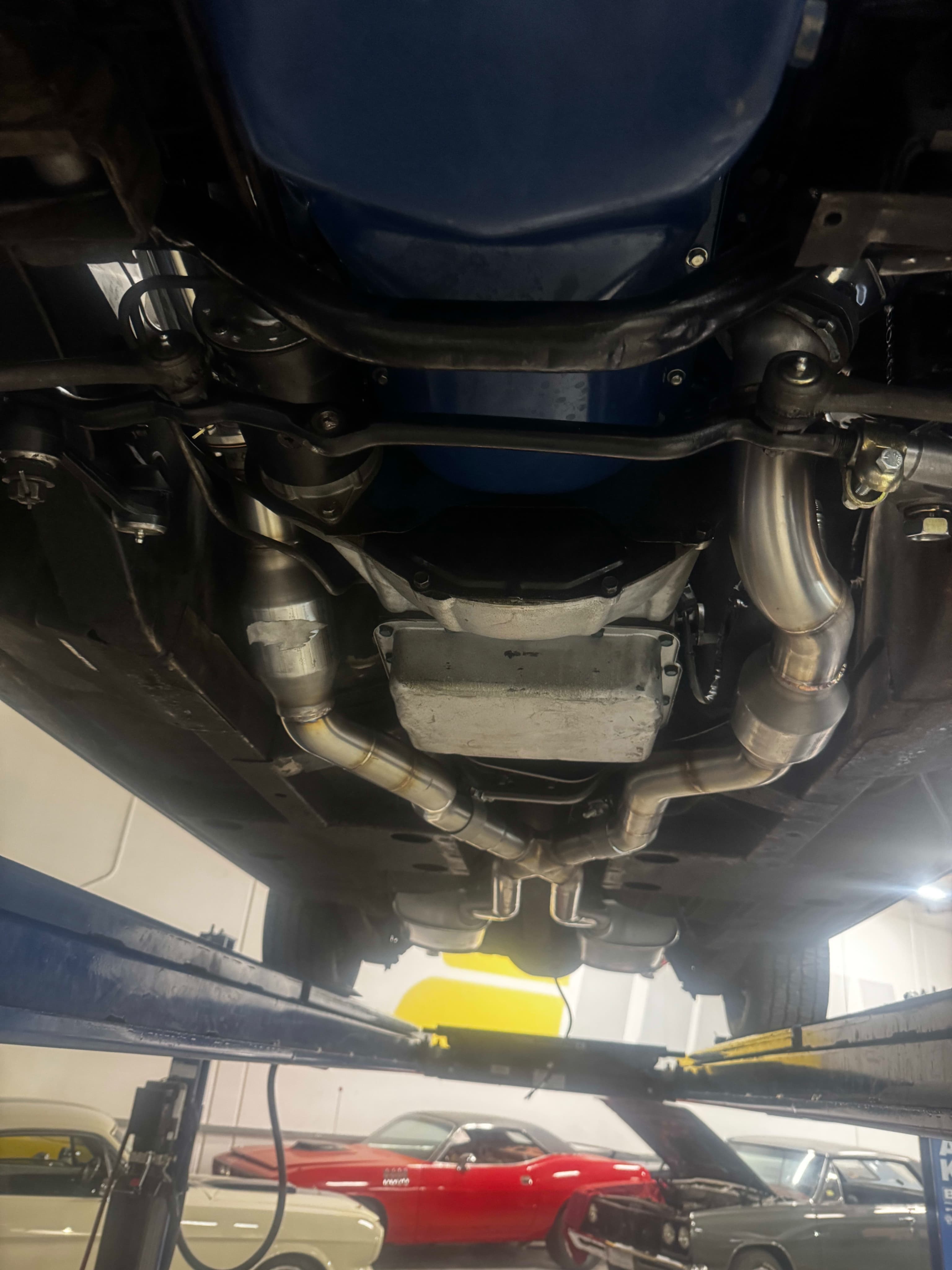

Seen are the exhaust with the cats. (The driver side cat has a torn shipping label). The cats seem to me to be clear of anything that’d be affected by their heat. It’s Sanderson Shorty headers, Magna-Flow exhaust and Walker Exhaust Quiet-Flow 3 Mufflers. Will be interesting to hear the sound and get an exhaust check, I guess a BAR-97 pre-test with numbers, not a certificate, and compare this to what would be expected for a 1970 carbureted car. If it’s significantly cleaner than stock, I’ll be satisfied that it’s an improvement.
look like it might hang a little low most exhaust are above the plate that’s currently missing off your car. Very nice welds for sure.

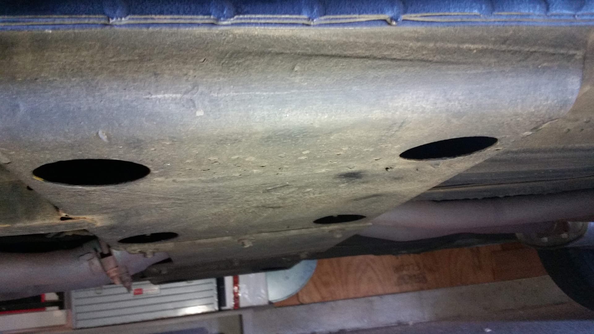

Agree it is low. Here is a picture showing how the factory exhaust tucks up under the floor stiffener plate. Convertibles need that plate in place for floor strength without a rigid roof.

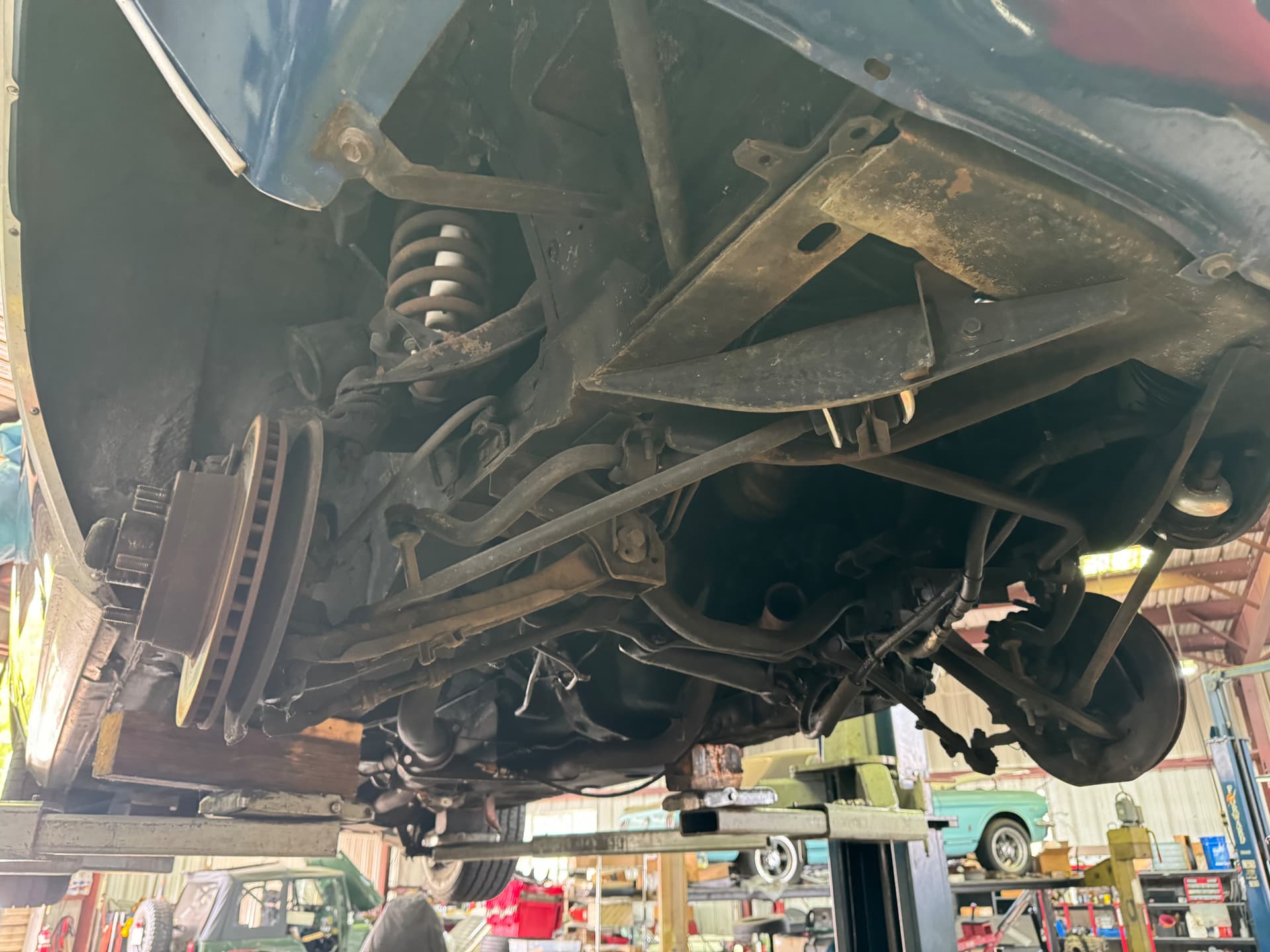

Well this is interesting. Here’s a pic of from February 2025, as the Cougar was nearing end of its four year stay at the shop. Is it missing its floor stiffener plate?

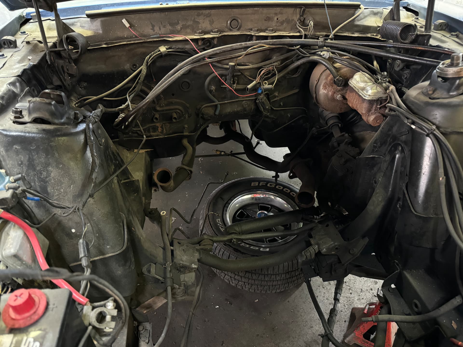

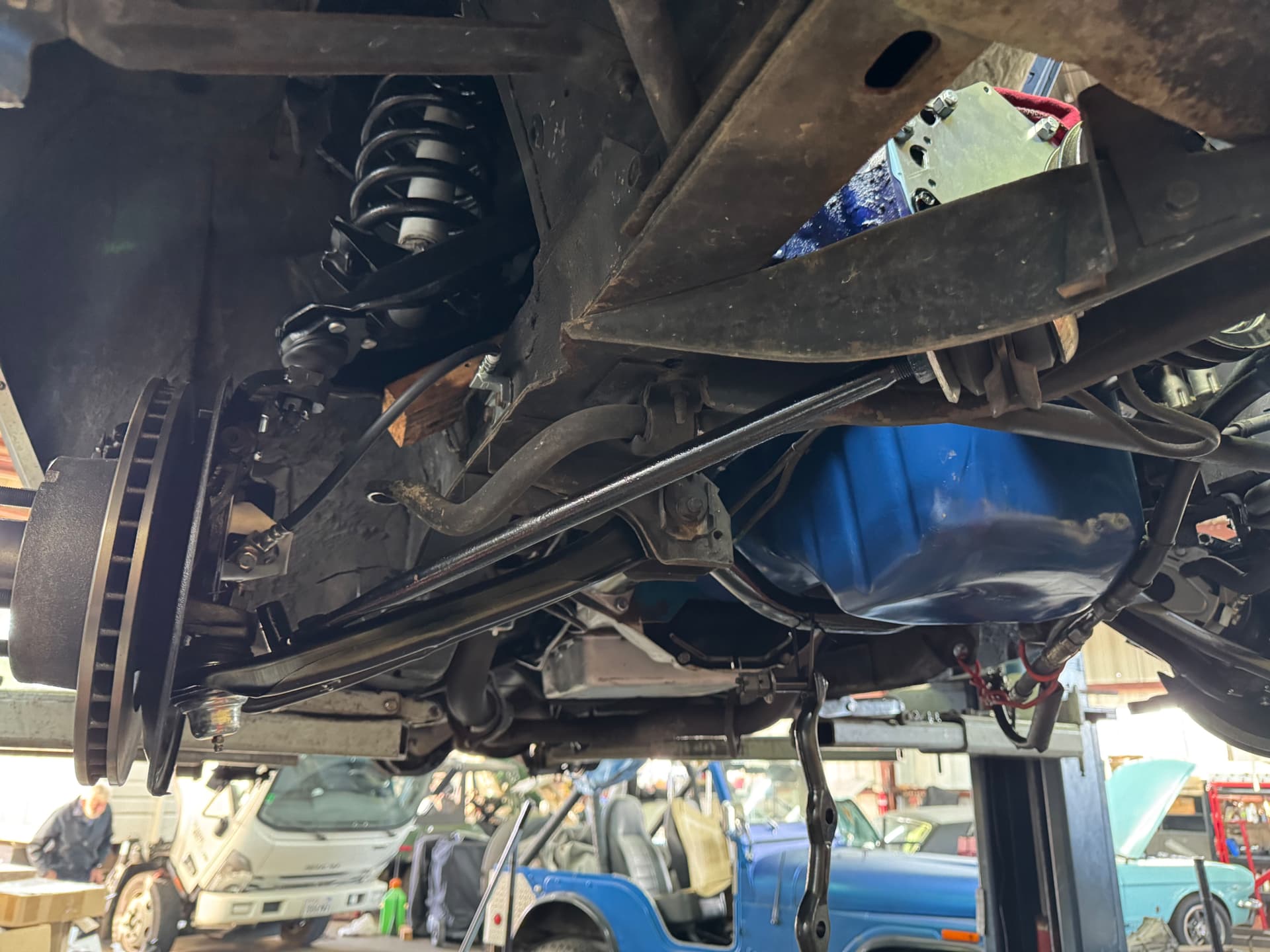

Here’s a pic from 2024 with the engine and transmission out. Should the plate be visible?
I don’t ever recall seeing a floor stiffener plate while it was at the shop. Did they remove the plate in 2021 and forget about it? There were a lot of parts lying around that shop.
Ugh, that sure might explain it. There are two plates that are welded to the floor pan right under the front seats (with holes that access the seat attaching nuts) and then a bolt-in segment that spans the transmission tunnel between these. The bolt-in segment is missing on yours, but I can’t tell if it was there in your pics.
It appears stifners are there but its missing the cross over plate…picture looki up and to the rear. Right where the x pipe is
Definitely missing on the current pic with new exhaust, but can’t tell if it was there in the pics at the old shop? You can tell it hasn’t been off for very long by the exposed metal at the mounting locations.
I would say its was installed when this picture was taken as the exhaust is not hanging to low and it was probably sitting on the plate at the time.
Hard to tell because the factory exhaust was suspended above the plate and did not rest on it. Oh, but with the engine out, it might. Good catch!
Been over lots of pics from the four years my poor Cougar languished at that shop, but no real good ones of that section. This one I think shows it best.
I think that the plate was there, was removed to install the exhaust, and pics were taken without the plate to better show off the exhaust work before the plate was reinstalled.
Looks to me like your new exhaust is going to have to hang below the plate. If so, that’s going to cause ground clearance problems. My plates barely clear our driveway crown at the street with 2 people in the car.
