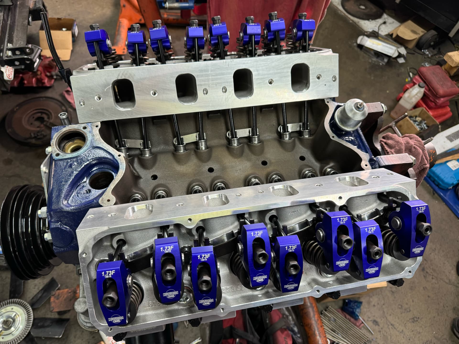

It turns out I’ve got new content. On another thread I posted a pre-completion pic of my 351 Cleveland valvetrain and @EliminatorClone informed me that the tie bars were oriented on the wrong side. This is the shop where my Cougar languished for four years.
I contacted the manufacturer, Schneider Cams (Schneider Racing Cams: Performance Proven Cams & Components), who confirmed the tie bars were supposed to be on the valley side, but that if it was a problem it would have already manifested, and that it’d probably be okay. I asked if it’d affect the warranty.
Warranty is void if parts are installed wrong.
I would flip them
In a few thousand miles there’s been no noticeable problem. Now it’s at the new shop, getting worked on as per this thread’s topic.
I’ll have to take the Cougar back to the old shop and see what they want to do. Even though the manufacture won’t warranty the valvetrain, I sort of doubt they’ll cheerfully volunteer to flip the tie bars. I’m apprehensive that in the work, they’d end up making it worse, somehow. I imagine the work could be done competently by the shop it’s at now, but that’d be 6 hours of labor that neither I nor the old shop would want to pay for.
Are any of these good options? Any other options out there?

I wouldn’t take the car back to a shop that held me hostage for 4 years under any circumstances. My question would be 1. What is the cam builders warranty? 2. How much have you run car with lifters run with tie bars reversed? IMO most aftermarket warranties don’t amount to much and mfg comment on warranty might be more of a CYA than an issue with tie bar position. If car has been run several thousand miles, I’d get more opinions but likely leave it alone. Keeping lifters on same cam lobes to me would be important. I’d also finish your project with new shop and be satisfied before I looked for them to do additional work.

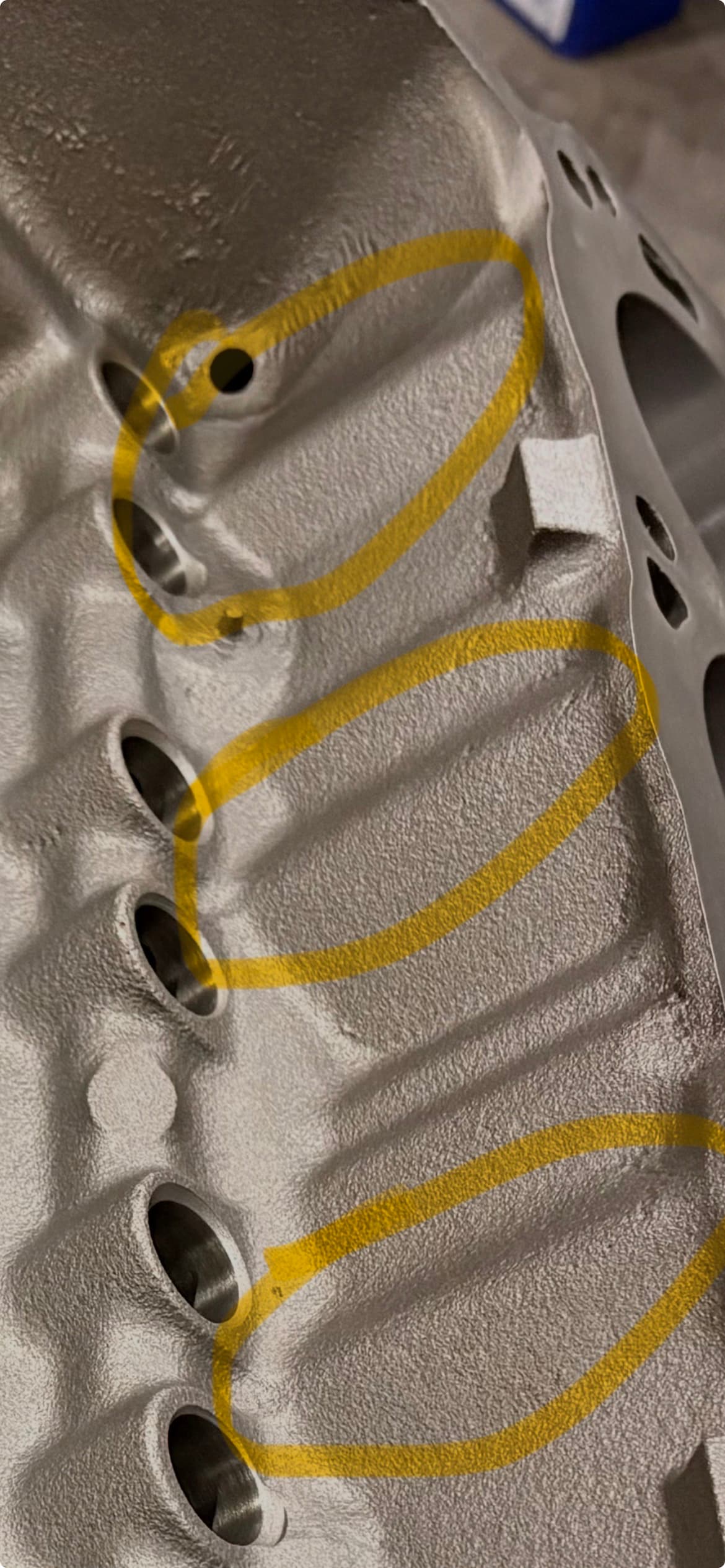

I know tie bars being reversed is a problem in small blocks because the coolant jacket webbing bulges in between lifters. The Cleveland doesn’t look that way, so I’m not sure I’d worry about it. My deciding factor would be cutting an oil filter apart and checking for magnetic debris. If you have debris, take it apart. No debris, back to ignorant bliss. I thought the project still had the intake off, sorry to cause the alarm, but i have a curse for noticing details. This photo is why you have to pay attention to reversal on a small block. On a Dart block, like my Eliminator clone, the lifters don’t even fit reversed
Cleveland guys correct me if I am wrong. I haven’t worked on a Cleveland since I sold the Pantera.
I recall that the Cleveland has a dry intake meaning your don’t have to drain the radiator to pull the intake. If that is correct then this is really a pretty pleasant job. I would definitely pull the intake and see if there is contact.
Bill, your memory is correct. The Cleveland has a dry intake that is not that difficult to remove compared to a Windsor.
I asked the shop where it’s at now.
As long as they don’t touch anything on the back wall, there is no issue… they can be installed either way.
If there was an issue with them touching the back wall, we would hear it.
I’d leave it alone.
I think that’s a sensible answer. I could see where some shops might exaggerate the risk for CYA and to upsell more hours. This advice gives me confidence in the do-nothing strategy.
if it hasn’t caused an issue yet….dont worry about it. along as it doesn’t touch the side, it doesn’t matter.
At this point, I think you would have had some problems
Not sure I would call it pleasant, but yes, its alot easier job on the Cleveland without the coolant! Not removing it is even easier - lol!
At a bear minimum I would use an engine stethoscope to give it a listen. That is really deep in lifter valley and the noise would be very muffled. It is not striking anything so it would not be percussive. It would be rubbing diagonally so sort of a scraping sound and essentially rubbing against the block
Easier if the manifold is aftermarket aluminum (or rare OEM aluminum) instead of the cast iron stock intake.
Forgive me for being ignorant, are the tie bars you’re referring to the silver plates on the push rods? Should they be facing towards the inside of the block?
